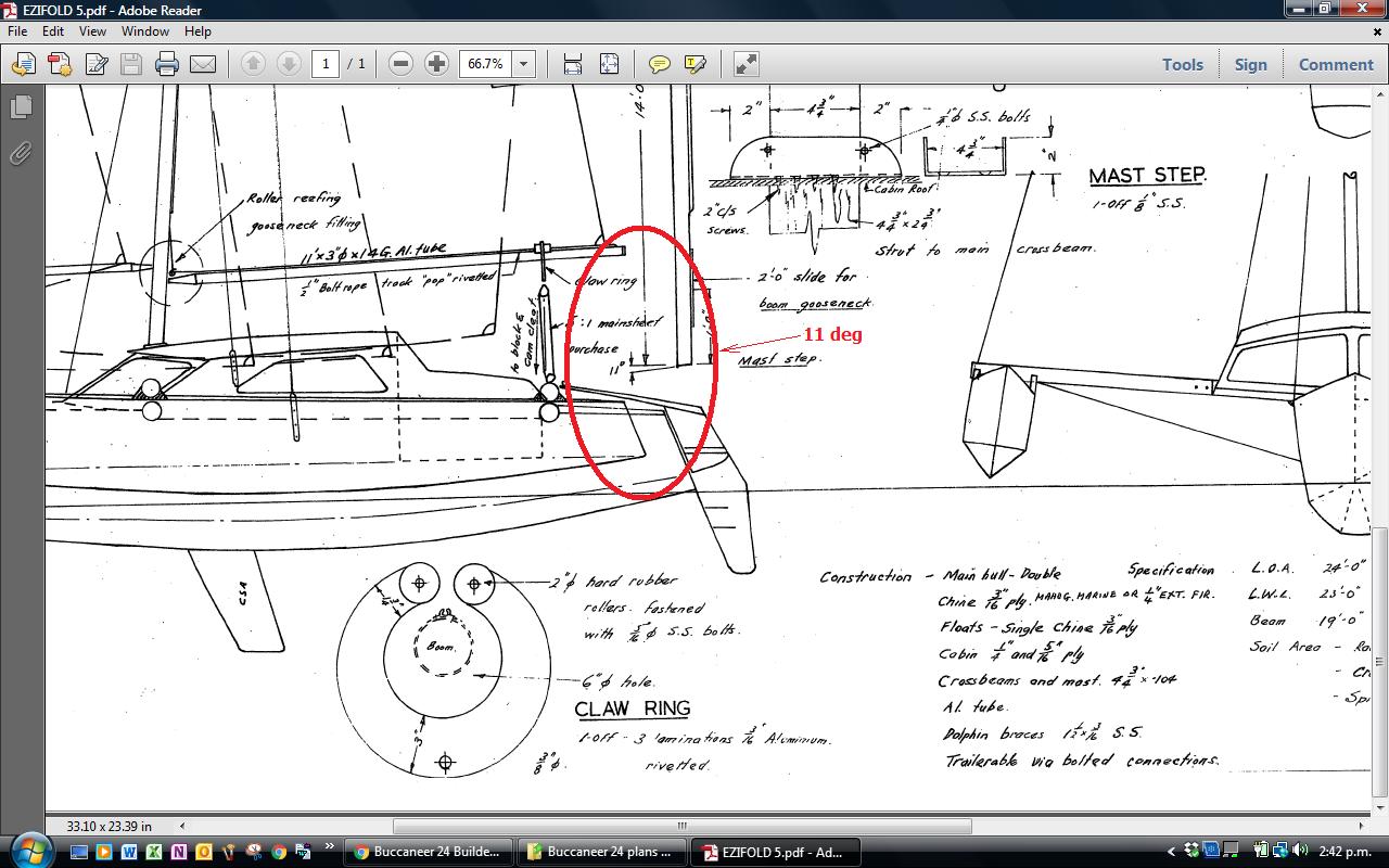

    OK, my mast does set flat on the base of the bracket. The top of the mast is supposed to be set back two feet according to plans. Does anyone know the math to use to determine the angle the base needs to be?

    How long is your mast?

    The mast is 32 ft. I think it needs to be mounted 3.5 degrees from horizontal, if my math is correct.

    Yup, that's about it (I got 3.6 actually from arcsine(2/32) ;) )
    If you're going to make a wedge to go under the mast base, consider making it so that you can swap out the wedge easily if you need to change the mast rake.

    Is the information in the attached red circle any use to you for your setup?

    Can't tell from OTB's post if he means he thinks that that 11 degrees is the mast rake in degrees or not.
    FWIW, if that 11 degree number was correct for the mast rake, it implies the masthead being raked 6.1 feet aft of the base. Not at all what Crowther states explicitly as the mast rake.
    Sheet 6 of my plans set clearly shows the 2 ft mast rake dimension that you mentioned originally.
    To me... the 11 degrees number looks like the angle to the coach roof, which is clearly pitched down in the location of the mast base -- so that is NOT the mast rake number.

    I believe that takes into account the roof rake.

    I would think that includes the cabin top angle as well as mast rake.

    As built is not always precisely as drawn -- well at least for this boatbuilder ;) -- so innn many cases that needs to be confirmed.
    I'd at least throw a level /protractor on the cabin top to insure that the cabin you have is exactly the same rake as the cabin in the plans.
    Since you're looking for 3.5 degrees upward tilt (at the front) for the mast base then the cabin roof at the mast step needs to show 7.5 degrees below level. Of course that's assuming you've got the boat dead level on it's lines, as it sits.

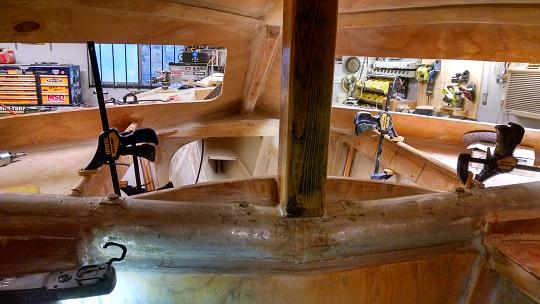

    Little bit of progress this weekend. Mast support. mast step, trunk sides installed.

    Fred, you are doing great!
    Nice looking cabin.
    I have had some issues with my dagger trunk seeping, once you have it "finished", put an extra coat of epoxy or two on the inside. Of course, you don't want so much build up that the board would stick, but extra epoxy in the corners will help keep it sealed in the future.
