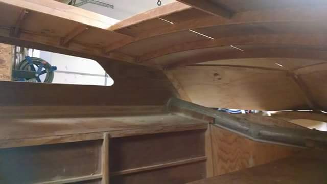

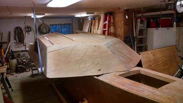

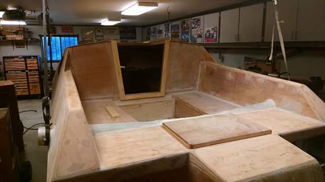

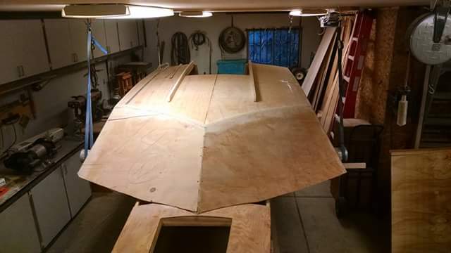

    Some update photos.

    Wow. looks like you are moving right along with your build. Looks great.

  6. cavalier mk2
    Joined: Mar 2010
    Posts: 2,123
    cavalier mk2 Senior Member
    Hey, looks like a boat, keep up the good work!

    Nice
    That is almost a boat! Nice work Fred :cool:
    A detail I would include. At the center "V" of the crossbeams, water always collects, and has no way to escape except down into the wood. From experience, rot will start there. IMO, a drain hole/holes need to be added in both front and rear beams. I had to replace the "under" beams on my boat, and saw the same damage on several others.

    Yes, Bruce, I am planning ondrain holes. I thought the samecthing may happen even if the tubes are epoxy plugged due to movement while sailing. The rear will drain into the cockpit and the front into the centerboard up/down line tube.

    Is there not a risk of the centre case pumping water back up the drain ? I would have thought water in there would be minimal with the timber plugs in the tubes for demounting ? Wouldn't a removable bung be enough ?

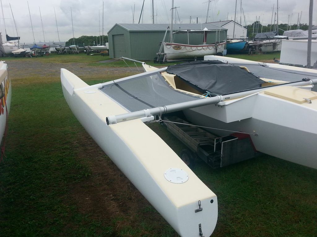

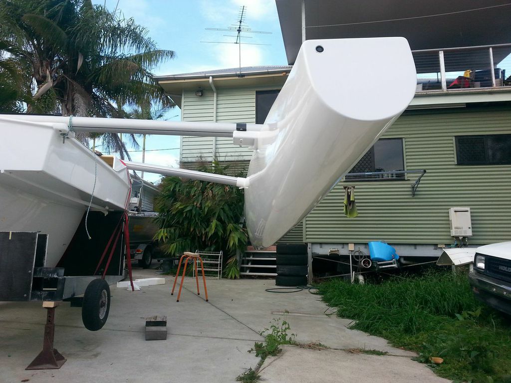

    Speaking of vents , I have 2 x 6 inch inspection ports in each hull on the deck , and in the transom up high in the corners I have put a gortex vent in each hull. They are used in sailboarder and stand up paddle boards so they don't pressurise and explode when left in a the sun. They are a one way vent which lets the pressurised air out and the gortex material will not let moisture in .
    The are installed by drilling a 25 mm hole and epoxy or sikaflex in.
    http://www.shapers.com.au/gore-tex-breather-values/

    Vents

    Ordered, and on the way to me. Thanks!

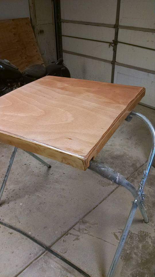

    freddyj Senior Member
    Should I make the front hatch open forward, back, or sideways? Which would be better?
  15. bruceb
    Joined: Nov 2008
    Posts: 1,226
    Location: atlanta,ga
    bruceb Senior Member
    depends :)
    Fred, most boats have the hinge at the rear, both of mine do. However, there can be reasons for hinging it forward if you have enough deck space in front for it to open all the way. I prefer hatches like the Lewmars that can open 180 degrees and lay flat on deck if there is space. If not, think about your use, if you want it for ventilation, it needs to face forward but it will also suck in rain and spray, and while open, it is very prone to catching the jib sheets while tacking. Faced aft, it can be left open some of the time. Don't open it sideways, that doesn't work very well.
