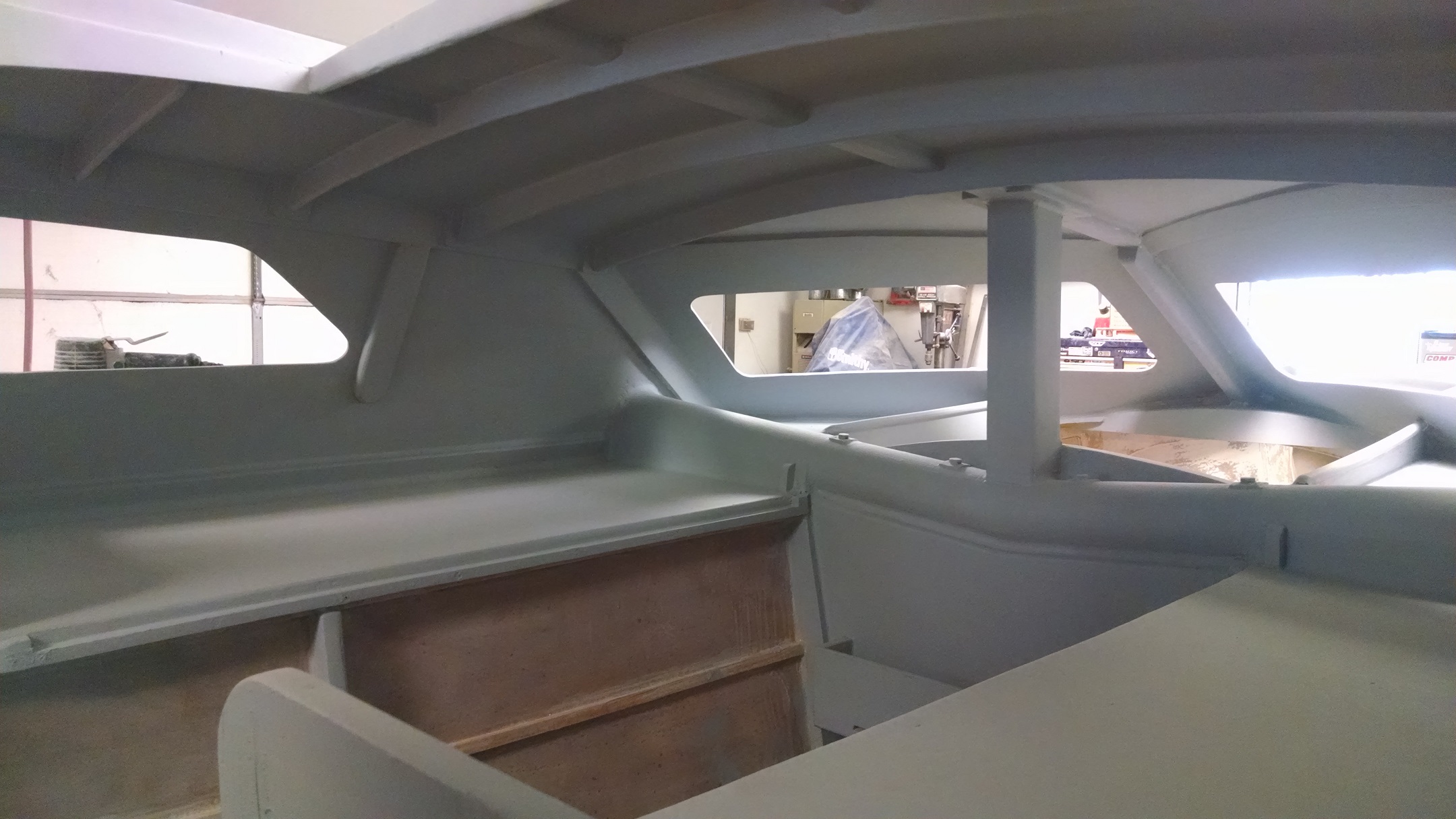

    Headroom
    Looking the goods Freddy, how much clearance from the double to the cabin top ?

    freddyj Senior Member
    Just enough!

    interior
    Fred, good progress! I also think the cross bunk is a good idea, and yours looks well done.

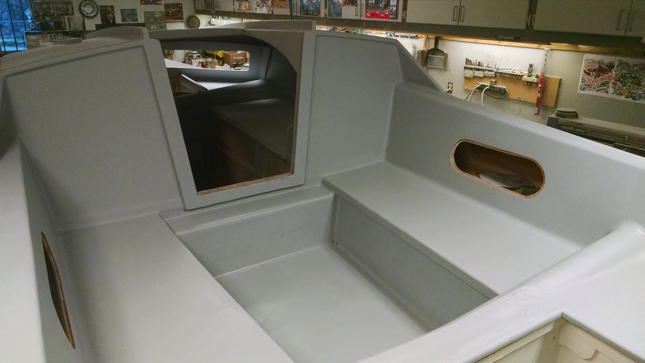

    primed the interior and cockpit.

    bruceb Senior Member
    Nice!
    Fred, that is looking great. What kind of primer/paint are you using?
