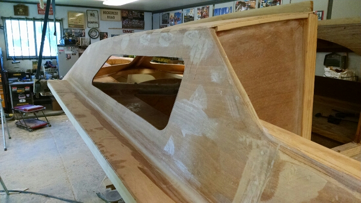

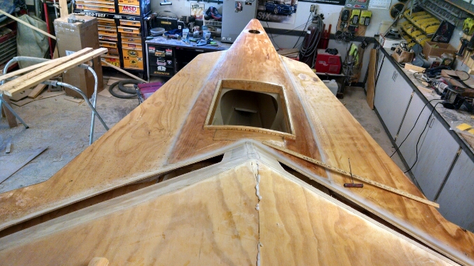

    A little progress this weekend.

    Fred, that is a nice and tight looking build, and , it is really good progress. :cool:
    OS, there may only be a couple of new ones, but your plans have helped keep several old ones going into the future. I am sure I wouldn't have my 33 if I hadn't had the 24 first, so that is one more success.
