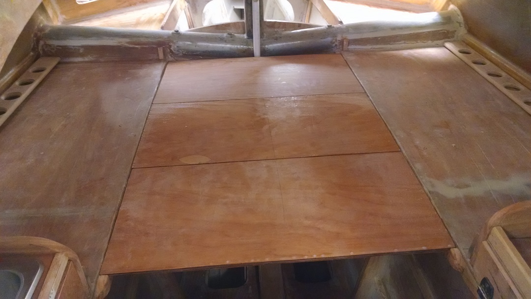

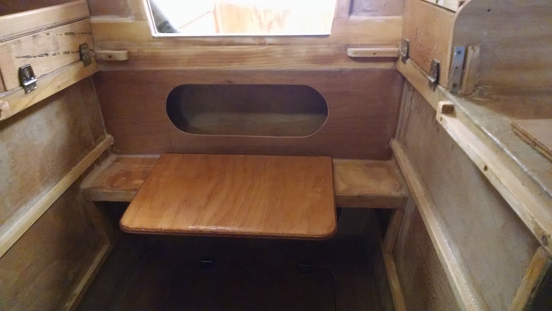

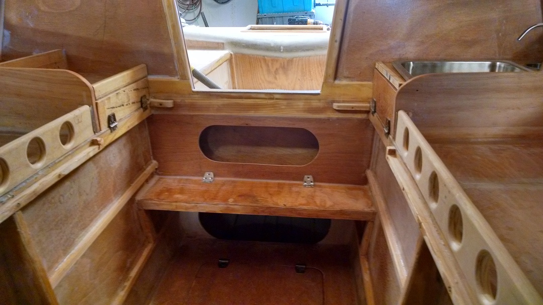

    freddyj Senior Member
    Started priming and got the kitchen area and sleeping quarters done. I've got a sideways double bunk.
