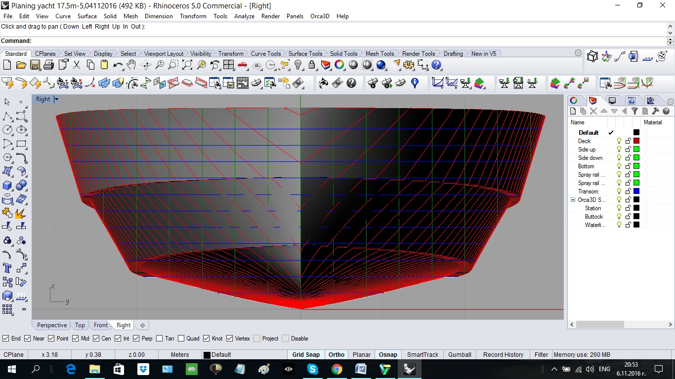

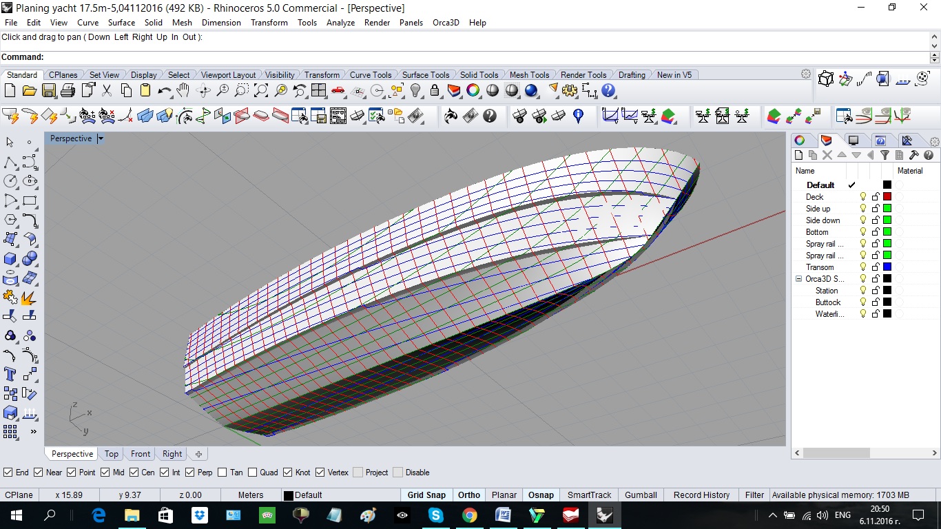

Hi Devu De Goa,
There can be this model it is pleasant to you. It was made by me with training aim. The sizes:
Loa=17,576m; Boa=5,964m, Hmax=2,46m
At-sea with draft=1,2m it is received displacement=51,848t
Calculation on Orca3D is the following:
At VCG=1,4m the hull will float in a semi displacement regime as Fnv <3
At velocity 20kt total power=2 x 900kW; Fnv=1,7; dynamic trim=7,19deg
At velocity 25kt total power=2 x 1100kW; Fnv=2,137; dynamic trim=7,42deg
That now to you is necessary to make it is to scale the model up to those sizes which are necessary to you also with approval of the professor.It will help you only provided that you yet have not accepted final award for the geometric shape of the body line of the hull! I wish you good luck.
I help because I remember my student's years. I hope that when you will be on my years, you will help too to young students.

Hi Devu De Goa,
Friend from Norway - NA Alexander Aleksanov, has given me idea to make the transom from curvilinear surface and has shown as it to make on Shape Maker saving thus outlines of all remaining surfaces. The idea was pleasant - see realization on Rhino. Except for that I was a little bit pick up the bow, so that now the sizes are the following:
Loa = 17,392m
Boa =5,964m
Depth max =2,6m
At draft = 1,2m in sea Displacement = 47,39t; LCB=6,349m; VCB=0,781; Cb=0,493; Cwp=0,808; Cx=0,702
Advisory - the vessel should be projected so that LCG=LCB=6,35m, certainly if these ship dimensions will be saved.

Im glad this is just a model and not a production boat. 51 tons for this size boat is a lead sinker . 1.2 total draft maybe acceptable but not hull draft
