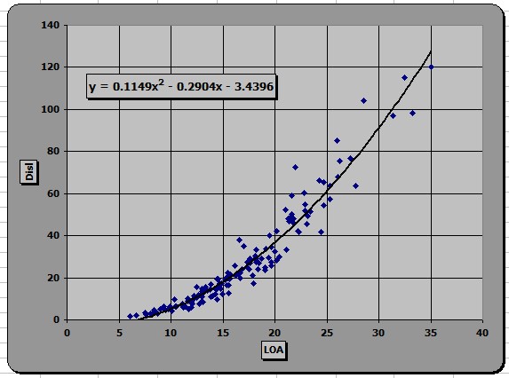

    Hi
    ...some existing data (145 motoryacht)
      File size:
      43.8 KB
      419

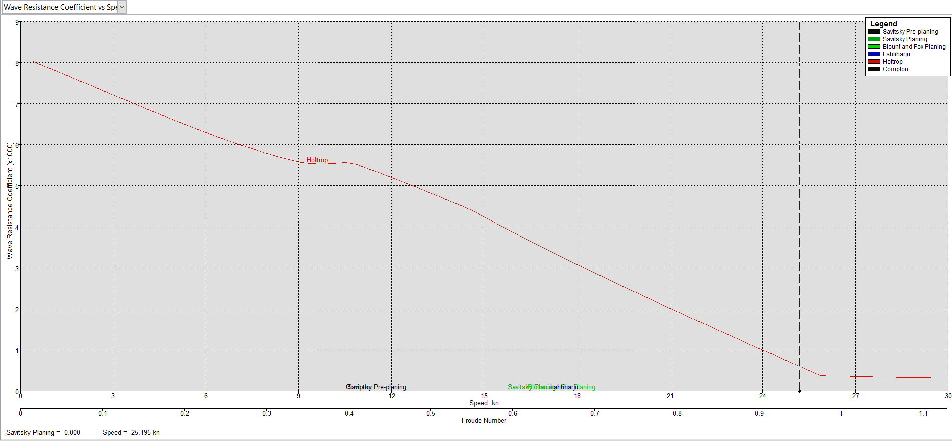

  3. Devu De Goa
    Joined: Jul 2015
    Posts: 58
    Location: European Union
    Devu De Goa Junior Member
    @Rabah
    Thank you Sir for your comments. Please do not misunderstand me. I am very much open to all guidance from everyone. But as a student of a University I can not copy something as it is and say that it is my work. That is called plagiarism which is punishable. Instead of ready made work I would like help in the form of references and ideas which help to take some critical decisions.
    As you have pointed out, the power will now go up from that previously estimated because the displacement has gone up from the earlier estimated about 25 t to the new of about 48 t. I would like to reduce the weight a little bit to stay within the data distribution provided by @bit in the graph.
    The top speed of 25 knots is the requirement of the project. I must meet that.

  5. Rabah
    Joined: Mar 2014
    Posts: 247
    Location: Bulgaria
    Rabah Senior Member
    Hi Devu,
    I respond on the problem which troubles you - what to make if calculated LCG = 8,08 m differs from LCB = 6,92 m from the transom received for Displacement = 44,42 t at an even keel by Maxsurf Modeler.
    1. If you yet have not accepted the ultimate form of the hull then it is necessary to act on classical version:
    1.1 To construct the curve of the sunk squares of frames.
    The square encased by this curve is molded displacement, and the centroid of square of this curve X = LCB m.
    First we plot a trapezoid which on square and the centroid responds on above specified conditions.
    Then the trapezoid it is changed by an isometric curvilinear figure on square.
    Ordinates of this figure are squares of the sunken frames.
    1.2 We plot each frame separately so to receive the relevant square.
    1.3 After already received curves of frames we plot computer model of the hull on which it is made dxf file of the Lines plan. For it will be LCB = LCG = 8,08 m, i.e. the vessel will be on an even keel.
    2. If you have ultimately taken the form of the hull /for example on the close prototype/ and it will not change, then the solution will be the following:
    2.1 Moving some frame spaces to the stern of the tank of the fresh water and the fuel for decrease LCG from the transom.
    2.2 Moving engines some frame spaces to the stern.
    2.3 General moving ER with transverse bulkheads.
    2.4 Moving the pilothouse some frame spaces to the stern.
    It is necessary to receive LCG = LCB = 6,92 m.
    And at two versions you should receive LCG = LCB that the vessel was on an even keel at inoperative engines.
    Continuation follows...
    _____________________
    NA Razmik Baharyan

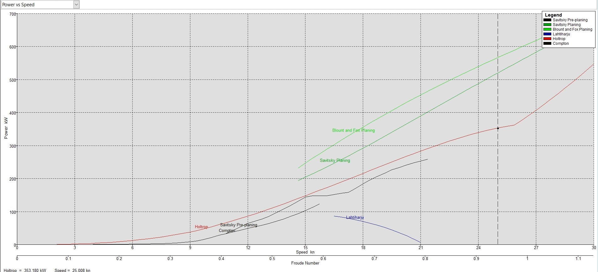

  7. Rabah
    Joined: Mar 2014
    Posts: 247
    Location: Bulgaria
    Rabah Senior Member
    Hi Devu,
    Let now we shall see what there will be the variance if shall make calculation of speed - power for model which I was offered, at new displacement = 44,42t.
    We receive that LCG = LCB, i.e. some masses are already moved to the stern to satisfy condition a vessel to be on an even keel when is not move.
    From Design Hydrostatics in Orca3D it is received for 44,444 t:
    Draft = 1,174 m; LCB = 12,131 m from FP / LCB = 6,869 m from AP/; Cb = 0,477; Cwp = 0,805; Cx = 0,686; Cp = 0,695; GMt = 0,915m when VCG = 1,82m
    Usually the ratio of effective to engine power figures of 50 % to 65 %. From - for it the calculation of the Planing Analysis is make in two variants - with Propulsive Efficiency = 50 % and with 60 %.
    The outcomes of calculation / see the files /:
    Will be necessary 2 х 850 kW = 1700 kW for achievement 25 kts at Propulsive Efficiency = 60 %.
    The vessel will be in semi-displacement mode at Fnv = 2,191 <3 and dynamic trim = 6,792 deg.
    ______________________
    NA Razmik Baharyan
  8. Rabah
    Joined: Mar 2014
    Posts: 247
    Location: Bulgaria
    Rabah Senior Member
    Hi Devu,
    The program Orca3D have a possibility at ready computer model to make calculation what power is necessary to reach the speed specified in the task of the project in initial blueprint stage.
    It is from a prime significance for the exact choice of engines.
    In Orca3D Help it is precisely specified what surfaces enter in the structure of the gliding plate /see post No 52/-it is the bottom up to the lowermost spray chine plus the horizontal segment of the same spray chine. Remaining surfaces do not enter in the structure of the planing surface.
    It is necessary to remember as a rule - the motorboat glides from that part of the bottom which reaches up to the first chine /with or without a spray chine/ or before the first knuckle. For example if we shall take that the bilge will consist of two knuckles then the gliding plate on breadth reaches to the first knuckle.
    If between CL and spray chine are arranged a longitudinal redans, they are not actuated in calculation from for small breadth - usually the redans have a horizontal segment 60-75 mm.
    The longitudinal redans increase the stability of the planing ship also moderate on-board and pitching motion.
    The breadth of the spray chine always it is more than for the longitudinal redans. At deadrise of the bottom > 10 deg the breadth of the spray chine = 4-5 % B.
    For our model planing breadth = 3,87m.
    4 % x 3870 = 155 mm
    Whether but how much signs the designer it depends on that is close prototype or from model tests.
    At calculation with Orca3D only half of gliding plate always is selected.
    Except for that it is necessary to indicate location of the propeller on X and Z after relation the beginning of the adopted coordinate system and an angle of dip of the shafting.
    What will be the conclusion from that I explain?
    If in your cross section in the bottom area there is a spray chine /not longitudinal redan/ then the breadth of the planing surface undertakes up to the extremity of the horizontal segment of this spray chine but not of the above arranged spray chine where starts the side plate.
    And if the breadth follows less as the lift force will be less.
    After relation the horizontal segment in CL - it would have sense only if was more broad and with knuckle instead of with radius of rounding to the deadrise bottom. Then the breadth of the gliding plate actuates only this horizontal segment in CL. It is possible only at small boats for which the smaller lift force is necessary. That is for gliding we hope only on the horizontal segment of the bottom in the CL.
    _______________________
    NA Razmik Baharyan

    (1) I discussed the project with my Professor. The total weight will now come down to about 30t. Should help us to reduce the power.
    (2) Based on the attached screenshot of the report given by you, does the software say that we can further reduce drag considerably by changing those values like deadrise? Will it give much benefit?
    (3) If the current design will operate in semi planing range, under what conditions do you expect to clear the resistance hump? Is the planing analysis reliable to compute pre-planing performance?
    (4) Could you please provide the angle of entrance value.
    (5) Also, how do we consider the vertical component of the propulsive force in this? Does the software take care of that? The horizontal component will push the boat froward, but the vertical component will have a rotating effect which will try to bring the aft of the the boat up.
    Can you please provide the latest hull shape which you are working on so that I can pick some ideas?

    To quote from the paper: "The second misrepresentation in the Michell’s near field free-surface boundary condition is eliminated by reformulating the near field in terms of “slender body” theory, versus “thin body theory.” This was originally completed by Ogilvie (1972). However, Ogilvie limited his results to wedge shaped bodies. Vorus and Taravella (2008) have developed a general solution based on Ogilvie’s (1972) formulation which yields very accurate results for length Froude numbers greater than 0.38."
    I have created a model which displaces about 30t. To my surprise the Holtrop method was able to show better results as compared to the previous results posted earlier for another hull form. We have a effective power requirement at full load of 30 t and speed 25 knots of about 350 kW (700kW bhp at eff=0.5) by Holtrop method. The Savitsky preplaning method somehow stops performing beyond 21 knots. But both methods are in near agreement upto 21 knots.
    You will notice the reduction in wave making resistance upto about 25knots, after which Holtrop method shows a sharp rise in resistance. Doesn't it mean that the bow wave effect has been shifted from 18 knots to 25+ knots. After that the wavemaking component will not decrease any further.
    It will be interesting to test this in the model basin.
    Attached are the results. You can point out if you find any discrepancy.
