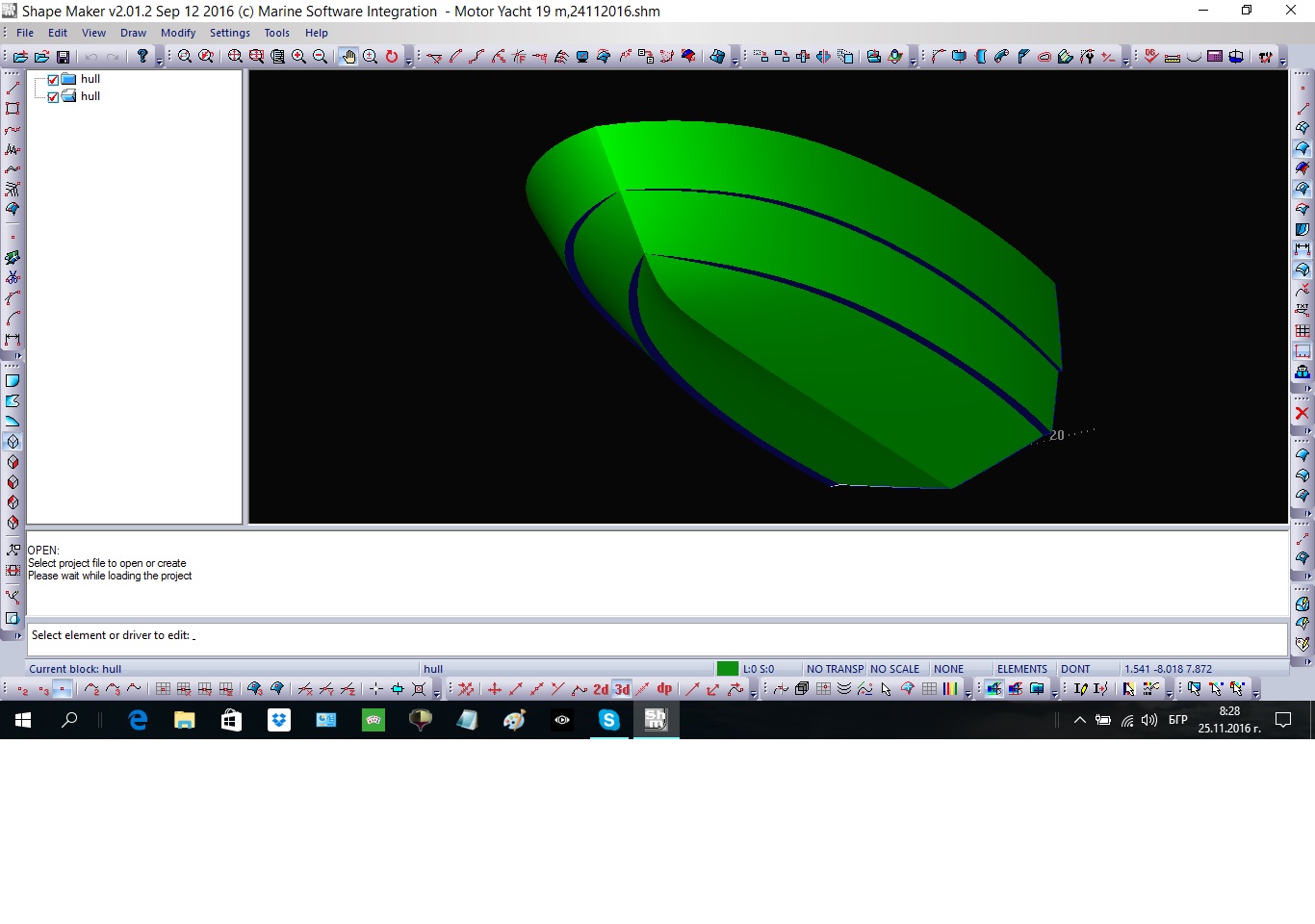

    To finish the work let we shall return there, whence started to make this model - to program Shape Maker with which have made the first steps to receive a good ship with impetuous silhouette.
    I have made again model on Shape Maker, identical that already saw in Rhino and Maxsurf Modeler, i.e. with deadrise bottom frames without rounding of bottom in CL.
    But unfortunately in the forum of Boat Design it is impossible to publish files with extension shm, for this purpose it is necessary to be content only dxf file of Lines plan, txt file for Offsets Table, Perspective view with Design Hydrostatics,Perspective fore view and Bodyplan view.
    You can see the zip file!

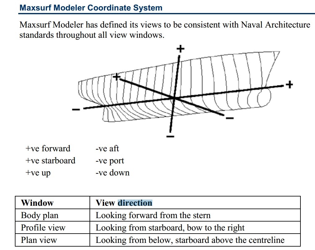

    I have worked out a preliminary hull and find that there is a considerable difference between our resistance values. Kindly find attached the files for power vs speed. My hull requires only 350 kW (effective power) for 25 knots as compared yours which is 600 kW (effective power) for same speed. Also note, how the Savitsky pre-planing and planing curves are almost merging to form a single curve for my hull.
    Also the wave contour at the aft of that hull is something worrying. Please have a look at the attachments. Your model was in the opposite direction in Maxsurf so had to be rotated 180deg.

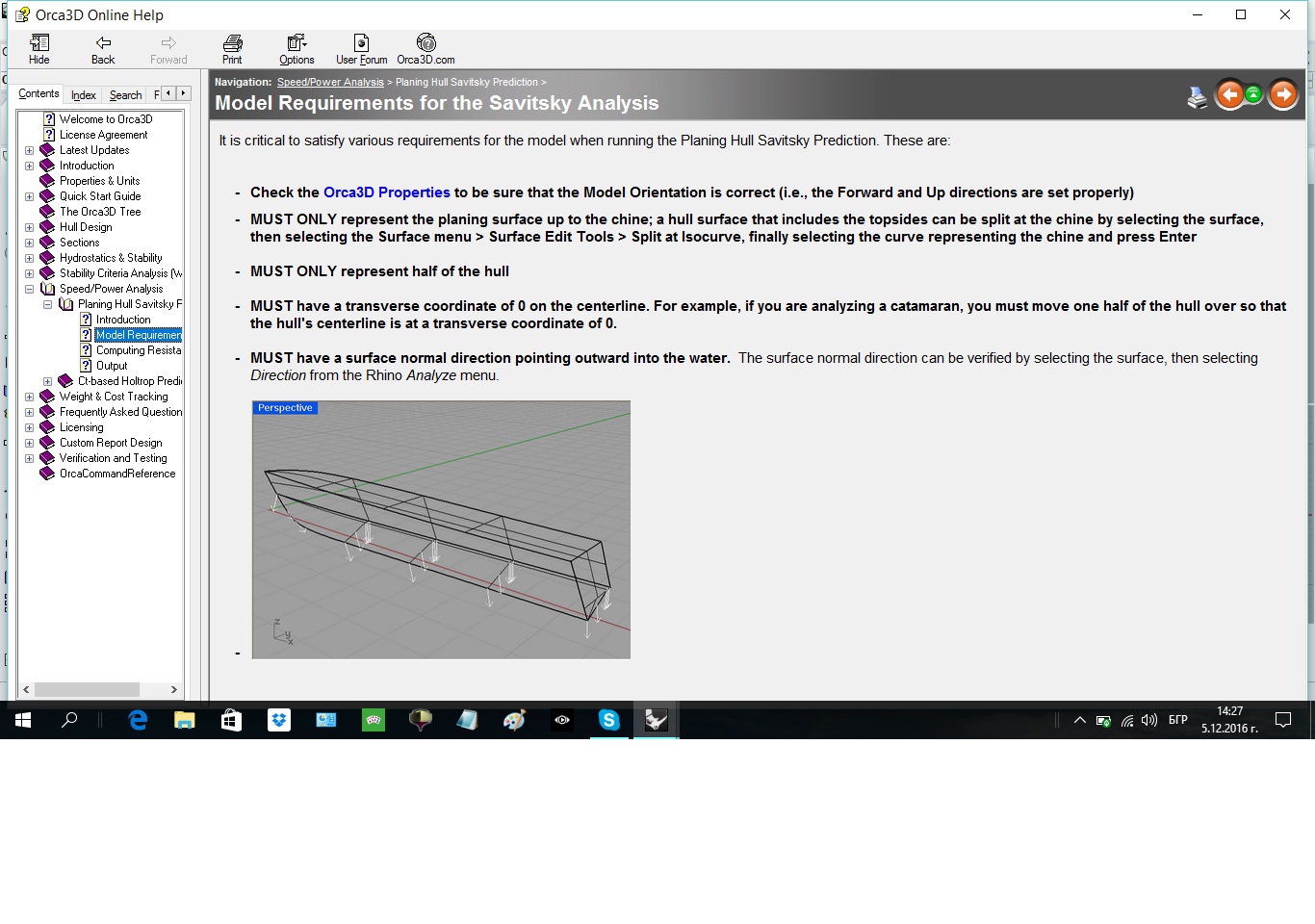

    1. Orientation of the coordinate system is made according to recommendation in the Help of the program Orca3D for calculation of Planing Analysis by the method of Savitsky /see the file/.

    I have used the Maxsurf model provided in the last post. When I opened it in Maxsurf it was in the opposite direction. Kindly see the Maxsurf coordinate system attached. I tried running it as it is but "Maxsurf Resistance" was dragging it backwards so I rotated it 180° and ran. If you say that power by Rhino is 472.5 kW, you may be right.
    I have not tried my hull in Rhino, only in Maxsurf. I do not use Orca yet. But I think, when I start finalizing the Lines plan for the vessel, I will also verify with Orca.
    The difference in our results may also be because of the hull form difference. In maxsurf the process is automated so you do not specify a trim angle for Savitsky method. In fact, you do not specify anything else except the methods and speeds. Then the software also gives a chart of trim angle v/s speed. What it means is that the software changes the trim angle on its own. I do not know the detail functioning of the software. But the result which I get for my hull is like I have posted.
