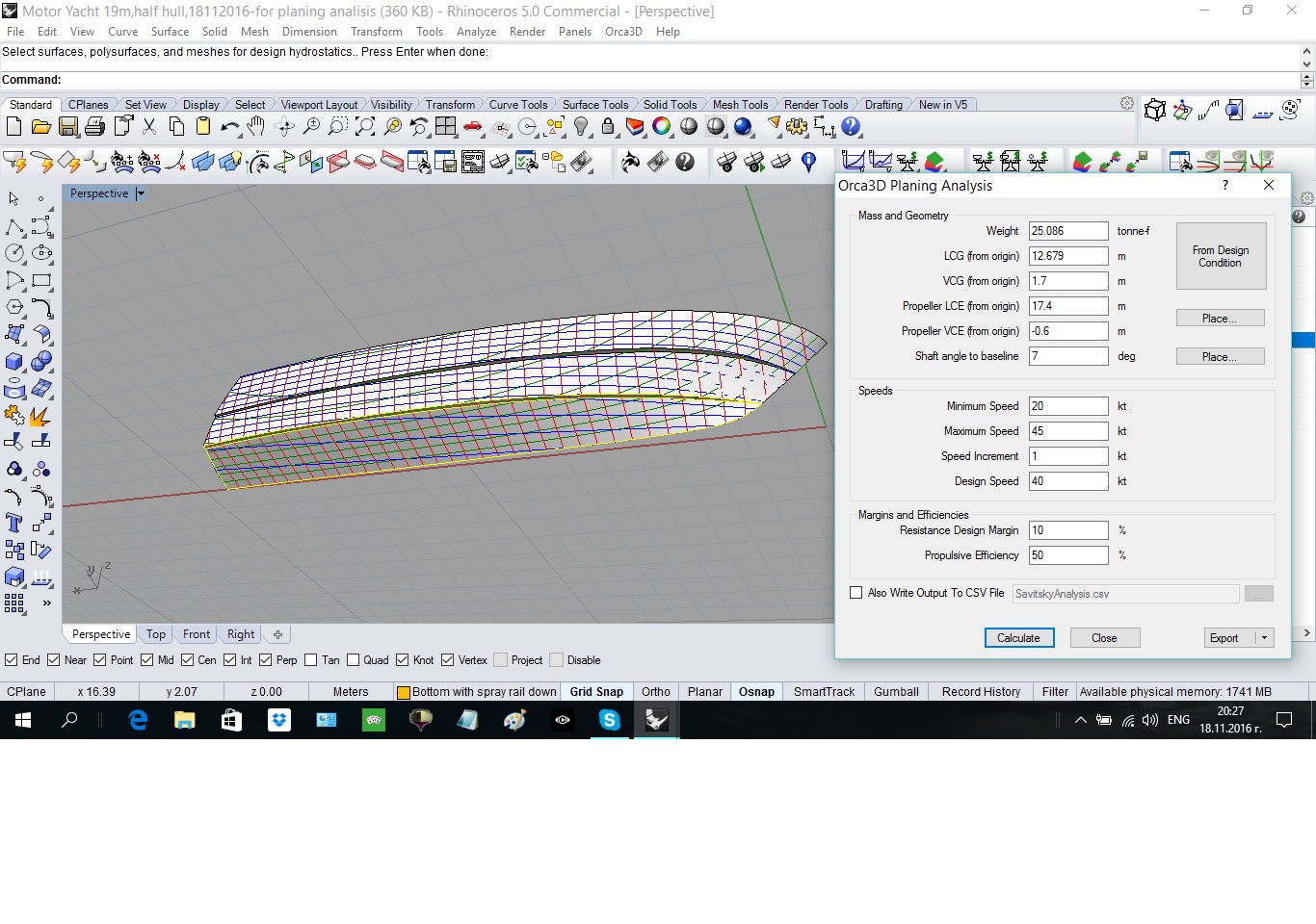

    Time is a request the vessel to be maintained in two modes - semi-displacement and planing, it means that the service speed is necessary to be in a broad band.
    If you will select more high-power engines and will make the project with such hull form that planing with this capacity automatically follows was received that these engines will be quite sufficient on capacity that the vessel was moved with smaller velocity in a semi-displacement regime.
    Differently on which example of model I offer to use, if we shall select two engines capacity 900kW for each, the total power 1800 kW will suffice enter on a mode of planing velocity 45kt.
    See at the file for calculation Planing Analysis with Orca3D.
    There you will see the following:
    1. From 20 up to 31 kt including we have a semi-displacement regime of floating at
    Fnv = 1,928 - 2,989 <3
    Dynamic trim = 4,72 - 4,64 deg
    Total propulsive power = 748 - 1158 kW
    2. At 32 - 39 kt we have mode of planing with
    Fnv = 3.086 - 3.761> 3
    Dynamic trim = 4,55 - 3.77 deg
    Total propulsive power = 1194 - 1474 kW
    But the vessel will be unstable, there is a hazard from Porpoising.
    3. At 40-45kt we will have stable mode of planing without peril from Porpoising.
    Fnv = 3,857 - 4,339> 3
    Dynamic trim = 3,67 - 3.2 deg
    Total propulsive power = 1522 - 1789 kW
    In calculation parameters which are incorporated will see on a picture, i.e.
    Displacement = 25t /alloy of aluminum / and VCG=1,7m; LCG=LCB = 12,678m
    You can change location of the propeller and the angle of the shaft axis or speed range and itself to make calculation on Orca3D, for that I publish also the file which differs from previous that two of surfaces - bottom and a spray rail, are pooled in one general and in the bow extremity of the bottom a new series of control points is added.
    If is that vague - ask!

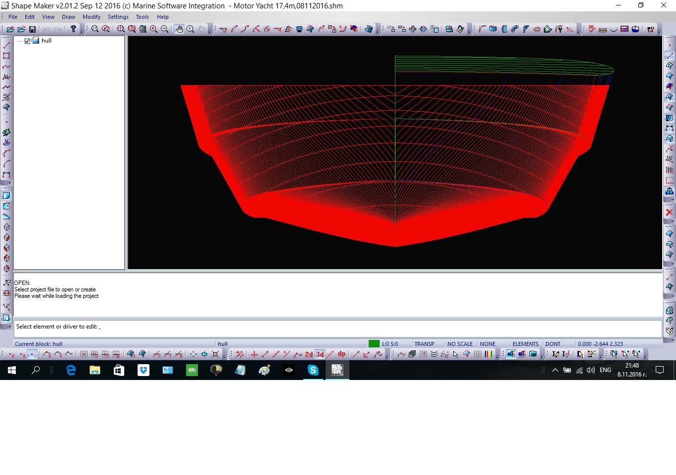

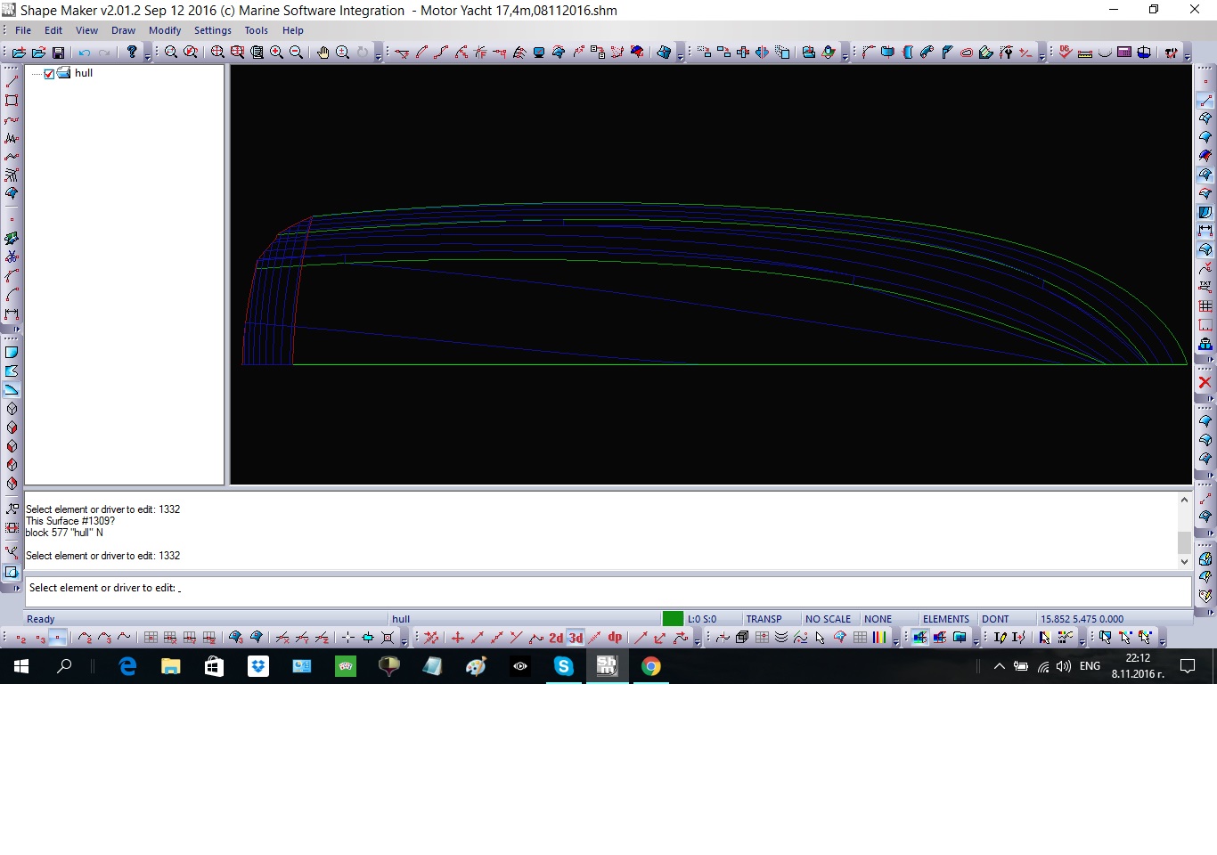

    Joined: Mar 2014
    Posts: 247
    Location: Bulgaria
    Rabah Senior Member

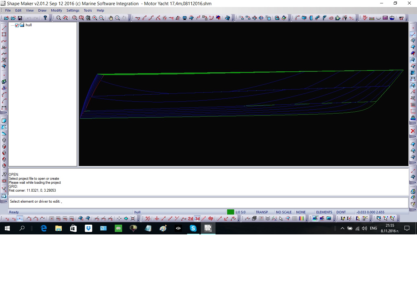

    Hi friends,
    Probably this model is not pleasant of Devu De Goa.
    Likely the similar model of a planing Motor Yacht will be necessary for other student. So that it is lost nothing and not for nothing it is made. Will suffice only to scale on X-axes, Y and Z or to use the function Parametric conversion on a coefficient of fineness or on displacement - see the program Maxsurf Modeler.

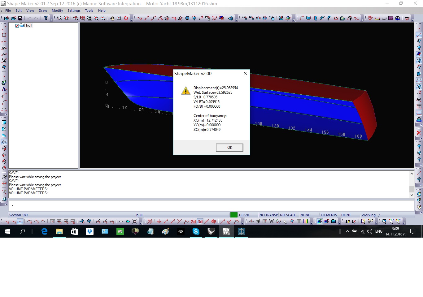

    To complete business up to the extremity has made the following:
    1. Has changed location started the coordinate system of model in Shape Maker - now it is in the bow /see the IGES file fig 1/
    2. Has a little bit corrected outlines of frames of the bottom in the bow - now they are straight-line with deadrise /see fig 1/.
    3. Has made a new Body lines on dxf on the new coordinate system in Shape Maker - see fig 2. Thus the Bodyplan is shown in two versions - about a frame space 500mm and 100mm.
    4. Has made the Table of offsets on Shape Maker for version about a frame space 500 mm - see fig 3.

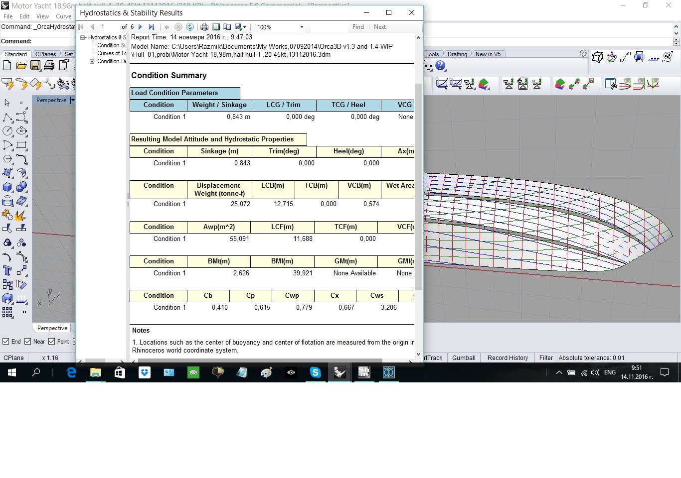

    5. Has made calculation of hydrostatics with Shape Maker - see fig 4.
    6. Has made export with IGES file from Shape Maker in Rhino - see fig 5.
    7. Has made calculation of hydrostatics with Rhino - see fig 6.

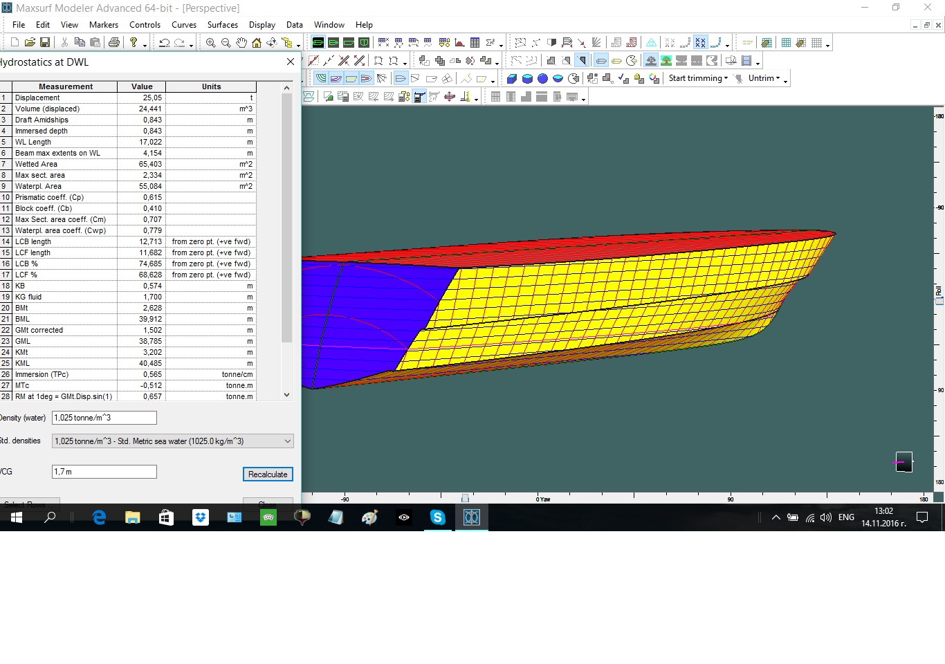

    8. The file of Rhino open in Maxsurf Modeler - see fig 7.
    9. In Maxsurf Modeler has made calculation of hydrostatics - see fig 8.
    Index 1 I mean those files for which started the coordinate system is in the bow.
    Now you can compare outcomes of hydrostatics for DWL.
    With it I finish this model. I hope that it has liked you.
    ____________________________
    NA Razmik Baharyan

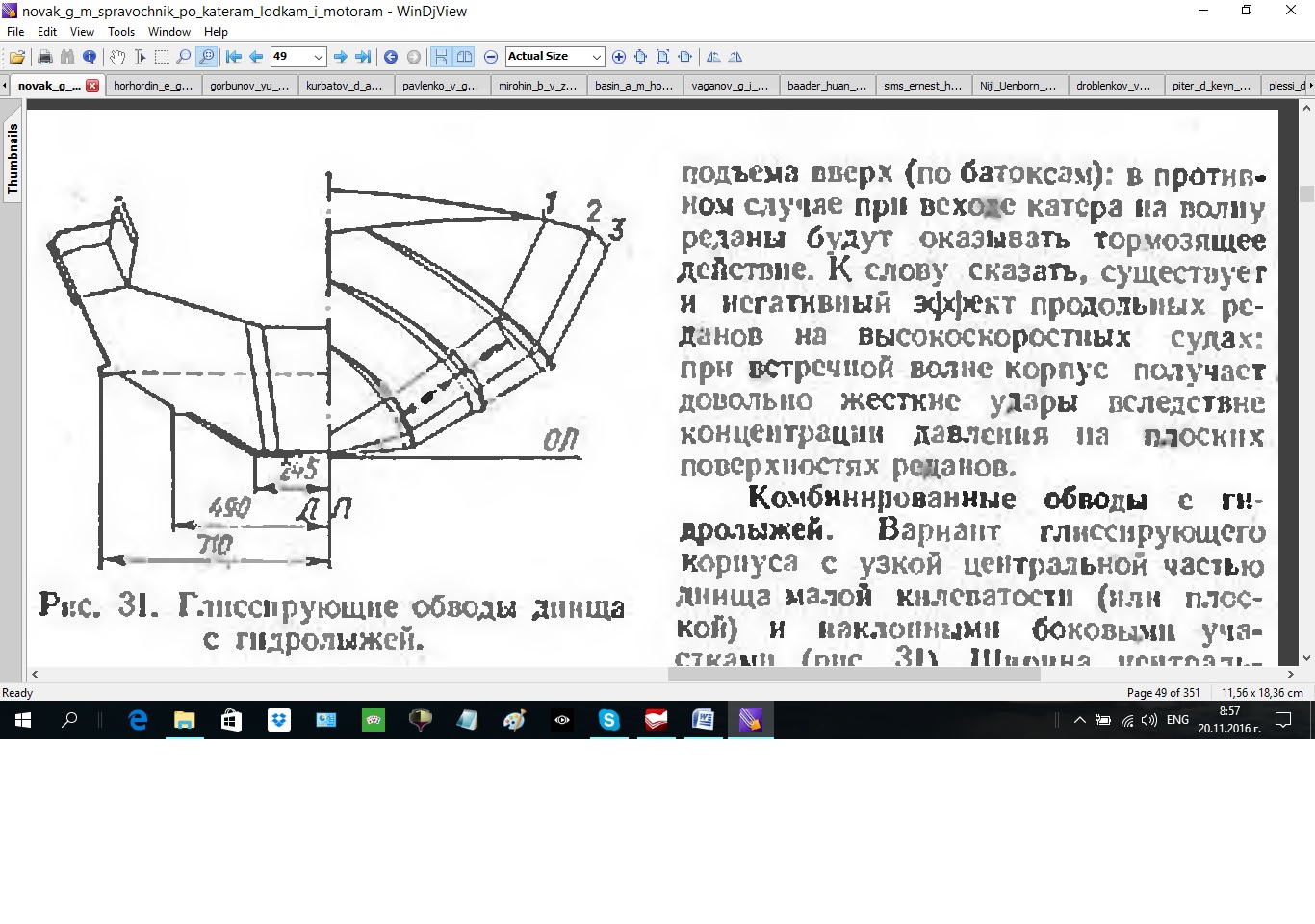

    Let's see what the experts write for the model which I offered to you. G.M.Novak in the book „ Motorboat, boat and motors in problems and answers”-1977, has shown model of a vessel with two spray wedges in drawing 19. It concerns to double-duty outlines.
    The upper spray wedge is on levels static WL of full displacement.
    Lower - on levels expected WL of planing with allowance for running /dynamic/ trim.
    What will be effect from these spray wedges?
    Thanking of them at movement in modes of floating and transfer to gliding it is a little decreasing of running trim.
    It is applied on motorboats by length L> 8 m at major external loads in the seas or oceans.
    Now we shall think as the model which I prefer will work.
    I will be not sure that maximum displacement of your project is 25 t. I expect that it will be more, that is static DWL will pass between two spray wedges. In such situations this model quite meets the requirements about double-duty outlines.
    At draft more than 0,9 m /e.g. by more displacement/ in the initial phases of floating only the upper spray wedge will be turn down the spray by the side when the mode planing starts.
    Except for that „At sharp heel, for example on circulation, the upper bilge - the spray wedge enters into water and due to the hydrodynamic lift force originating on its lower face, and also to sharply increased volume ensures an increment the Righting moment. ”
    When the vessel will pick up the speed up to the operational then it will glide only on two surfaces - bottom surface and down spray rail then the spray will be deviate by the side due to the lower spray wedge.
    Which you offer model is similar of the model with double-duty outlines with addition outlines of type sledge in CL /see the file with combination outlines/.
    Whether this model will work well? Whether there are feeble parties? Yes. We shall see what for:
    The breadth of the gliding plate it is necessary to take up to the first bilge, that is only the flat segment of the bottom in CL. Your gliding plate is received narrower than in my model. That is at the equal main sizes and at equal displacement higher power will be necessary for you that the vessel started to glide.
    If you want advice from me - I would remove the flat segment in CL and would make such a profile of the frame /see the file with monogedron outlines/-from one or two longitudinal planing steps.
    On relation of the spray wedges - you can accept version only with one in the joint of the bottom with the side. Usually second from above apply at a higher side.

    Hi friends,
    I ask to excuse me dear readers of the forum of my small mistake in the view of the stern extremity of the model`s deck. Has already corrected - and files.
