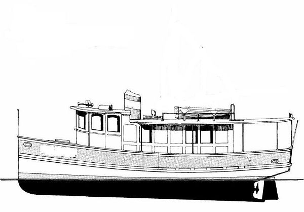

Are you reading my mind PAR ;)....ha...ha . How about like this?
I'll bet you could even put this superstructure on a flat rectangular barge hull....sort of a tug-barge, or barge-tug.
I'm actually looking at some ideas like this for a live-aboard for my Thai wife and myself, particularly as I began to see the difficulties with local city authorities about 'floating houses'.

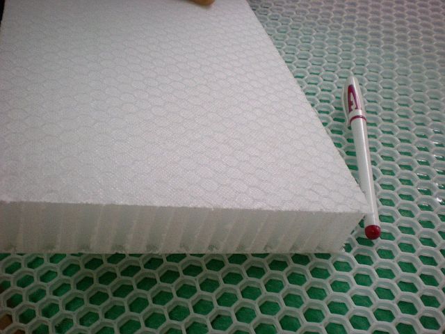

I'm looking at "Steel Hulls with Polypropylene Panels for the superstructure
http://www.plascore.com/pp-polypropylene-honeycomb.php
http://www.plascore.com/custom-composite-sandwich-panel.php

btw plascore is a great product.

Steel is great, but heavy and difficult to work. Honeycomb sandwich is costly compared to other materials. With costs being what they are, why not a one off 'glass hull with a encapsulated plywood superstructure. Hard to beat for cost, weight and durability.

Lets just talk superstructure here.
Aren't the superstructures of a lot of 'metal boats' (alum and steel) built somewhat along the lines of that wood structure that Tugboat posted,....studs and skins??. And then one has to provide some 'battens' (or whatever they might be termed?) on the interior surfaces in order to attach the 'interior finish surfaces/materials' to the vessel. And often you need to provide some insulation to keep down the condensation problem that occurs often with metals.
Couldn't that entire 'house structure' on that barge be simply made of a relatively thin fiberglass skinned 1 or 2 inch thick polypropylene honeycomb cored panels?
.... with Polypropylene Panels for the superstructure
So I am NOT talking steel in ANY of the superstructure. And I believe you would find that the Polypropylene honeycombs are a lot less expense that many of the other 'hi-tech' honeycombs.
Plus I don't have any 'encapsulated wood' to eventually get wet and start rotting. I would be willing to pay a little bit more to keep all wood out of any coring on a vessel, even a houseboat.
And I believe once you got a little system in place (something like Kelsall's KSS system), you could build that whole 'house/cabin' structure faster than that 'stud-skin' method.
