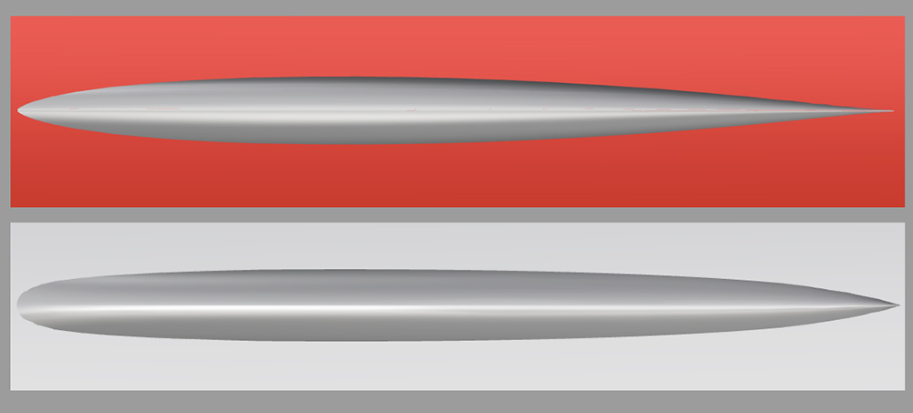

    You will end up chasing your tail on this if you cant see whats happening as your making changes. But as we suspected, your LCB is too far aft now and the prismatic is still quite low - you need more volume up forward.
    Honestly, if your taking this to a naval architect, they will sort all this for you and due to your design not changing above the false floor level, its not really important for you and working out your general arrangement- all you need to do is work out how much volume you need in your hulls to fit in your desired accommodation. The more volume you have - the less performance oriented the design will be as it will get heavier and have more windage with increasing volume. Its always a trade off between volume and performance.

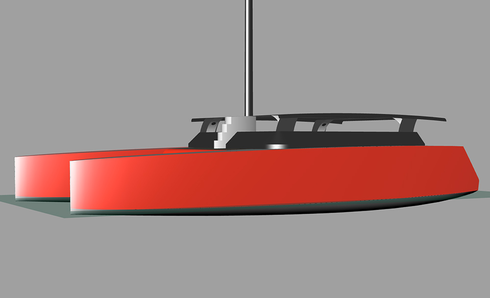

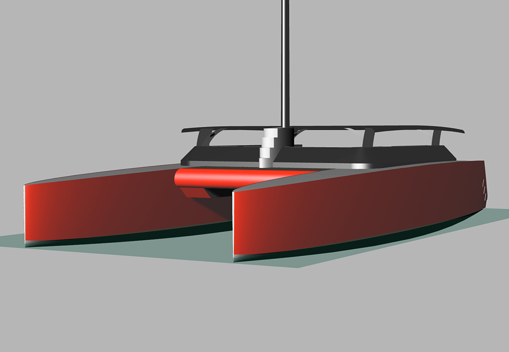

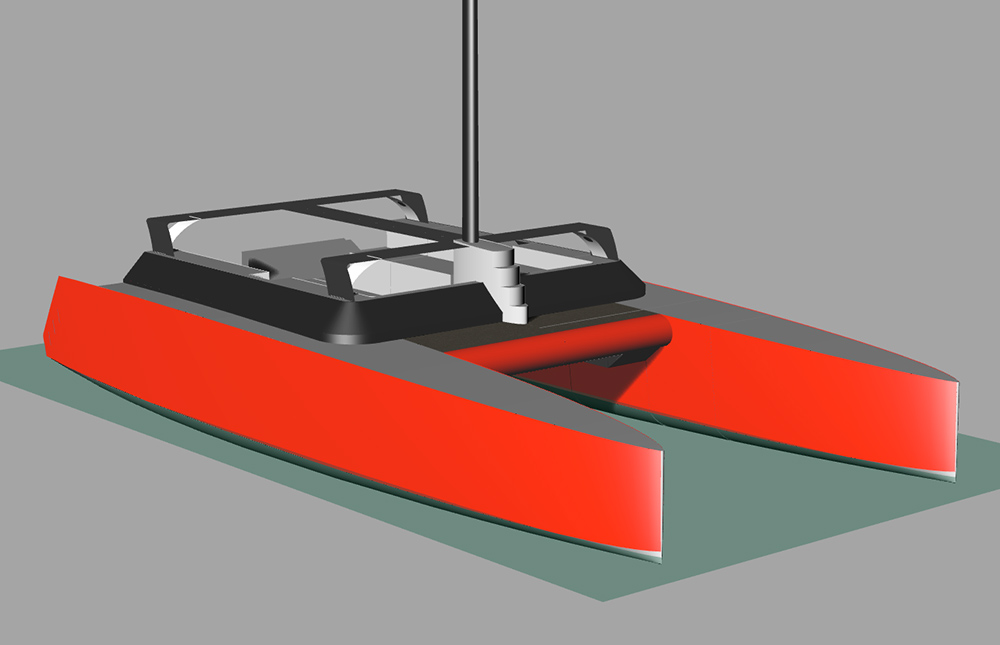

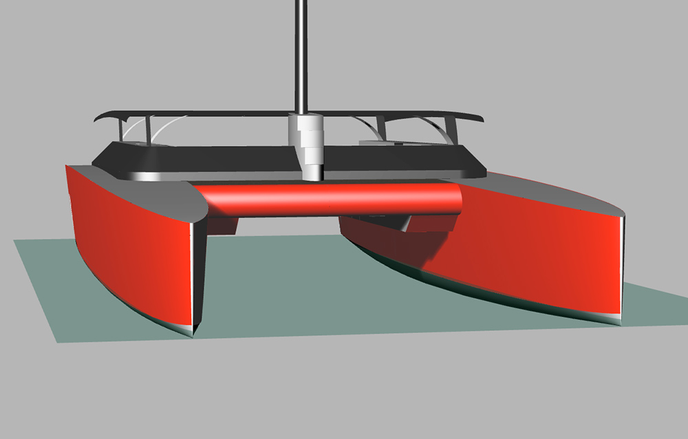

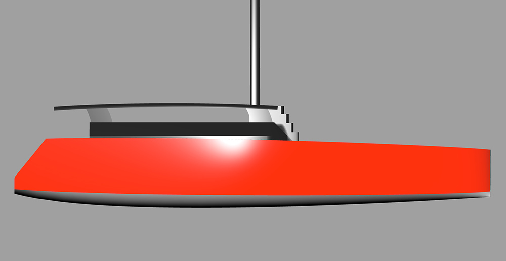

  12. jorgepease
    Joined: Feb 2012
    Posts: 1,620
    Likes: 51, Points: 48, Legacy Rep: 75
    Location: Florida
    jorgepease Senior Member

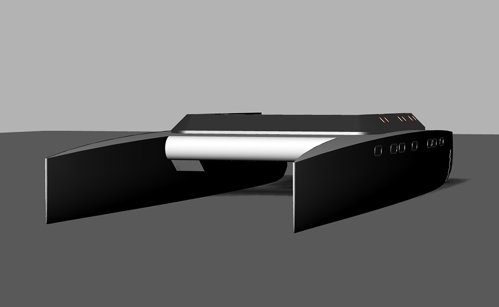

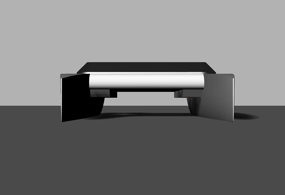

    About 515 sq meters of area. Not bad!! I will make a table of all the different areas so I can get an approximation of glass, resin and total weight. In these pics I changed a few things,
    1. Now it's a single layer bridgedeck, I dropped the interior floor 4 inches which let me drop everything else/
    2. Gave more volume to hulls in front because can't resist chasing my tail and I narrowed the hulls aft, it's pretty close to 4' waterline now.
    3. Added the support structure for the unstayed mast.
  13. groper
    Joined: Jun 2011
    Posts: 2,506
    Likes: 174, Points: 73, Legacy Rep: 693
    Location: australia
    groper Senior Member
    515m^2... does that include all the internal frames, bulkheads, floors etc?
    Do you not plan to have a fore sail? If you do plan on having one - forget the unstayed mast idea, you cant get enough tension in the forestay for the foresail to work properly.
    If you dont have a head sail - you will not have much sail area (power) compared to a boat that does carry fore sails.
    Also - if you dont have a foresail, you will need to move the mast further forward as the center of effort is too far aft where you have it now. The center of area of the main sail would ideally need to be close to midship which pushes your mast several meters forward of where it is now... compare to this for example;
    twin masts and sails to get sufficient sail area. Masts forward in the hulls to get center of effort in a favourable location. Downside is lost space in the hulls...
    Chasing your tail yet? :D

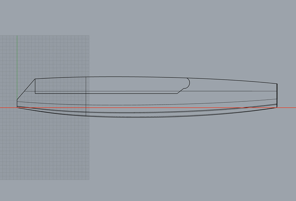

  14. jorgepease
    Joined: Feb 2012
    Posts: 1,620
    Location: Florida
    It will probably come to 550 meters when I am done but that will include almost ALL fitout :)
    Twin masts are going to cast more shade and take more room as you say. I am thinking a balestron rig will be perfect. This boat won't be a full on racer like yours but she should be pretty quick, she should be light, long and slender, about 1:15 , giving room to expand hulls if the NA needs to. Any innovations I can add to improve upwind performance will be opted for ))
    I am not going to chase the tail beyond this, at least I know my fitout fits. My beam is automatically reduced as well because I have less flair in the hulls but that will be up to the NA, it doesn't affect my fitout at all.
    The way I see it, I have a boat, that once popped out of the mold, will be extremely easy to fitout and rig. She will be relatively maint free when you consider the unstayed mast, micanti anti-foul, raised elec. outboards and direct drive steering.
    She will be extremely easy to sail, require MUCH less rigging, I can cook, clean, do yoga etc and the boat will hum along on it's own very efficiently and I will never ever need to bring fuel on board. :) ... Now that is what I call a cool boat!!!!!!!
    And I have three people very interested already ))
  15. jorgepease
    Joined: Feb 2012
    Posts: 1,620
    Location: Florida
    What my hulls used to be compared to now, much fuller in the ends, less rocker, rocker moved aft as Grainger does.
