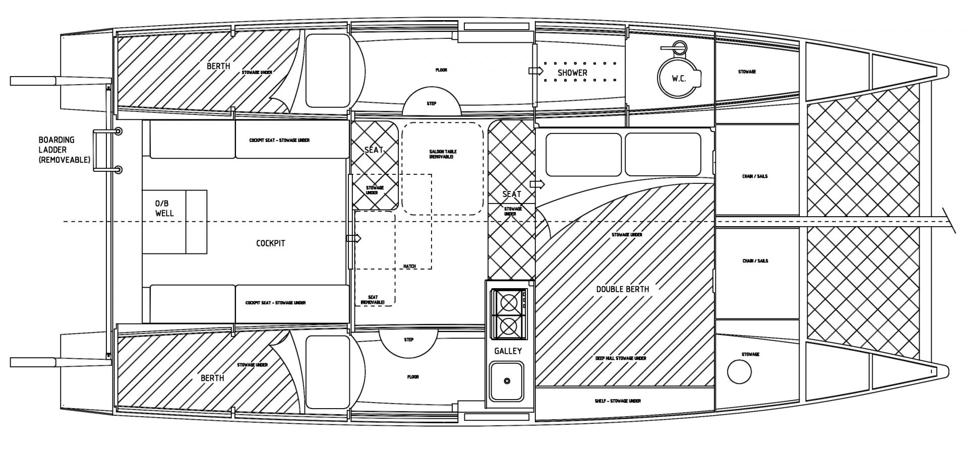

    Guzzi,

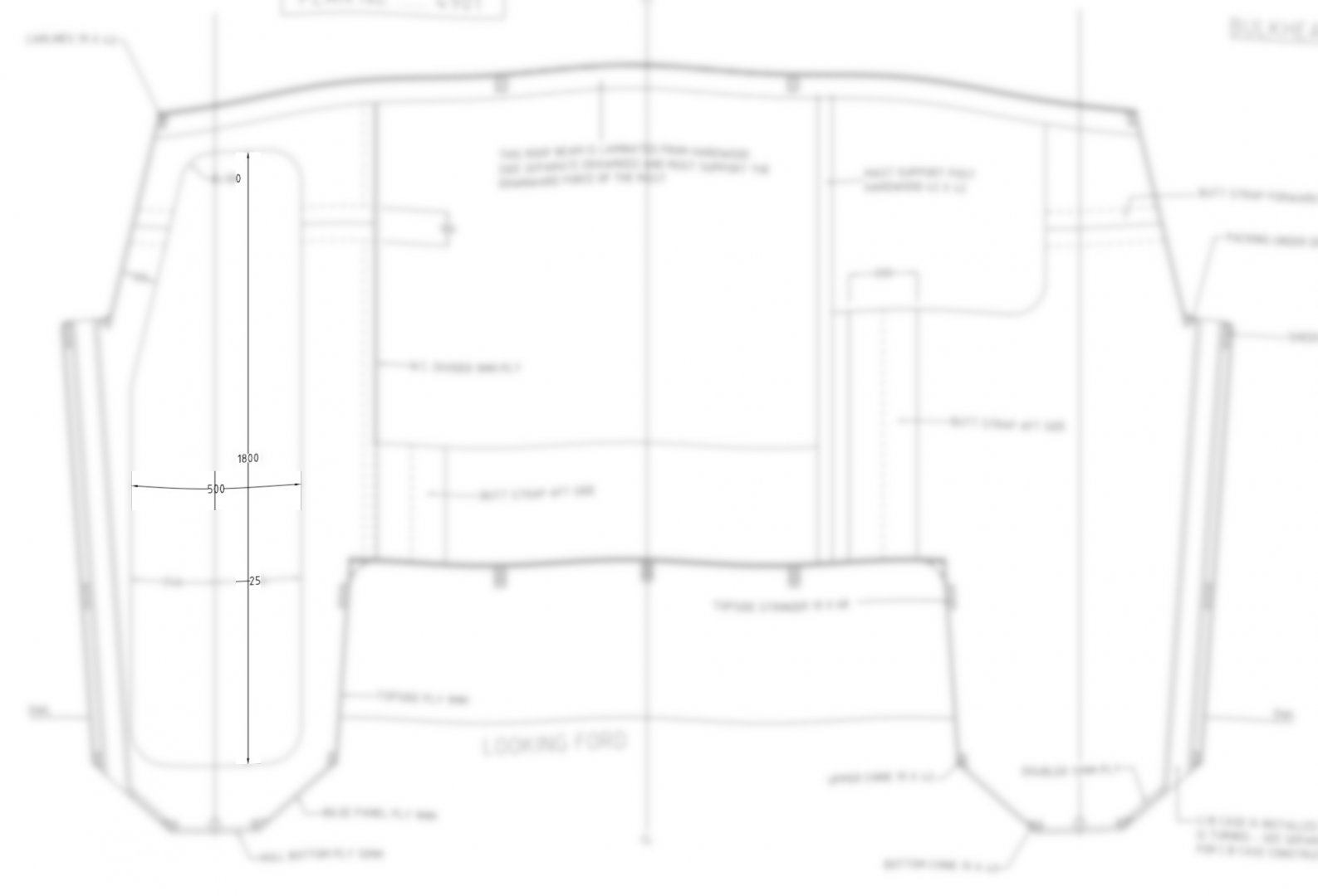

    Have you considered Waller's TC750? It's plywood, but I'm guessing it could be converted to foam without too much trouble? Perhaps it's not everything you want in a boat (eg full bridgedeck, a bit small), but it does seem to have everything you say you need.
    See attached for a picture of BHD #5 of the TC750, situated between the forward double bunk and dinette. I've blurred and slightly distorted the image to protect Waller's IP, but at left you can see the door to the head (with dimensions) and get a feeling for the volume of the space. Even with the raised floor (which lines up with the upper chine) there is about 1.9M headroom in the hulls at the bulkhead and nearly 1.5M over the dinette.

    Thank you for the suggestion. If I went with one of his designes I'd go the 880. I can work around most of the conversion to foam. Yes the rounded hulls are more work but it's not that much in the scheme of things...The problems with a full width cabin remain in both cases anyway.
    I have had communications with Mr Woods and it seems we have a solution. I hadn't posted this here because the conversation isn't finished yet, but he is ok with me growing the Saturn to increase it's load capacity and putting LAR keels on it.
    He has suggested casting the bottom 3 chines in solid glass which was a surprise. I'm thinking of making a mold to do this in one shot rather than taping 3 flat panels together, but I am at a friend's place atm so when I get home I'll try to build a computer model calculate displacement and so forth.
    I will update this thread when I've got it sorted.
