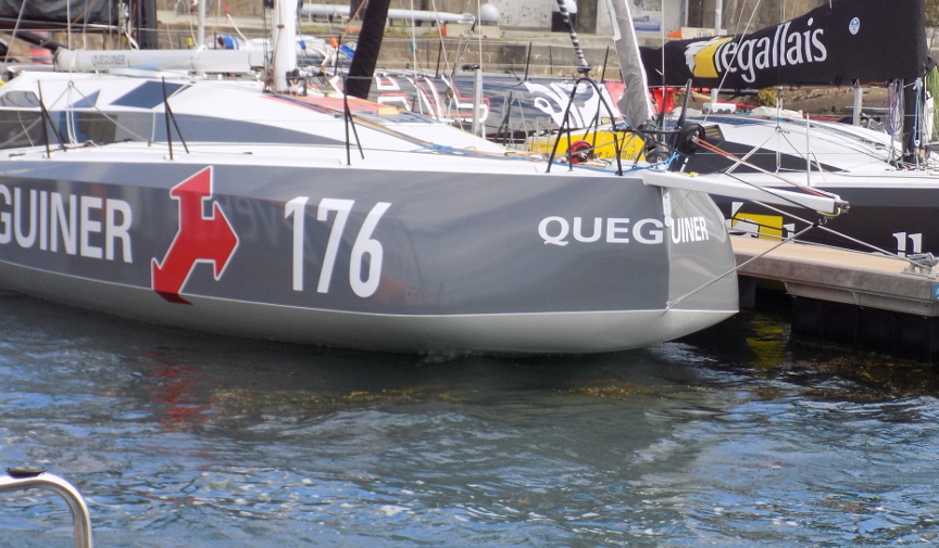

The last Class40 built, which made second in the last Route du Rhum, has a slight v in the bow
By comparison, the winner of the category has a cabin that looks more streamlined than the hull.The thing about all categories of racing artefacts is that if they perform,they are considered beautiful.It's just as well the boat does achieve results because it would otherwise be fairly ugly.I can see some benefit in having such a large reserve of buoyancy forward of the mast as well as having more internal space to spread out in.I don't believe it is the answer for all locations and all uses.

The issue is that a low deadrise Vee hull heeled at a normal angle can present a dead flat surface to the waves.
It's the opposite of some IOR boats, which pounded hard enough to break frames when motoring because of the flat bottomed bow sections, but were more seakindly under sail because the flat section then became inclined to the waves.
