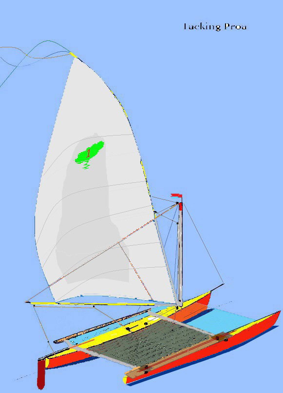

    I'm currently thinking about building a dinghy, show is one of the variants im choosing from
  7. BobBill
    Joined: Oct 2009
    Posts: 823
    Likes: 19, Points: 18, Legacy Rep: 157
    BobBill Senior Member
    FWIW, Simple is always best, especially at the outset. For example, what fix is as good as the original done well. Occham's Razor refined.
    OK, you and I are not architects and we also do not have accesss to many items, so, as it may sound goofy, begin backwards...
    Storage...where and what to do with rig when not sailing?
    Most builders do not realize how much sanding goes into watercraft...and eventually become discouraged...even quit.
    I, for one, have had (rebuilt) a number of boats...and each was unique in problems and fixes.
    The latest is the MO (see avatar)...
    For whatever reasons, I have always wanted an outrigger like the Malibu Outrigger...but have had a succession of keelers.
    This time, I decided to bit the bullet...intending to use unused or soon to be scrapped hulls, crafted anew. I wanted to by a large hull and trailer it. Hoping to acquire a set of Tornado Hull from Mr. Upchurch here, but could not locate a trailer...must have been fate.
    Ran into person who lived withing 4 hours of here who had a number of Hobiecat hull, AND, old trailer...basically hooking up trailer lights so I could haul...and for essentially free.
    My idea included using MO's original plans...as guide...and ran into a problem, Hobiecat hulls cannot handle mast without stays, which I did not know...but we were already committed...
    It went, with lots of custom work and is still going...which I love. 20 footer, 9' beam, 200 square feet of sail on long spars, using lots of innovation...and is fun/fast. All only 300 lbs all up! Even have 2sets spare tires.
    Back to beginning. have storage and had place to do work...garage/sail off trailer. New foam outrigger or aka coming up and large cockpit. Both PIA fussy but not hard.
    In short, plan ahead for storage and crafting...some harbors have channel ingress etc and require motors. Workspace...
    A scow type dinghy might be a toughie...rounded smooth....might be best to acquire used Butterfly...
    If interested in outrigger...Gary Dierking's text is good start...and decision re tacking or shunter....
    and sail plan/paddling-motoring elec/gas and how to do simply etc.
    Cost of lofting sail will run about $230+ not something one should do...imo.
    Hope this helps...

    A FWIW for Pironiero or anyone interested...One thing, if you plan to do spars...for me spruce was spendy, so I searched out bottom damaged carbon windsurfer spars, got two...shipping was major cost, but not bad and cheaper than the spruce...stress cracked at bases...no other damage...and made long wood ferrules to mate with 6061T pipe to lengthen...
    Suckers do "do it."
    Boom is 16" and holds clew and tack in position (loose footed) and the very-long spar which hoists sail luff is 26" and flexes like spruce as planned. Spills gusts like a charm...just like in this planner...
    The aka or outrigger will lose its wood decking, just recalled, will have to build spot to place electrice source for Minnkota (light) seawater motor...uses a wet battery which will convert fo 18650 pack when I can.
