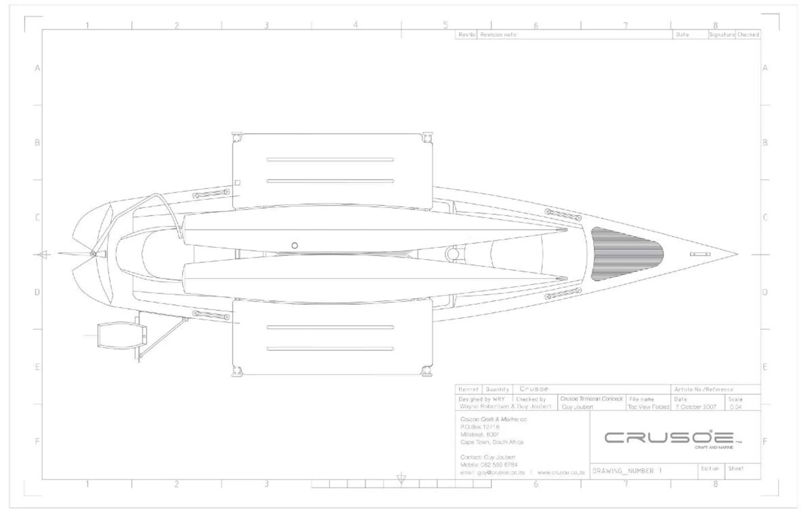

The following South African designed and built trimaran is described as an 18-foot Exploration Eco Trimaran. South African Guy Joubert is an adventurous person who has hiked, climbed, swam and camped in a lot of Africa. He wanted a practical boat he could trail and camp cruise the many coastal and lake areas. Result in 2007 he designed the Crusoe Modular 18 foot Adventure Trimaran.
The trimaran is 18 x 13 foot (can be folded to 6.6 foot for trailing). The weight is 700 lbs with a displacement is 1,500 lbs. The floats are 10.1 foot long. The 22.7 foot mast carries about 120 square foot mainsail and an 80 square foot jib. Draft from 1 foot to 3.3 foot over the lee board and rudder. Length to beam main hull 4.4 to 1. The float length to beam is 9.2 to 1 at the gunnels. The engine options are vast ranging from a 4 HP 4 stroke petrol outboard (9.9 HP is preferred), an electric outboard or a hybrid diesel electric combination.
This tri is not a performance sailor. Under power he Torqeedo Diesel electric configuration promises to push the tri at between 6-8 knots depending on conditions and loading. Under sail my guess is a peak speed of 10 knots with 6 to 8 knot averages. This tri will sail on all points but its fat main hull will limit its peak speed. It will be a good small motor sailor.
The open cockpit can store the float hulls or act as a sleeping area. The hulls have 21 separate storage areas for camping gear etc. There is a tent that covers the full width of the trimaran so you get in effect a 13 x 10 foot standing headroom “cabin”.
The design is built in fibreglass and has aluminium cross beam components. Simple structure that is built from several moulds. The skill here is the design. Each mould has all components (eg locker shapes) molded in from the start to increase strength and reduce production costs.
The Crusoe Modular 18 foot Adventure Trimaran was an interesting development. The jpegs give the idea.

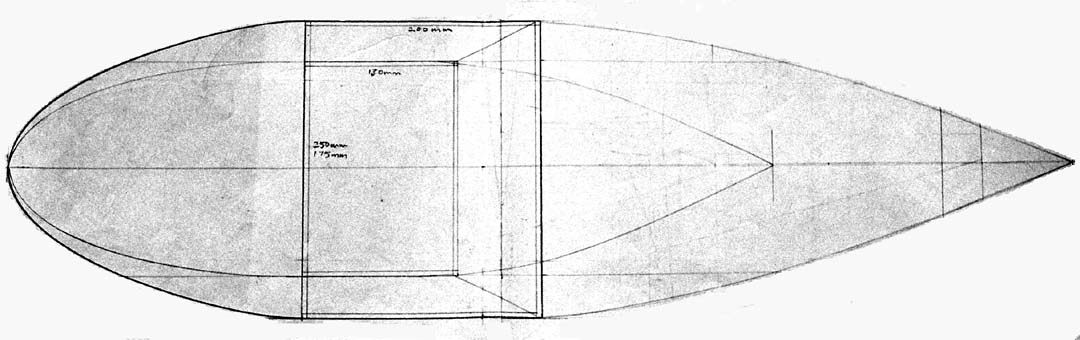

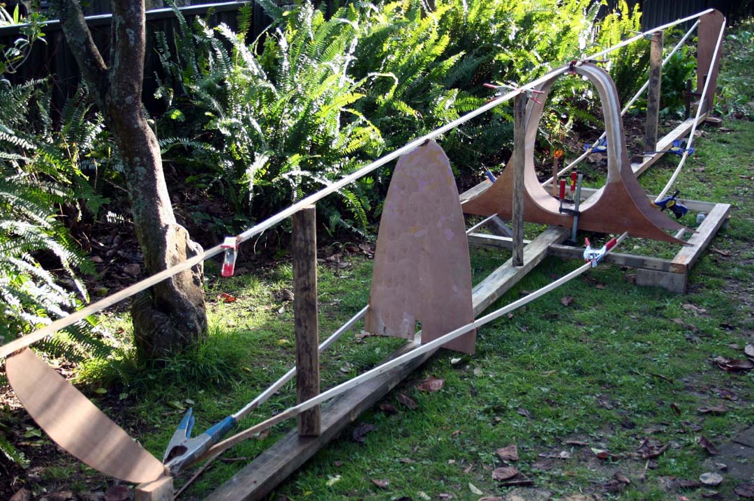

For today we will discuss Gary Baigent’s Sid again but provide some build jpegs to give an idea of how to build a very light tri. Sid had a variety of “Sid” names depending on the point of development. It started as a 25 x 26 foot tri but was extended to 27.9 foot. The boat weighed about 450 lbs in most configurations. The 36 foot high wing mast carries 355 square foot upwind and 538 square foot downwind. The length to beam is 21 to 1 on the main hull. The draft over the rudder is 3 foot and over the float based foils is 4 foot.
Gary indicated a few design measurements: ”7.62 LOA x 7.9m BOA, main hull WLB 0.350m, Block coefficient 0.32, Prismatic coefficient 0.44, Vert. prismatic coefficient 0.54, foil measurements 185 x 1500mm OA, 400mm bury, rudder 185mm x 1200mm, IT area 185mm x 1m approx, SA upwind approx - 33sq.m, displacement approx 200kgs, Bruce No. upwind 2.5, rig height 11m, wing mast chord 1m (perhaps), SA downwind 50m2”
Now a little history Sid originally was to have a tilting wing sail that pivoted on a short mast (see jpegs). The wing sail had an asymmetric profile. The tilt wing destroyed itself in a strong wind breaking in the middle. The wing sail leading edge was maintained and “symmetrical” backend was added prior to adding the mainsail.
Sid hulls are 3mm gaboon, with mostly 6oz box weave glass sheathing and uni directional carbon in high load areas. The build jpegs below are of Sid’s main hull and foils in one version. The cross beam section gives an idea of the structure and again features EG 3 MM plywood web panels and fairing. Yes, you can build very light and cheap if you want and it will absorb punishment.
Gary described his build technique as follows: “I make a simple strongback for building upside down - and for a narrow multihull that can be just one long plank with some crosspieces in the hull's widest mid section areas) then fit the three or four main bulkheads/ringframes, plus the stem and transom to the strongback, then run the keelson, gunwhales and stringers (plantation white cedar in NZ) over and around the heads/frames, these set in and glued into slots cut into the frames. So there is quickly the skeletal shape of your hull. Working on your own makes it difficult to handle the full length, scarfed 3mm klinki hull sides - so I just work a couple of opposing lengths/sheets/sides at a time, that is, glue and staple to the keelson and when it is cured, bend each length round the bulkheads/frames and glue/staple to the gunwhales. I coat the inside ply with epoxy just before I start bending it, then cove the joints with thickened glue. Working with two or three people you can do the two complete hull length sides at one time ... but you have to work fast and accurately. But on your own, just a couple at a time, works okay. Each ply length is already scarfed both ends of course, so for the next length scarf connection, I do a dry run just stapling, no glue, and pencil mark the correct positions- then glue/staple to keelson etc. coat the interior and move on. After all this is completed and cured, cut the excess ply from the roughly shaped panel sides to the gunwhales. Although this method is not as magical as true tensioned ply building, like the Tornadoes were/still are done, it is sort of halfway between and more suited to one person working on his own. Of course it is a lot easier with two or more people.”
The jpegs will give the idea and yes Sid sails very well again in excess of wind speed in light to moderate airs.
