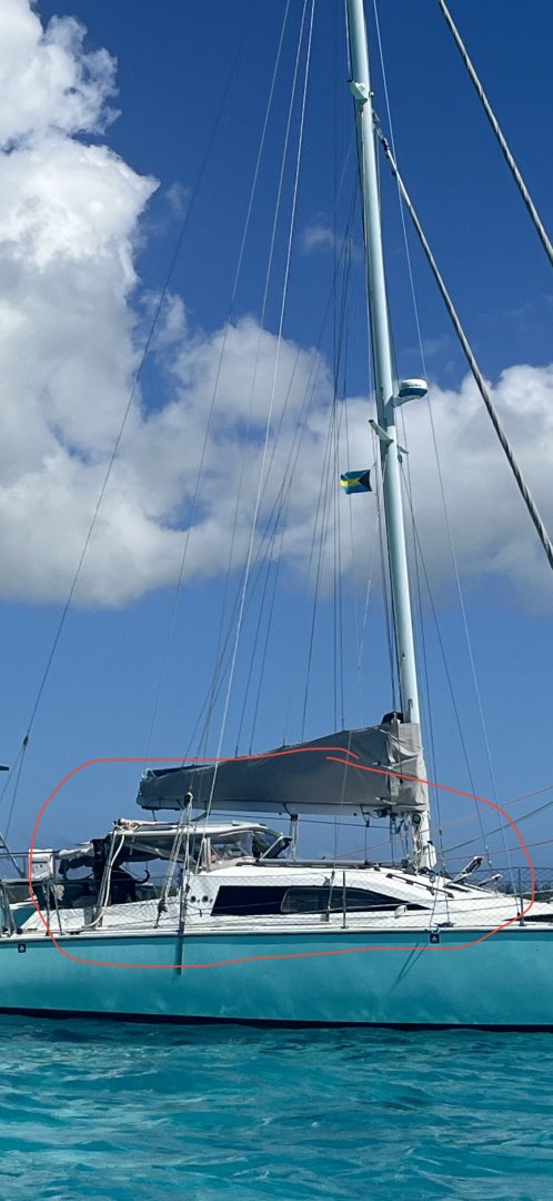

Let’s say we take our current tri and are looking to replace the two areas in red circles with diviny / glass.
The lower red circle is 4m x 3m with a slight curvature, unsupported other than the sides. It can easily hold 400kg yet only has the side walls. I believe it’s 12mm ply with one layer of 200gsm cloth on the outside.
The upper red circle is the cockpit roof, supported by a front and stainless poles at the aft end. Measurements are 4m x 3m as well, altho I wouldn’t put more than 150kg on it.
Thoughts on what thickness foam and the lay-up would be greatly appreciated.

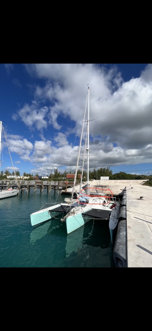

That tiny photo does not show very much really - it is very clear to you as to what you want, but I am still rather baffled.
Can you take some photos that show the areas of the lower and upper red circles in more detail please?

Point taken - even zooming in on that last pic didn’t blow it up much. Here’s another. The lower (salon roof) and then the upper (cockpit roof). Both to be replaced in Diviny / glass.
