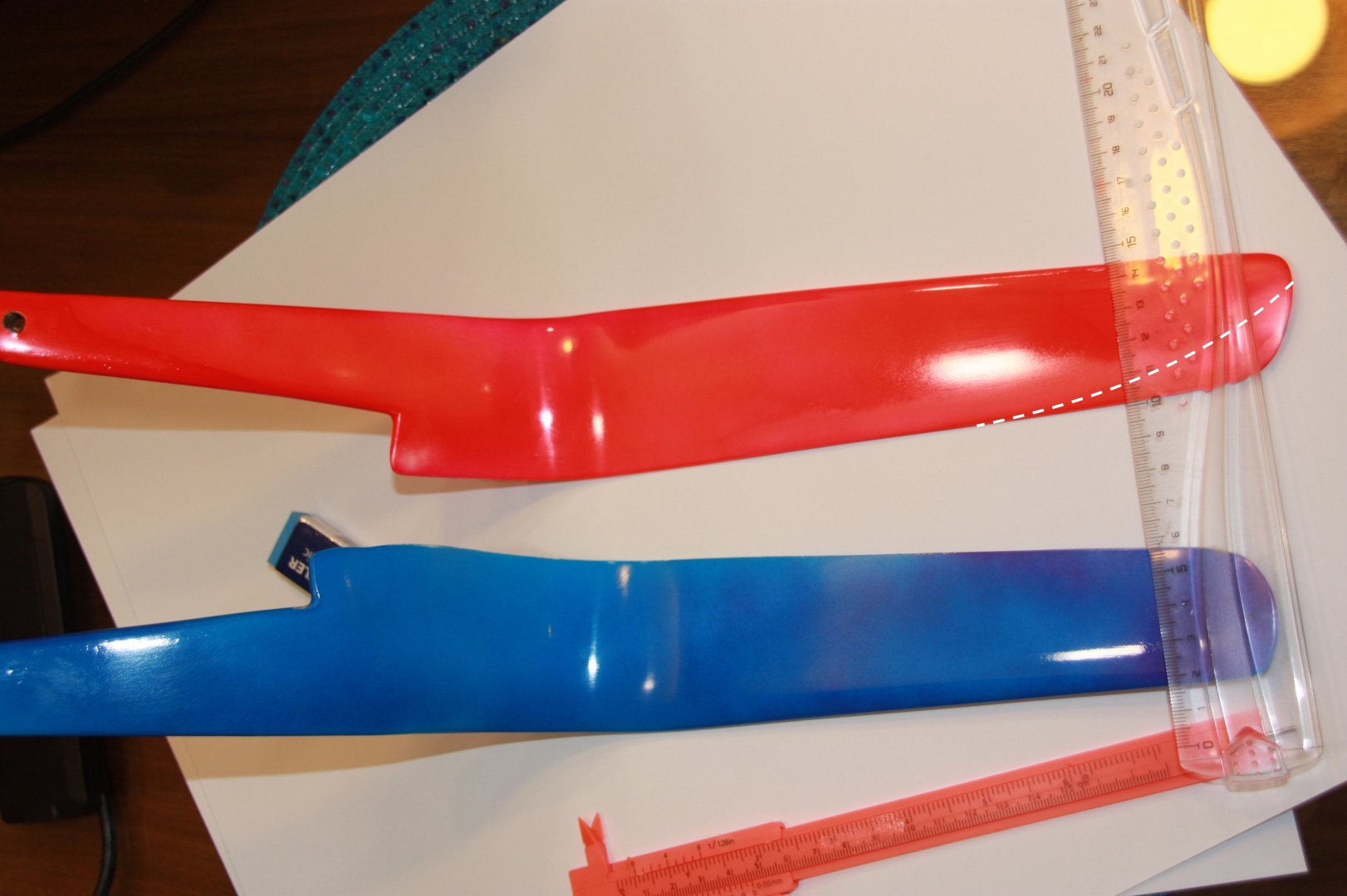

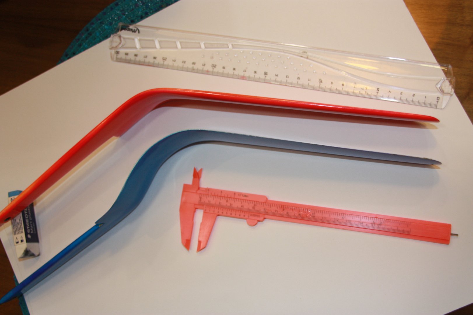

    It would be interesting to see how you make your foils. Do you have any "how to" images or text?

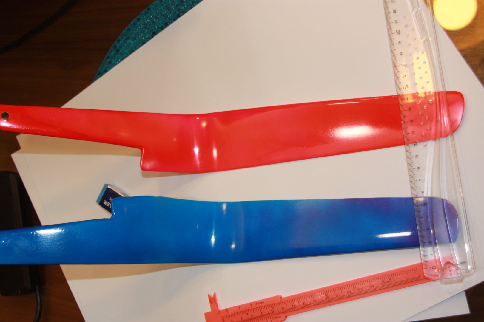

  13. PerthMini40man
    Joined: Jan 2014
    Posts: 116
    Likes: 34, Points: 28, Legacy Rep: 48
    PerthMini40man Senior Member
    If I told you I'd have to kill you! Its a trade secret right now .............. It took Dave quite a few beers to work out how to make them. Couple of pics of two of the foil types attached. I have been using the blue ones to date. The orange foils are longer will test these on Sunday

  14. UpOnStands
    Joined: Nov 2015
    Posts: 681
    Location: Sydney
    UpOnStands Senior Member
    Thanks for the photos.
    Suggested clip line shown on top foil. For strong wind days only?
  15. OzFred
    Joined: Nov 2015
    Posts: 509
    Location: Earth
    OzFred Senior Member
    Fair enough, I have some ideas but making them accurately is a challenge. Maybe some questions that you can answer:
    1. What section are you using? If you can't reveal that, is it symmetric or asymmetric?
    2. Is the "tang" of each foil is the same so you can swap them in and out easily?
    Thanks!
