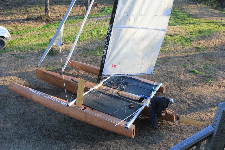

    W17 - Someone here said it was a "cruiser". That was a pretty good summary to me. It may be a very good boat for many.
    One boat I probably would like is the Discovery 21. Except for the antiquated folding method (too much weight too high when on the trailer), and the cost (ridiculous). It also was not the subject of this thread at 21 feet.

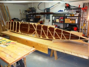

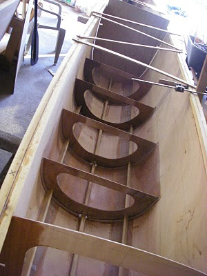

    Multihull Structure Thoughts page 85 has more details but could be the base of a good tri. “Mosquito” is a 22 x 16 foot overall tri that was built in 7 months. The tri weighs 350 lbs without crew or stores. The 35 foot rotating carbon fibre mast (30 lbs comes off a Bimare Javelin 2 HT 18 foot cat) that carries a 215 square foot mainsail, 100 square foot foretriangle and a 215 square foot screacher. Main hull 22 foot long and 2 foot wide with rudder on main hull only. Daggerboards in the floats. Warning some of the numbers are approximate.
    Main hull is a partially tortured 3 panels of 4 mm ply with 11 x 25 mm wrc stringers, 2 stringers per hull side plus a keel batten. The 3 panels of 4 mm ply are shaped and angled at about 70 degrees bogged and glass taped before lightly torturing the side and centre bottom into shape. There are temporary 25 x 50 eternal gunnels strips to help form the shape of the main hull. The bulkheads are put in, bogged and glassed into position. The main hull has 25 x 25 mm gunnels. There are 4 mm ply crossarm bulkheads and half bulkheads for the bunk floor. The stringers are then slide in from aft into the length of the hull into slots precut into the bulkheads. Bows have a 10 degree half angle. Decks are 12 mm durakore (1.5 mm wrc skins on 9 mm end grain balsa) that is slightly curved over 4 mm ply deck beams around openings. Floats 4 mm tortured ply with 4 mm ply bulkheads. Ply panels wired together with sheets held at 20 degrees (angled apart at 140 degrees) and a 90 mm radius epoxy bog keel placed in before folding. The ply panels are folded to the gunnel line and bulkheads are epoxy bogged in. During the process hot wet towels were placed against the plywood to try and reduce the stress build up in the plywood.

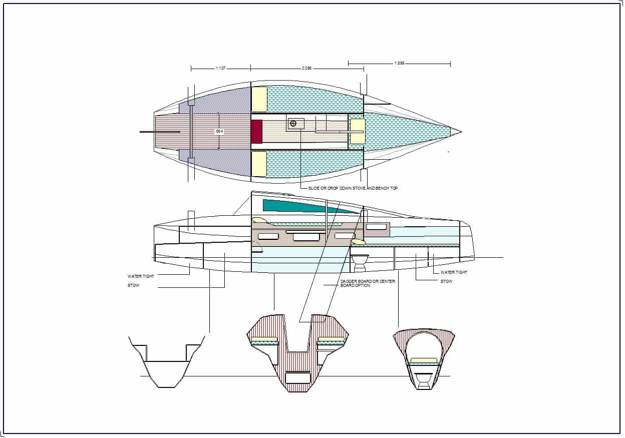

    I have looked at Sting 600 - too heavy, too big, and probably too high tech for my purpose. From what I have read so far I have narrowed down my candidates to the production Astus 16.5 (I can buy a slightly used sport version for USD 18500) and W17. Both these boats can carry several passengers, are reasonably fast and are quite comfortable. W17 with its flat bottom is probably better for beach launching and retrieving.
