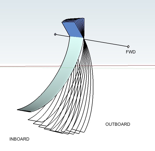

    Just played around with some CAD.
    If the foil can be rotated around an axis that lies on on the longitudinal vertical plane and is inclined 5 degrees rising towards the bow then by pivoting the foil to bring the free end outboard, the lift is reduced as the projected area of the foil is reduced, foil depth is increased, and foil angle of attack is reduced (axis of rotation might require some horizontal skew (5 degrees outboard toward the front) to more directly reduce AoA). Hopefully there could be some additional righting moment on the windward foil.

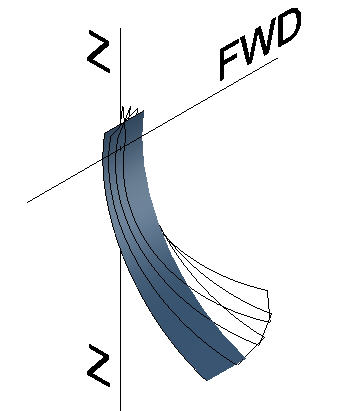

    Can any beneficial effect be generated by turning the foils around the Z-Z axis?

    With pure Z axis rotation it seems that you would get significant "steering" from the vertical strut before you got any useful reduction in lift.

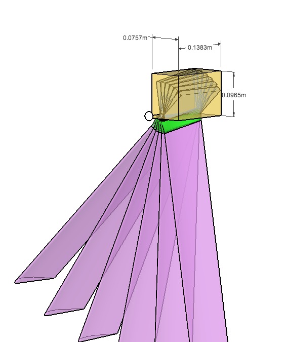

  13. UpOnStands
    Joined: Nov 2015
    Posts: 681
    Location: Sydney
    UpOnStands Senior Member

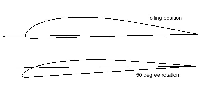

    Just for stimulation.
    Here is an Aquila 9.5% 12.5mm chord.
    If the foil can be pivoted on axis inclined 10 degrees outboard on the horizontal plane you can make the foil completely flat.
    Foil rotation is 6 by 10 degree steps
    The section planes are horizontal and show how much the profile changes

    Yes, but the "steering" is to windward, so not un–helpful. And the steering effect depends on the shape and attitude of the foil, I'm only talking of small rotations of perhaps 2° to 4°.
    Your diagrams are interesting, is the purpose to "feather" the windward foil? Rather than swinging it 50° to get effectively 0° AoA, wouldn't it be simpler to just rotate it a few degrees on its own longitudinal (span–wise) axis to adjust the AoA directly? That's what I meant by "tacking the foils", so they go from say 0° (or maybe even negative) AoA when to windward, and 3° (or whatever) positive AoA when to leeward.

    All started with the problem of strong wind gusts overpowering the model boat so it climbs up on the Z-foils and becomes unstable. The first goal was to cut the lift in response to stronger winds. The idea of increasing the RM came later.
    We don't want the inefficiency associated with flaps so there are three (?) ideas rotate the foils on their longitudinal-spanwise axis; swing the foils aft like a centerboard; swing the foils outboard so the effective lift area is cut.
    Can't see any practical way of achieving the first. The second cuts lee resistance just when you need it it most (and alters the CoE of the swung foil :mad:). The third actually increases lee resistance.
    Trouble is, in the real world the third way really suits only trimarans, not catamarans :confused:
