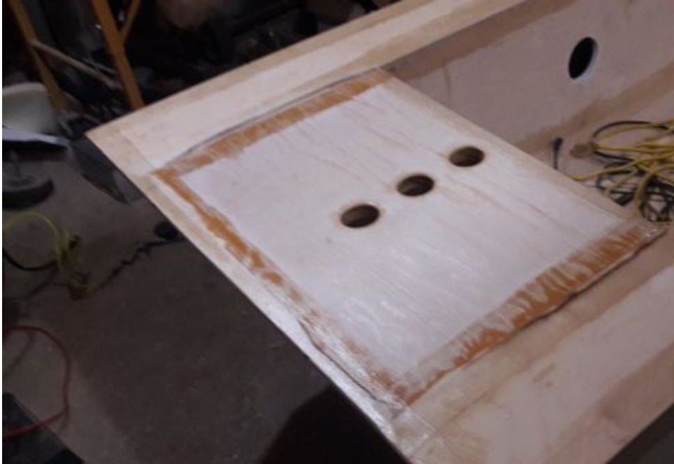

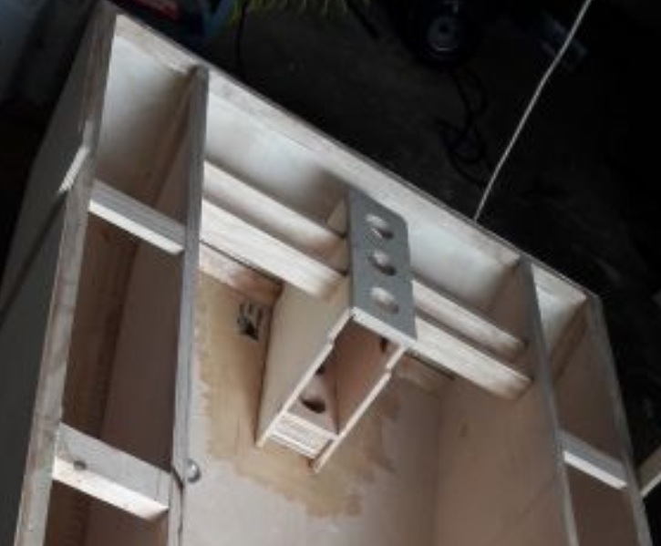

    BTW any thoughts on the tolerances for the mast fitting? I was thinking 5mm wider than the mast should be OK - judging from the pics at pdracer.com. I am planning to essentially copy this fitting:
    https://www.pdracer.com/free-plans/bucket-ears/frame-bulkheads/unstay4.jpg
    I presume there is some reinforcement behind the plywood where the mast holders are screwed to. Any advice on this?

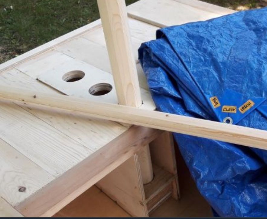

    I don't see anything so wrong with that fitting but I would make it a little tighter so the mast does not knock around.
    I have seen a similar one like that with a metal strap that swings out of the way (edit: on the upper block) to make stepping easier.
    Adding a plywood backing plate in the air box is a good idea, 13-15-18mm or so.
    My PDR had a fairly elaborate mast step / fore deck assembly, some of it driven by having access to CAD and CNC.
