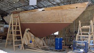

Lead ballast has been re-fastened by custom made bronze bolts, copper antifouling paint under the LWL; topsides were painted and polished, new...
vintage camper&nicholsons sloop restoration we rebuilt and replaced most framing by laminated framing; laminated floors; cold molded two...

Al the steel fastenings through the +40 years old hull were badly corroded. All were removed and replaced by bronze fastenings; The framing was...
three layers veneer impregnated in epoxy; first two layers diagonally; third layer horizontally;three coats epoxy on the outside. the framing was...

most framing , most floors and 70% planking were rebuilt in laminated ash epoxy capsulated; the hull was rolled on two massive wood wheels; in...
first we took the paint off the entire hull and deck. the hull structure is resorcinol one layer of 10mm cold molded mahogany over inner 9mm...
