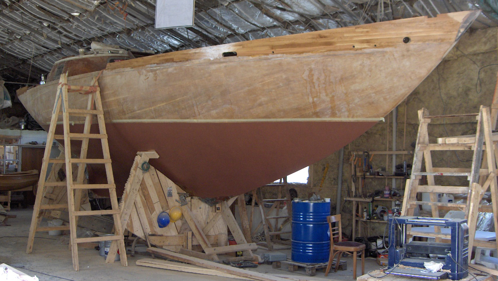

vintage camper&nicholsons sloop restoration
we rebuilt and replaced most framing by laminated framing; laminated floors;
cold molded two layers veneer over the whole hull; rebuilt thje deck by dynel set in epoxy ;
changed all original steel fastenings wich were badly corroded by bronze fastenings
