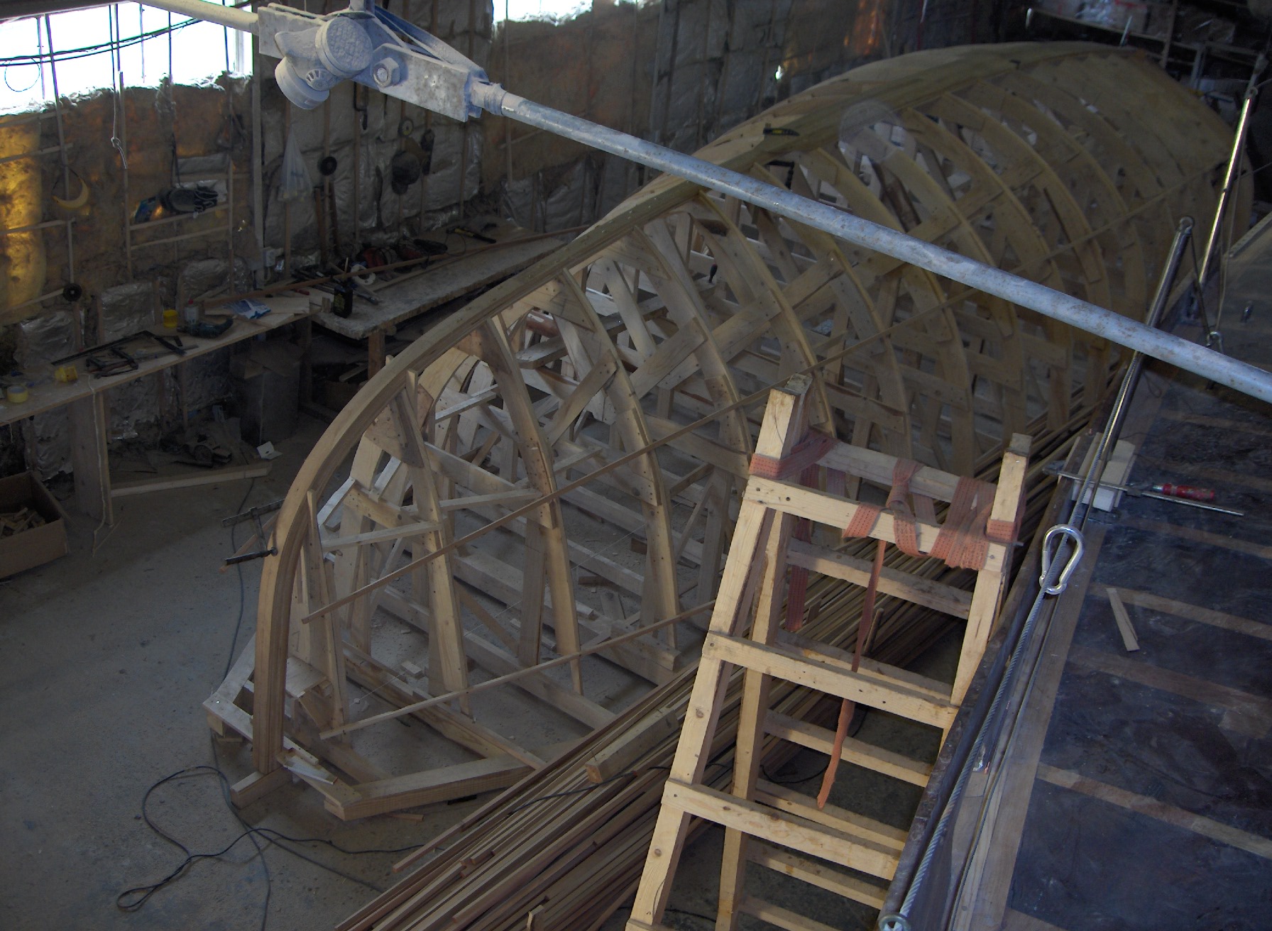

36 ft cruiser laminated keel and stem
an2reir
an2reir: 36 ft cruiser laminated keel and stem
Western Red Cedar "frameless" strip planking fiberglass &epoxy sheating 36 ft cruiser racer . Minimal framing is going to reinforce the hull; interior bulkheads acting as framing. Construction setup was strats by laminated keel and stem/ stern. The stern sections of this vessel are distinctively rounded.
