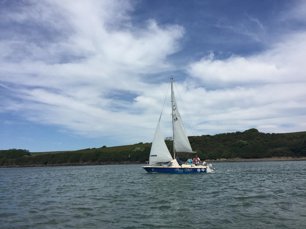

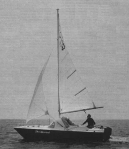

Not a Hirondelle 20, but a "cracksman"
Skarabougcraft. The Hirondelle 20 and "Cracksman" sold very well at the time. The Hirondelle was extended and subsequently widen in later production versions. The Chacksman had a bigger cabin put on but both cats suffered the same problem. They were good cats but the cost of building them increased to the point where they were uneconomic to produce at an affordable price. People were prepared to pay twice the price for a cat EG 4 foot longer cat with more space or performance, but a solid smaller cruising catamaran needs to be as cheap as a Hobie 20 or I will choose the Hobie 20 type thinking.
Reality there is a market for a smaller cruising catamaran but only at a price people can afford, and our society is dividing into a few people with a lot of money and many with a little money and many expenses.

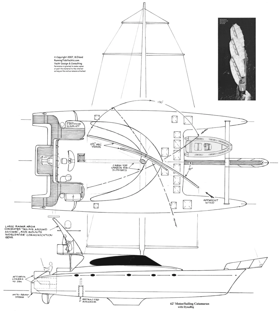

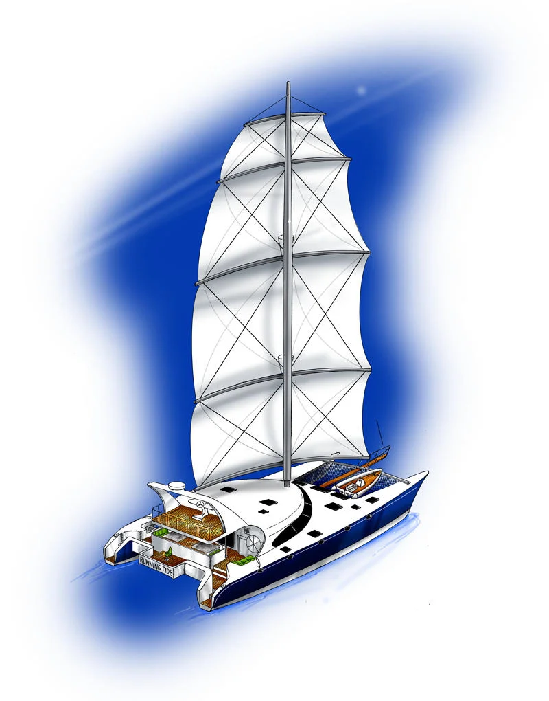

I was also much inspired by the dynarig development as it was introduced on MF.
This was my interpretation on a catamaran,..
DynaRig MotorSailer https://www.runningtideyachts.com/dynarig/
