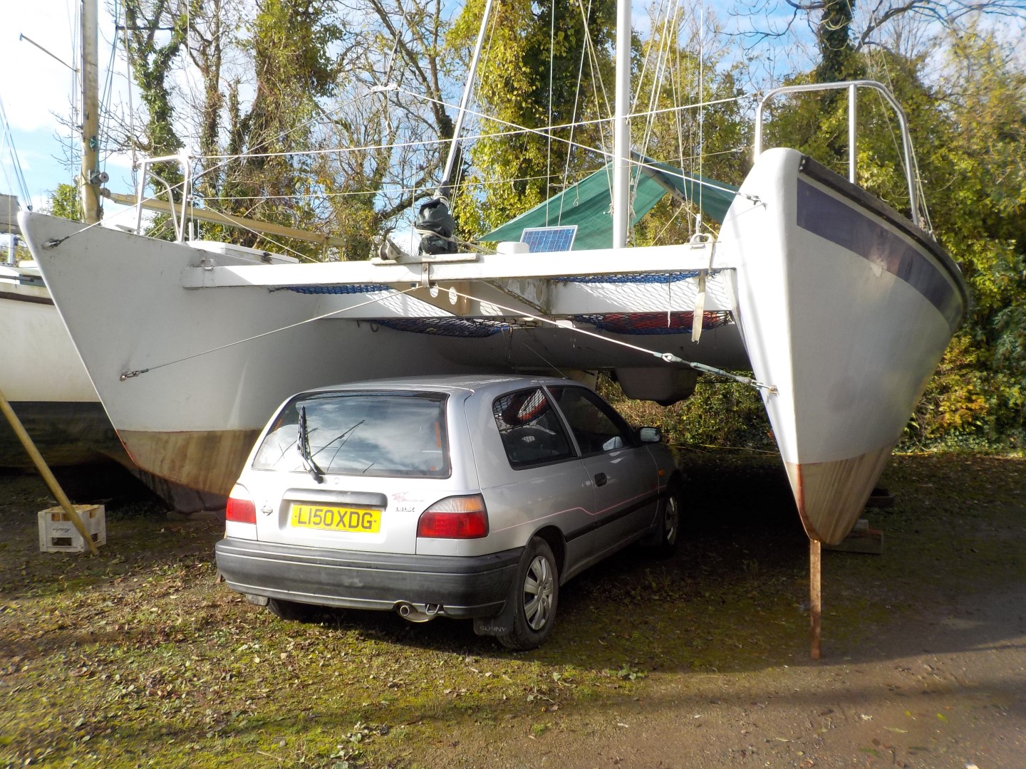

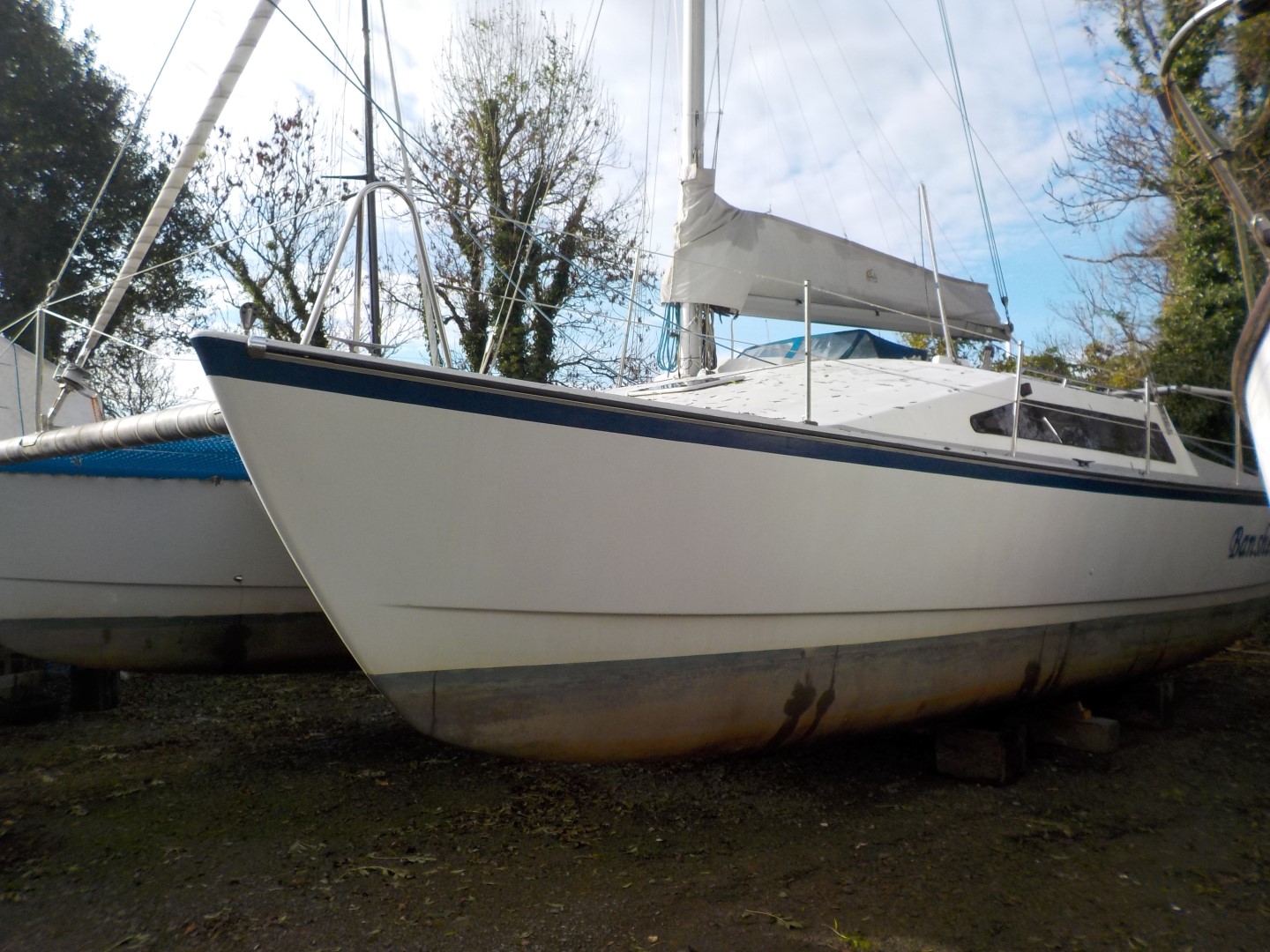

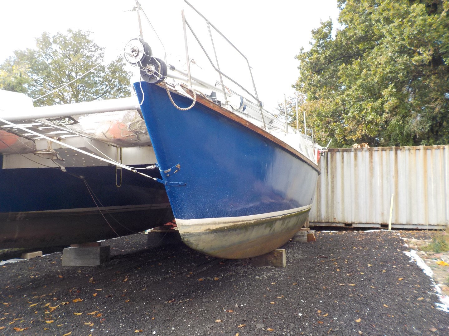

It feels a bit strange writing about my designs in this thread as it proves that I am now old, if not actually historic.
Anyway, as many of you know, I have lived in and around the Multihull Centre since 1982. So there have always been many examples my designs in Millbrook. Now is the time to view them as boats come out of the water for winter storage.
I was down in the yard earlier today. Three boats were of especial interest. The first, Rainbow Runner, a blue Windsong, launched in 1982 was my first design commission, it had rounded V hulls rather than straight V.
Then a standard Windsong, launched in 1986, it has made two Atlantic crossings.
And finally the 35ft Banshee that was our own boat, the Banshee prototype, launched in 1986. As you can see, all are actively sailing and all still in good condition despite being over 30 years old.
more on my website
www.sailingcatamarans.com

Don't use the O word Richard, the term is seasoned! Beautiful boats.
Seems I have to join to view the pictures. Not
