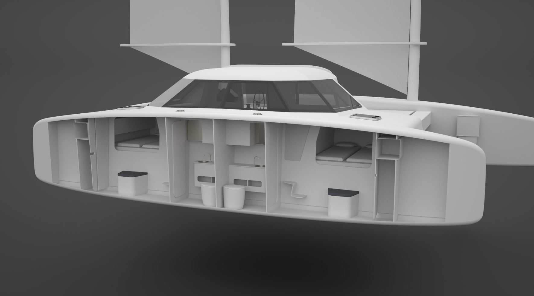

    I just meant this picture as an example of a rectangular hull, like what you mean also.
    I think the big problem is going to be point loads like hitting a sharp rock. You will need to make the outer fiberglass shell thicker than with H80 foam. Of course you can also repair damage but that is problematic and possibly risky. There is also hydraulic erosion if you don't notice it. So I've mostly resigned myself to paying for proper foam for the hull and structural elements. Everything near or below the waterline. Or maybe build out of wood.
    But for the large "tiny house" I want to put on top of my solar power trimaran I'm still looking for the ultimate solution.
