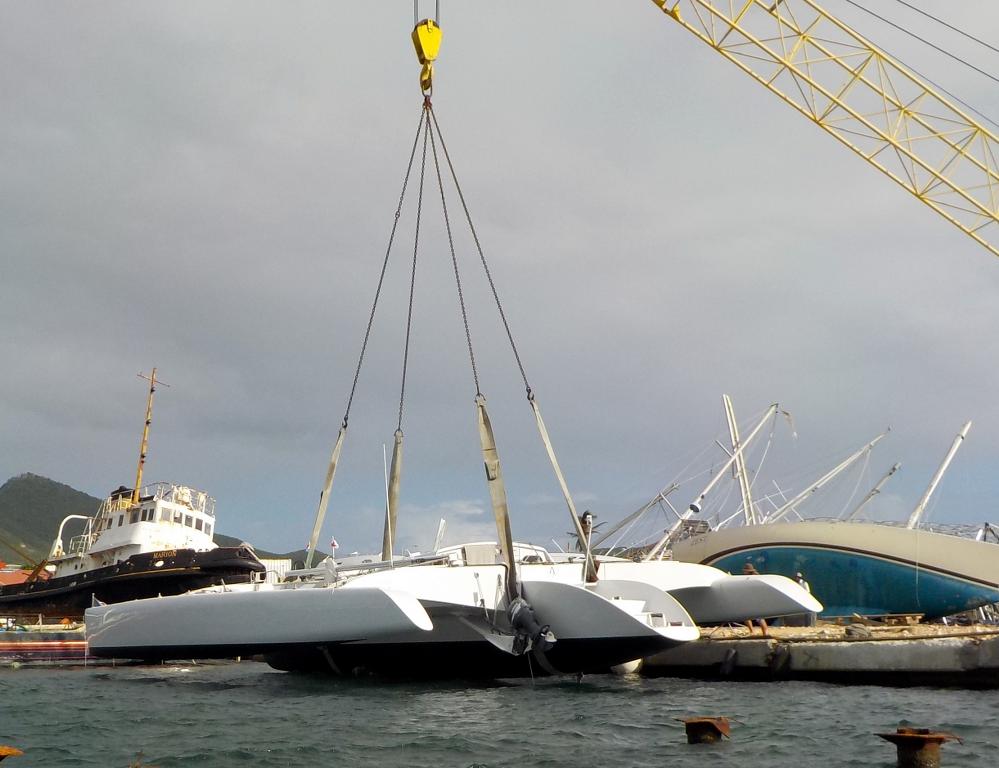

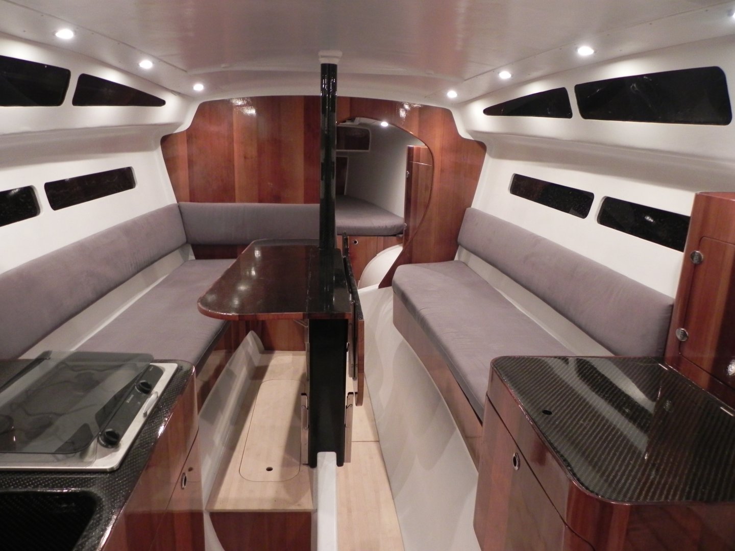

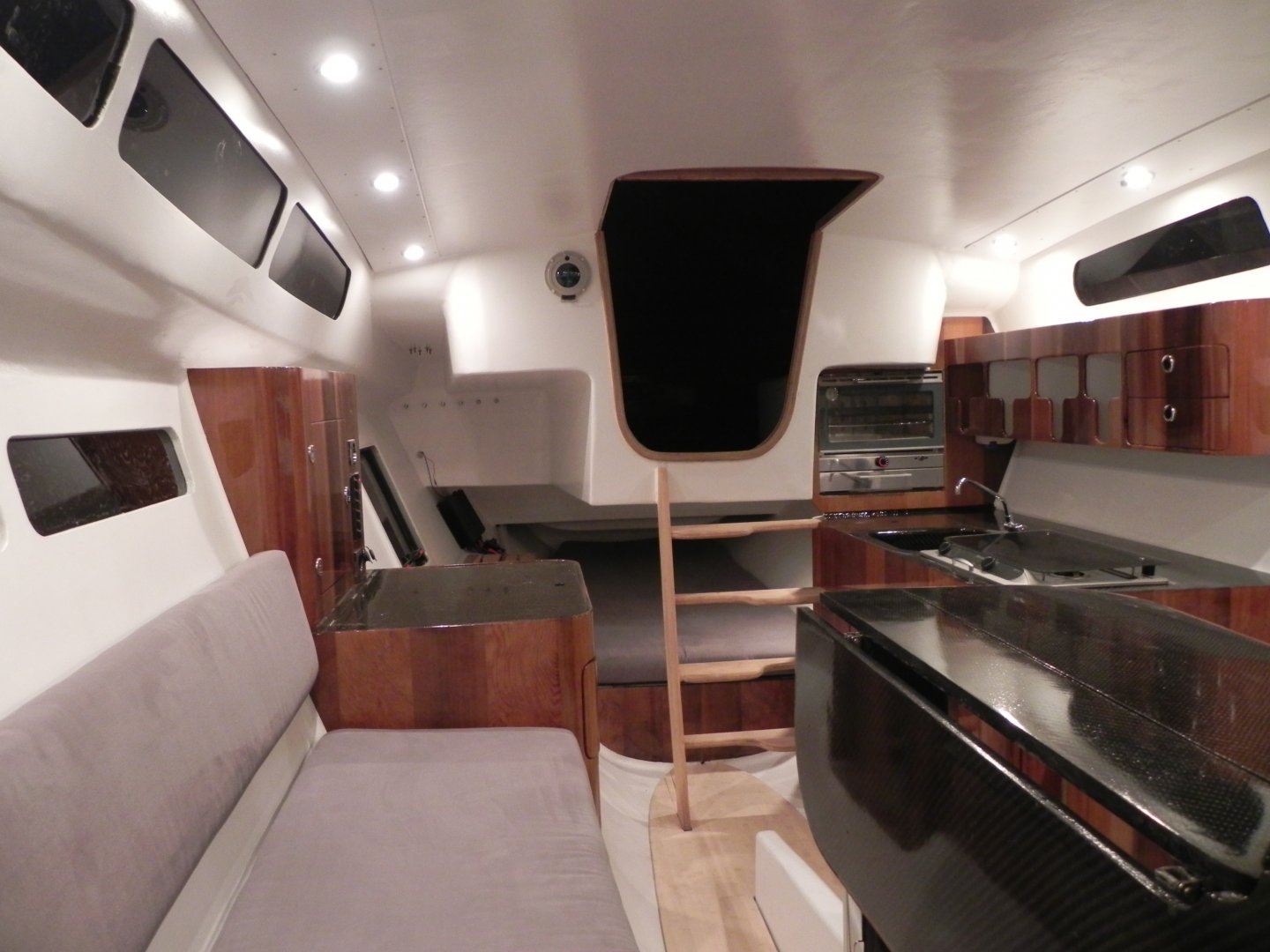

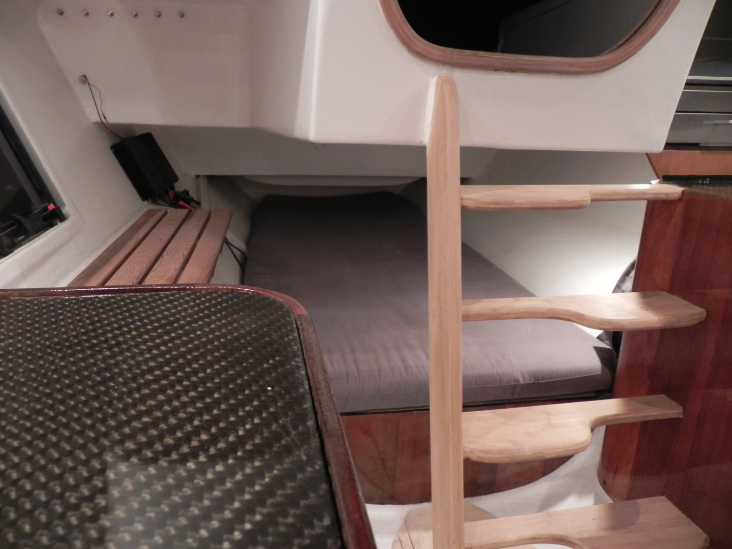

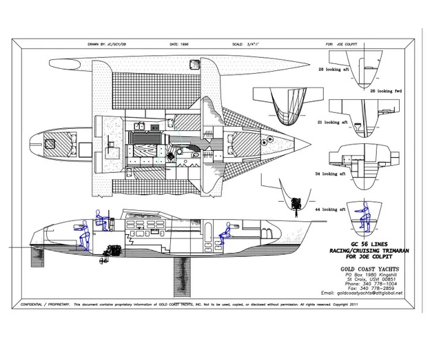

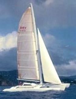

    The Gold Coast 56 Trimaran “Virgin Fire” is the sixth vessel of veteran multihull ocean racer Joe Colpitt. The tri is 56 x 36 foot with a shell build weight of 14,000 lbs and displaces at full load 25,000 lbs. The normal payload is 4,000 lbs. The 72 foot rotating wing mast carries 1530 square foot of sail. The rig is a 3/4 rig with integral spreaders and rotators and Harken mast track for system C cars. It sits on a custom Teflon/stainless steel mast rotation cup and ball base. It has a Metalmast boom with outhaul car, tack hooks and three reef sheaves. Standing rigging is Norseman using Dyform SS wire terminating with Norseman fittings, turnbuckles and toggles to SS chainplates. All running rigging is Samson Dyneema to keep it light.
    The tri was built in 1996 in St.Croix by Gold Coast Yachts as a racer-cruiser. The tri has a Bruce number of 1.62 this is fast. How fast, Virgin Fire has proven capable of sailing one and a half times wind speed in most conditions with just her working sails. She climbs to windward at 80% of wind speed and has consistently won racing events.
    Construction of the hulls, decks, bridge decks, roof, cabin sides and cockpit are built of Corecell foam, glass and CPD epoxy resin using resin infusion and vacuum-bag processes. All primary structural components and amenities were built with West System construction methods. Interior has West System epoxy products and were painted with semi-gloss Awlgrip, teak trim varnished. The exterior of the tri is painted with Awlgrip Polyurethane paint systems.
    Virgin Fire was built for racing, but is set up for serious long-distance passage-making with 5 big spaces to sleep, private cabins, dinette and a galley with lots of working space. Her interior is simple, spacious, and functional with the structure built to knock off the miles with great safety and comfort.
    Virgin Fire with Finn (53 foot) and the Chris White Hammerhead 54 (54 foot) all have the same characteristics; they have reasonable accommodation and are very fast under working sail. Owners of big French cats may have accommodation but they would not understand just how fast and easily handled in a seaway these cruiser racer tris are. They do not depend on engines for maneuvering these tris can be sailed in light to strong winds upwind and down.

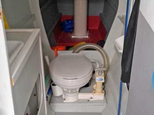

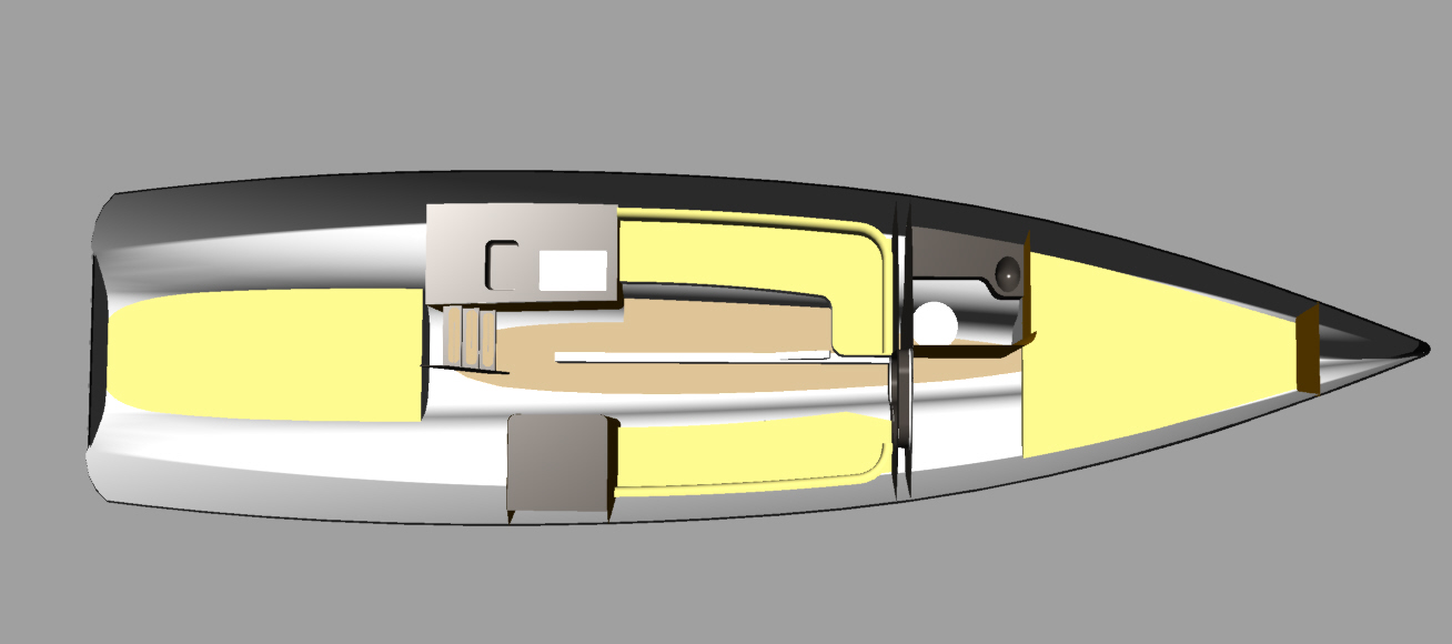

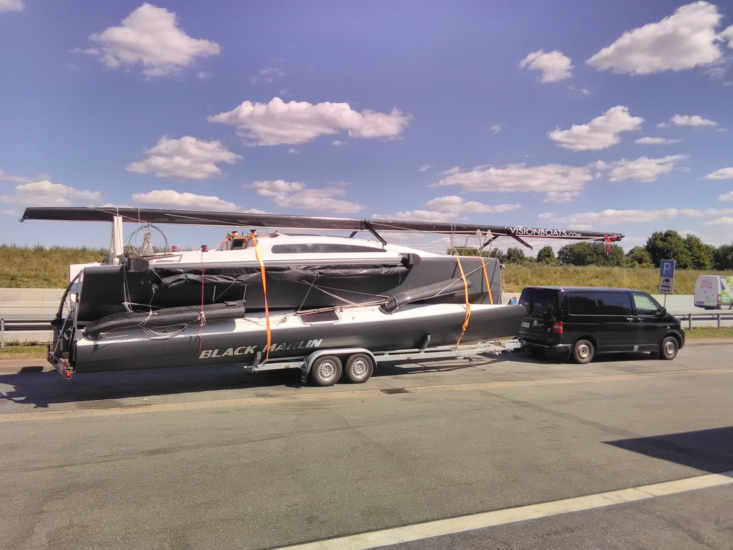

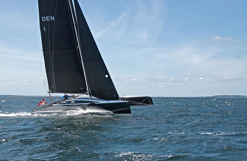

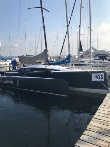

    Jan Andersen designed and built Black Marlin, a tri of 32.3 x 26 foot with a main hull 31 foot long for himself. The boat can be folded to 11.5 foot or disassembled to 8.2 foot wide for transport. It displacing 3280 lbs ready for sailing without crew. The 50 foot high, 42 square foot self built carbon fibre wing mast that weighs 140 lbs carries a 495 square foot main, 215 square foot jib, 420 code 0 and 915 square foot genneker.
    Jan wanted a fast fun cruiser racer to replace his 30 foot race winning light WRC glass tri Barracuda. Black Marlin has several design improvements of better construction, a one meter taller mast, more sail area, more width, better foils, taller and narrower floats. This floats allow Black Marlin to sail better in heavy weather but heels slightly more, but the floats also allow the tri to push into light airs better compared to Barracuda. The boat can cruise at 12 to 13 knots and has peaked at 26 knots so far. Black Marlin can go upwind at 40 degrees. Result of all this, demand by other people to produce “Black Marlins” for them. Also, as Black Marlin is a swing wing tri, Jan has consulted with Dragonfly about their trimarans.
    The original “Home Built” version took 18 months including making his own mast. The hulls are built in molds and are carbon fibre infused epoxy on foam with PRO-SET epoxy, which belongs to the professional part of West-System. It is made with biaxial carbon fiber to produce high stiffness and lower weight. The carbon fiber mast use UD - Uni Directional (fiber in one direction only) and limited biax carbon fibre. Even the main cabin table and parts of the interior is built in Carbon Fibre with veneers to provide a finish. The racing versions has rudders on floats, cruising version has a rudder on main hull.
    This is one very fast cruiser racer designed and built by a man who has good boat building experience. His use of female moulded hulls simplifies the surface finishing and I think probably made the build faster. Sorry I do not have more detail on the build but the idea and result is very good.

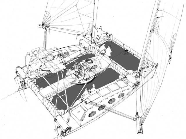

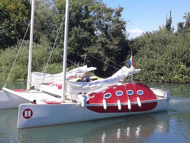

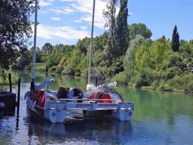

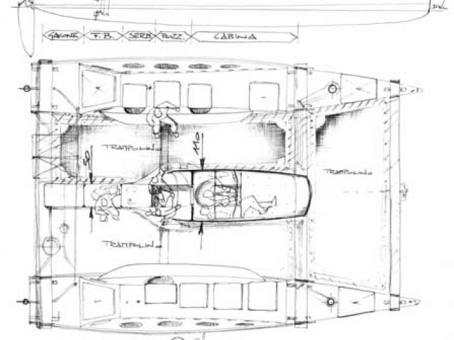

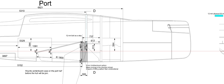

    Fabrovich designed an excellent 6 meter tortured plywood cat featured on page 7 of this thread. The Fabrovich cat featured here is the 9 meter, that is a cat of 29.5 x 20 foot weighing 2910 lbs carrying 667 square foot of sail with each sail in the biplane rig measuring 333 square foot. The 2 biplane 36 foot of deck free standing masts are 200 mm diameter at the deck base. The performance information is limited, but a video shows it sailing well in moderate conditions.
    The hulls are built of tortured Okume plywood (guess 6 mm ply in hulls) with stringer and plywood bulkhead support. As you will read in his smaller design (in the attached word document) he joined the keel lines together poured in bog, glassed the keels at a predetermined angle and tortured the hulls into shape around the bulkheads. The original design had aluminium tube cross beams but this version is built with box (guess) timber ply cross beams. The centre pod is a tortured ply construction and can accommodate a single berth in front of a covered area and cockpit for sailing. The hulls are 5 foot wide at the gunnel level. The accommodation has 2 double berths, 2 single berths a galley, dinette and loo.
    The cat is demountable (not easily trailable) for transport to new locations. A 9.9 hp outboard powers the boat and ground tackle of 15 kg CQR and 15 KG Danforth anchors each has 25 meter of 8 mm chain with 150 foot of rope keep the cat stopped. The cat has 2 by 100 litre water tanks and a 70 litres fuel tank.
    I have included the word build document of the 6 meter (20 foot) version of the cat, as this boat would have been very similar in design and construction of the hulls rig etc. The 9 meter is a big transportable, relatively easy to build, useful cruising cat that could go long distances with minimal effort. Interesting design.

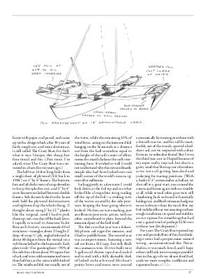

    This is about a man who entered a race around Victoria Harbour Canada in 1984 to win $100. The race is associated with the Swiftsure event. The only requirement, you had to prove that the entire boat cost $100 to enter the race. So, what fine vessel did he build? A foil stabilised canoe. The tri is 16 x 18 foot wide. With 90 square foot of polytarp sail on a wooden mast.
    The canoe construction was a sheet of plywood 16 x 4 foot tortured in shape with 50 x 100 mm timber for frames and cross beams. The cross beams were lashed onto the “framing” in the main hull and foils. The foils were 12 mm plywood, semicircular shape, 3 foot long by 2 feet deep. The foils are angled at 60 degrees which end up at 45 degrees when the tri heels. When the boat sails the centre of effort of sail line goes through the centre of “lift” of the foils so the tri heels to a certain point then heels no more. This means increased sail force means more speed if the hull and rig can take it.
    This fine vessel won after his third attempt due to stronger winds which allowed him to sail faster than other but blew the top of his sail apart. The first 2 jpegs show the concept, sorry about the words but I am respecting the original authors rights.
    The foil stabilised trimaran concept has been tried for years after a gentleman called Edmund Bruce popularised the concept in the AYRS booklets. Some samples of the types of tri’s are shown in the jpegs. Sabrina 1 and 2 is from NZ and worked relatively well under many conditions including NZ version of a light sailing day. Holtham foil stabilised tri was the first commercial version of the concept, very few were sold. The 35 foot tri is Joe Dobler Australian built version that eventually ended up in Europe and still can be chartered. The final jpeg attempts to explain the concept.

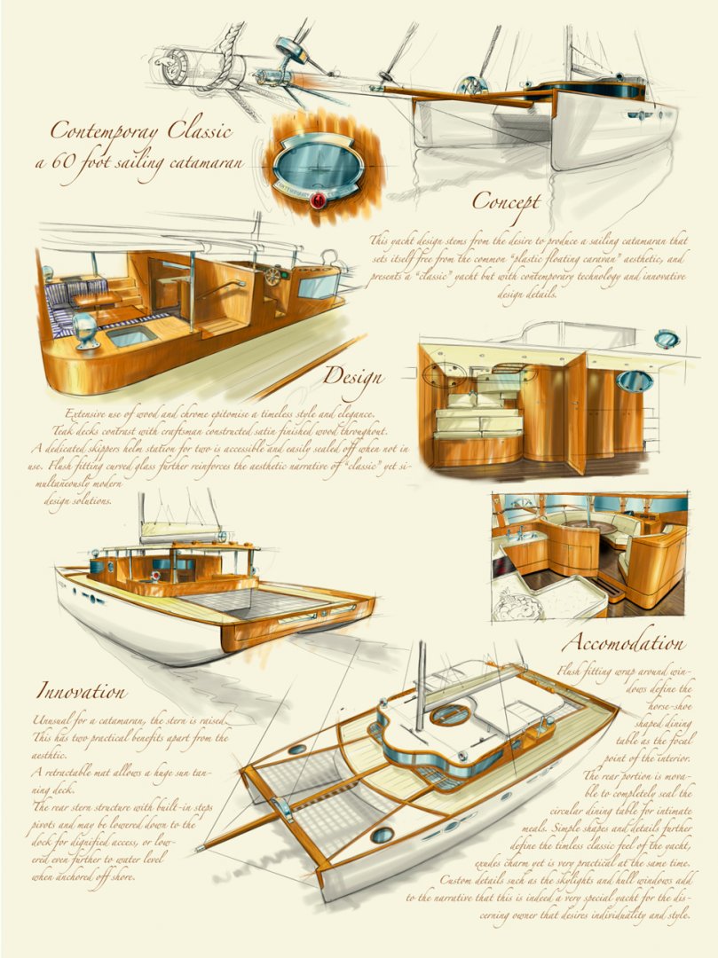

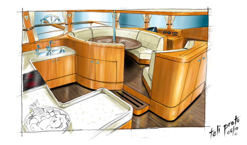

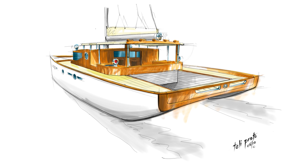

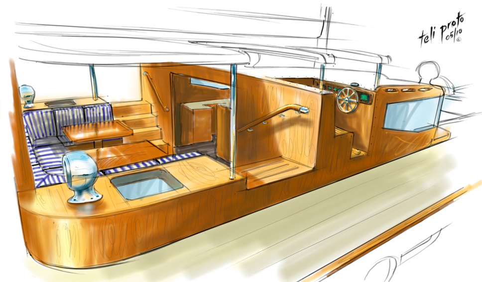

    In 2017 the Millennium Yacht Design Awards were presented with a special mention (1 of 8 given out) given to the following cat. Details beyond its 60 foot length are unknown as this cat is about style and grace with some functionality. It’s basically a design study by a design company that does older style house interiors etc.
    The award winning Contemporary Classic 60 foot cat design is for those who want classic styling in their modern 60 foot cat. This design stems from the desire to have a sailing catamaran that is free from the common “plastic floating caravan” aesthetics. Extensive use of wood and chrome epitomise a timeless style and elegance. Flush fitting curved glass surrounded by wood is ‘classic’ and unusually for a catamaran, the stern is raised as in classic old yachts.
    The rear stern structure has built-in steps, which pivot at the touch of a button to lower the steps down to the jetty or water level for a more dignified boat access. Careful floor deck height manipulation results in perfect sight lines from the outside seating area with visibility all around yet maintaining a secure and comfortable space for guests. The two large sliding glass doors retract into the sides for unimpeded visual and physical access to the interior.
    The dining table is the focal point of the interior. The rear portion is movable to completely seal the dining table for intimate meals. The port side has a fully equipped galley. The starboard side has an internal chart table and the boat can be helmed from the comfort of the saloon. Custom details such as the skylights and hull windows add to the narrative that this is indeed a very special yacht for the discerning owner that desires individuality and style.
    The jpegs show it all. I would not recommend the hull shape and short waterline or the potential displacement unless it had a lot of very thin veneers on foam carbon fibre everything. But as I said it’s a design study to attract interest.
