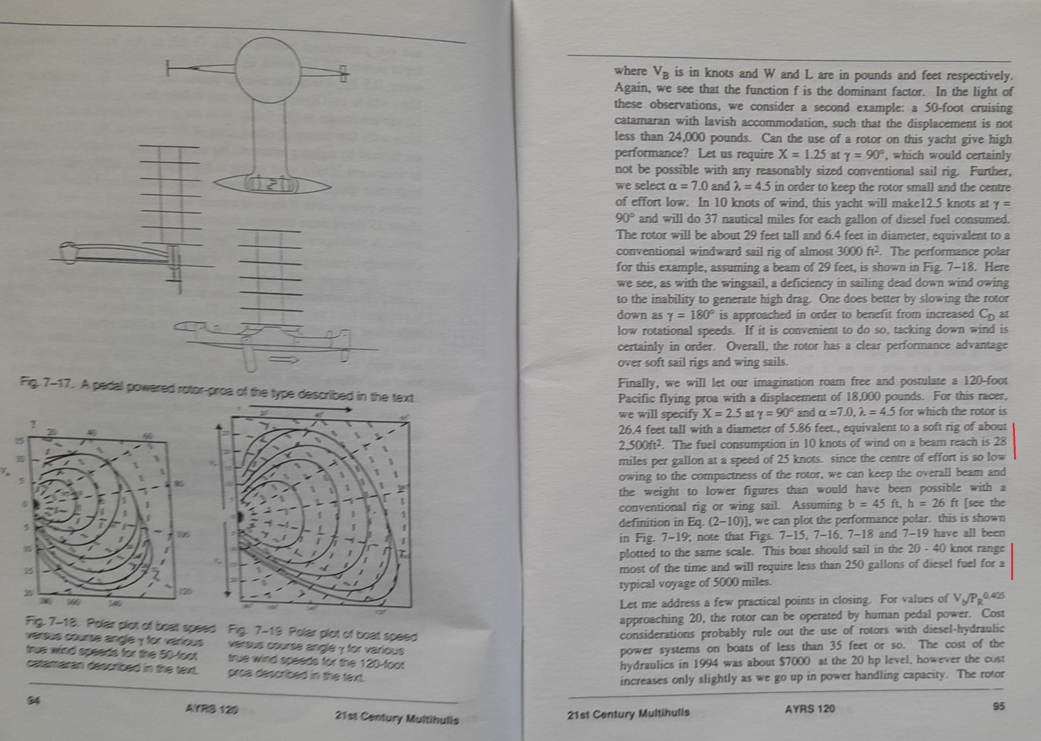

Proa = smaller spiral?
I'm going to say no. Vertical turbines have no directionality with respect to incident wind, so when powered, all they'd do is create general turbulence. I doubt if they'd work well even if you modified one to feather its blades for best lift in your desired direction.snip

Savonius started out on this route around the same time as Flettner and made a boat with his vertical axis rotors that drove using Magnus effect (picture below). There are a couple of limitations with this though. First it is not easy to reverse the direction of rotation of a Savonius rotor without complex mechanisms. Secondly because they are drag devices they will only rotate with the surface moving slower than the apparent wind and this will not get near to the circumferential velocity/windspeed ratios that give the best performance.Could a large anemometer effectively spin a flettner rotor? Someone must have tried, but I can’t find it.
Edit- the pic finally decided to upload so I could see the whole thing. Thanks! Maybe Google garbled the translation, but the Architect seems to have tried the idea of using the wind to rotate the column? (Or engine?) by separating the halves of the FR column, and letting them rotate (around what?), which developed more power? Sounds like a anemometer approach with two cups that extended the length of the column? Or did they power a propellor? Try Google translate on the article. If I got it right, Flettner was interested in the idea?Savonius started out on this route around the same time as Flettner and made a boat with his vertical axis rotors that drove using Magnus effect (picture below). There are a couple of limitations with this though. First it is not easy to reverse the direction of rotation of a Savonius rotor without complex mechanisms. Secondly because they are drag devices they will only rotate with the surface moving slower than the apparent wind and this will not get near to the circumferential velocity/windspeed ratios that give the best performance.
