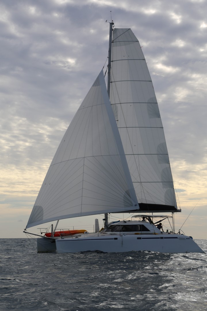

    Hey Corley. I just got new sails and went max size on everything for better performance and do not regret it. I very much do care about performance. There was no way I would get a smaller main on my existing rig, I went bigger. Its lighter than the last one so easier to raise. Just putting a smaller main on does nothing to increase foretriangle size. So no sail area would be traded. Just making the whole rig or main smaller does nothing to equalize sail area, and does nothing to bring extra sail area to easy to unroll headsails.
    I am also not pushing a stance at all either. My hypothetical idea was for a hypothetical version of my boat/rig. Where sail area stays the same as now by way of moving the mast back a bit for ease of use and pretty similar the same outright performance, but easier cruising performance.
    Some people in this thread have been trying to say more headsail and less main actually has BETTER outright performance. I also do not believe it. But I explained why the cruising speeds would be higher in many cases, and why this setup does not have to be inherently low performance. Even if it might be a bit slower to windward in light wind, it would be equal or better in higher wind thanks to a higher aspect main and smaller jib designed for high wind upwind work compared to a partially furled genoa. Yes there would be air drag from the additional large masthead genoa.
    What I am saying is the base rig would be similar to a shrunk down version of what you might see on something like this. Made smaller so that it all fits on the boat with no pole, and the code zero just being a very large foresail on a real furler. Of course then you could also have a pole for hipo sails as well, which I would want. :D I don't think this idea is new or special in anyway. I just think it might be a good way to go for cruising boats even if they do care about performance.

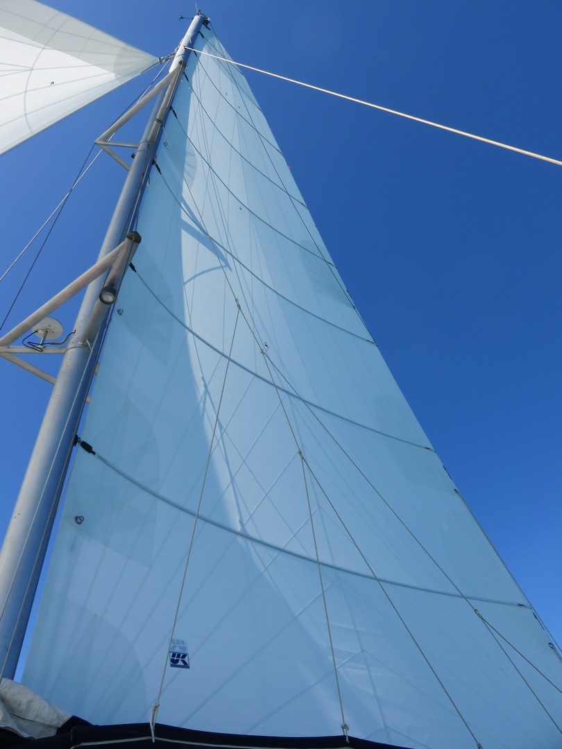

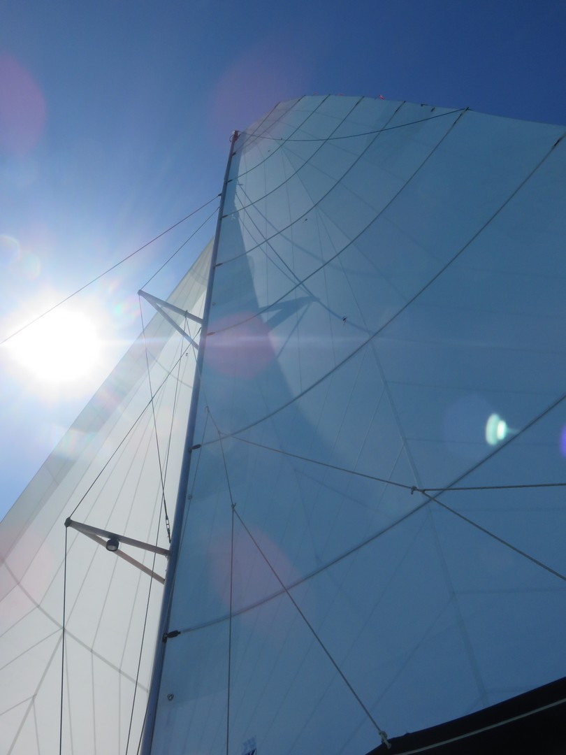

    Gday CT249. I thought you meant the leach would be too tight thanks to there being effective vanging just from the weight of a heavy boom even with the sheet fairly loose? IE the angle of attack of the head would be too high for optimal performance. The opposite of your picture.
    Then you go on to say the opposite, that in a reach the head will be doing nothing because it would twist off so far? You sound like you know what you are talking about so can you please tell me what I am not understanding? Is this a high wind/low wind prob. Where in light wind you have problem one, and in heavy wind the sail stretches and there is no appropriate traveler system/vang and you get problem 2?
    My boat, a crowther 226A has an overbuilt rig that would make some charter cats look small. Bit of a disappointment really, but at least I know its strong.
    My sails are cruise lam and I certainly have no prob preventing the head from falling away, but as you say perhaps in very light wind the is not enough wind pressure to lift the boom to apply enough twist.
    I'm still learning to use this sail, and well really sail this boat in general. Its my first large multi and I have only done maybe 2000 miles. I don't have a vang even though there are attachment points for it. They seem redundant on cats these days. I would much prefer the boom to sweep the cabin top (one complaint I have is access to the stack pack).
    Seems the almost full width traveler, and then 4:1 preventer do the job of vanging without the enormous loads of a vang. Perhaps the boom could have been much lighter if the vang was ruled out? When sailing I am always playing with main trim. I have no highly experienced trimmers to give me tips, so its all just what I think I know from sailing pinheads. Mainly trial and error. I am always moving the main up and down by adjusting the traveler and sheet to suit. Often I see gains in boat speed at odds to what I might be seeing from the telltails by what appears to be oversheeting the head. But its clear the twist of the sail has big effects on performance. It also seems to give a weather helm more easily.
    These pics are on the first hoist of the sail (the ones without the screecher up). You can see it hits the shrouds easily so IMO the head has to be tighter than optimal for performance sometimes just to prevent damage. With the screecher we can create enough apparent wind which solves the issue mostly, unless its really light.

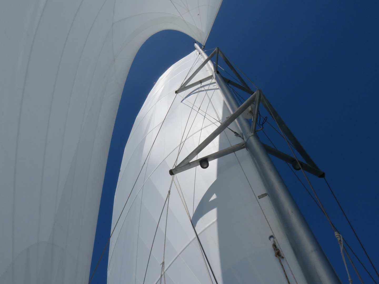

    Take a look at the pic of my screecher and where the genoa is. Obviously if you unfurled the whole genoa out at the same time, all that it would do is slow the boat down due to too much interference. But the pole is long enough that I thought with a half rolled out genoa it might add to speed, but I have been unable to get more speed yet. But I have only tried once or twice. I think the shape of the 2 headsails must be similar for best results.
