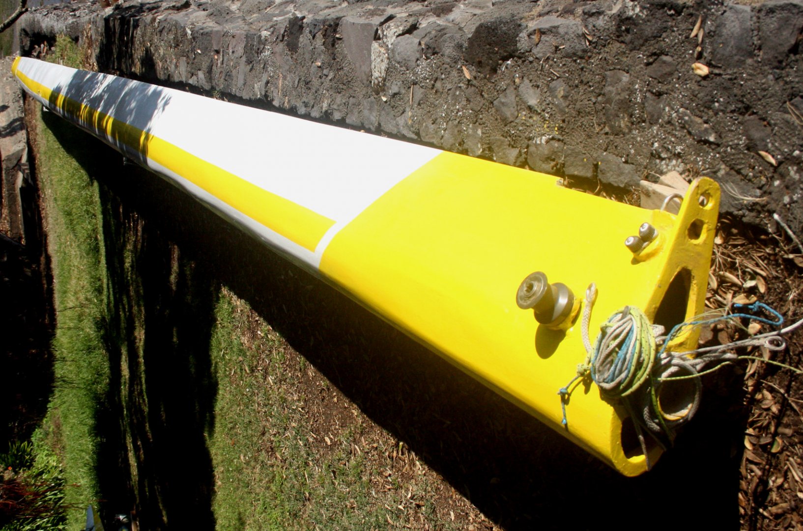

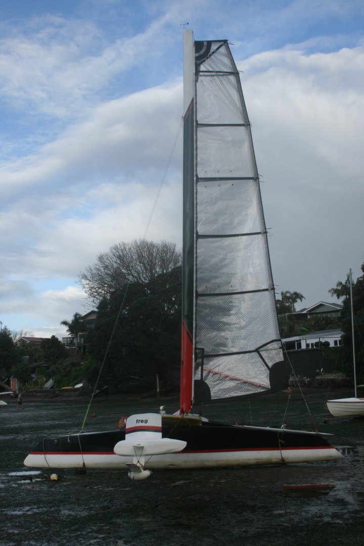

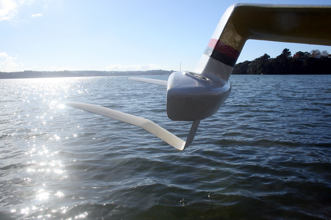

    Testing Frog, some good, some not so good but getting the thing sorted. Had to increase foil length, not enough lift before. And here's the new Bill Barry double luff main.

    Gary how’s the double luff main looking ? this idea really interests me

    Looks and sets fine. I don't attach the batten ends and the two main leeches are only connected at the boom/clew position. Thought this might be dangerous, meaning that when gybing with the wind getting into the sail before swinging across, there might be problems but so far, no problems. The leeches have to move because the windward sail sets shorter on the boom (if you can understand what I mean). The D mast rotation seems to be much the same (actually a little less) as normal teardrop cross section wing, meaning it has to rotate 45 degrees when sailing to windward. I can't get any decent photographs when sailing because the boat is so cramped and small; need someone in a powerboat alongside.

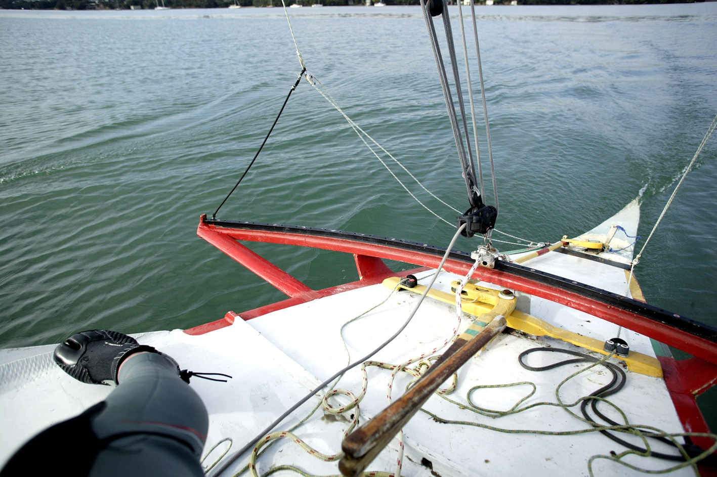

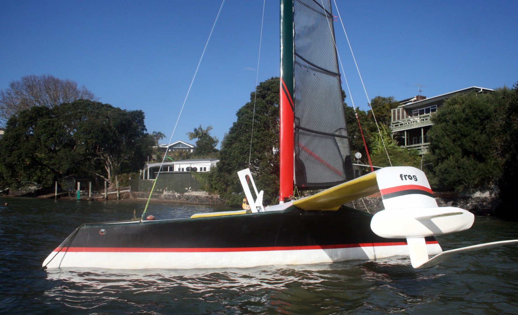

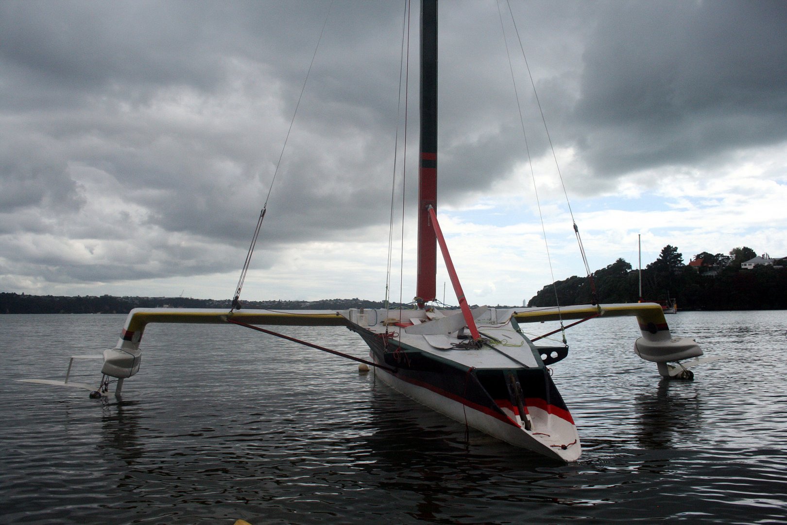

    Extended stern so Frog is now 7 metres length, also had to add diagonals from shroud bases to main hull after damaging the cantilever beam/hull section at the hard point, plus extending the lower float foils and adding a brace to stop flexing. The upper foil never, well, very rarely touches water. Slowly figuring the Frog out; taken a while though.

    The treatment you've done to your stern , the scoop, is almost identical to what I am considering doing to my Trem, , except your finish looks perfectly faired, and the paint professional [one day], and i'll move the rudder back so I can beach and drag. Have you noticed a difference in performance that can be attributed to the dieters sugar scoop? It looks like it belongs, is it functional, does it really add a little speed, buoyancy and better sea keeping?

    Added it because I have maybe an unhealthy fixation anti- dragging sterns - and the extra half metre length and slightly lifted exit area has cleaned up the wake. If there is no turbulence there in light airs then have convinced myself the boat is faster. Maybe delusional. Here's the light airs wake of my late lamented Sid (smashed in storm while moored). There is very little rocker in my boat designs, hence the stern extensions.
