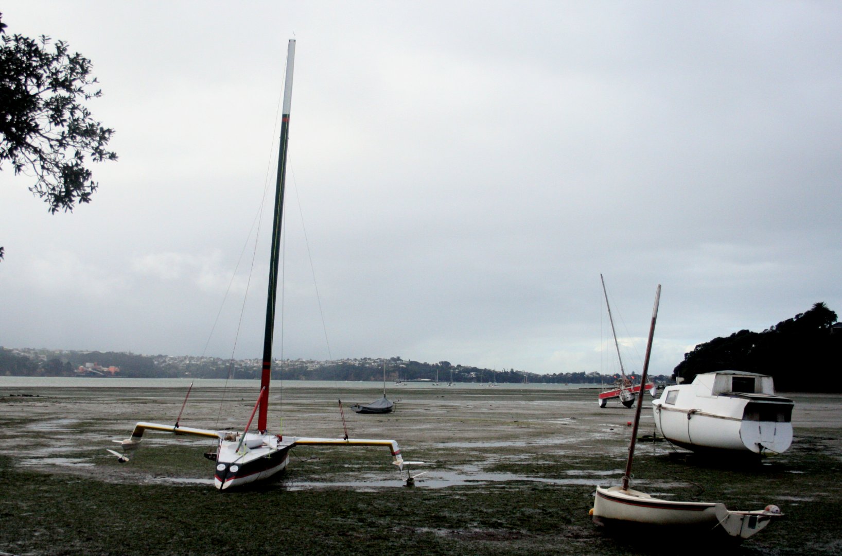

    Frog has been stationary for some time because I've been fooling around with the Cox's Bay Skimmer. Also lowered Sid's mast a couple of days before the 45- 50 knots directly onshore, no protection wind blasts hit last weekend. Pleased I did because mast would have come down for sure.

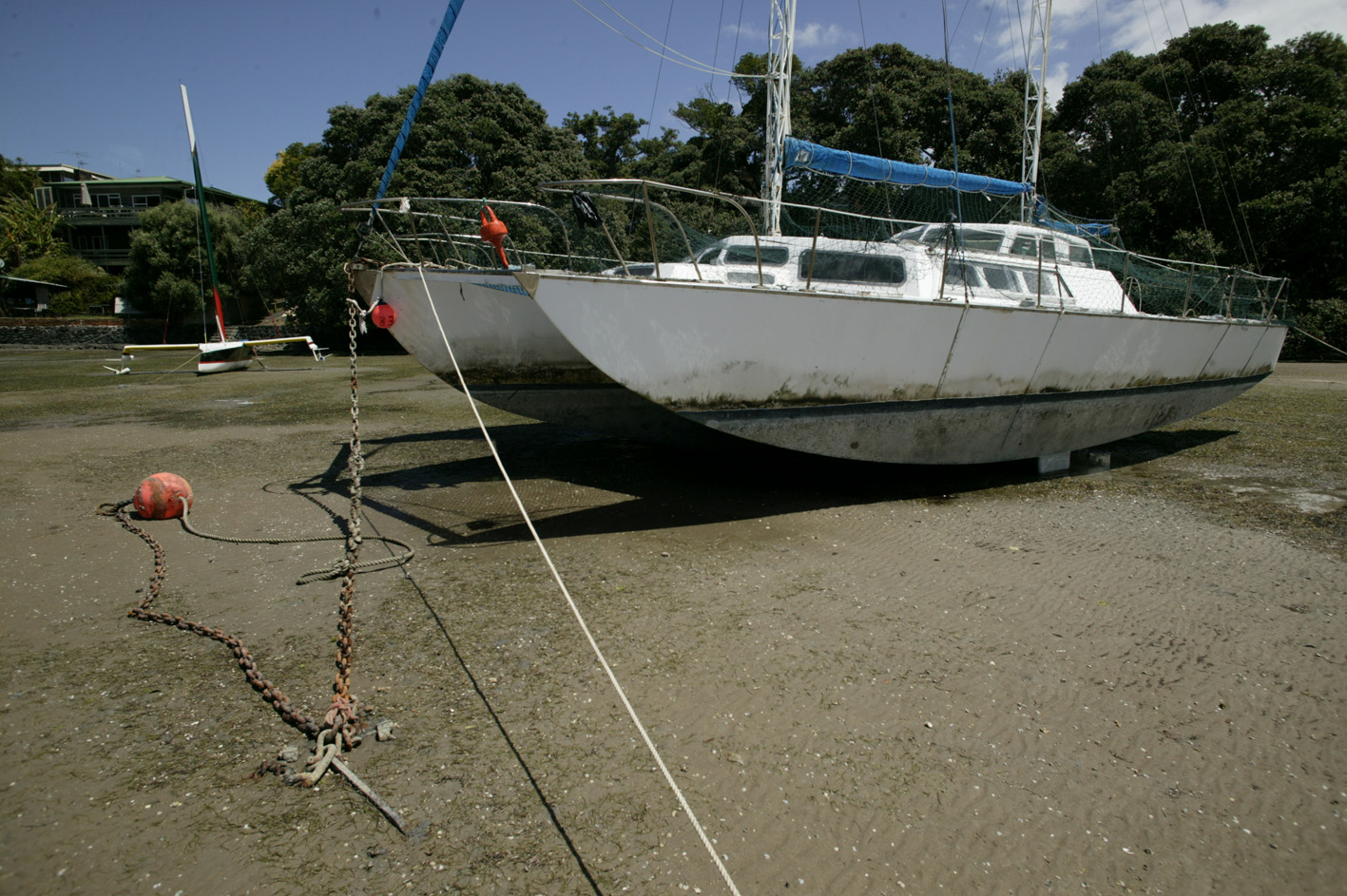

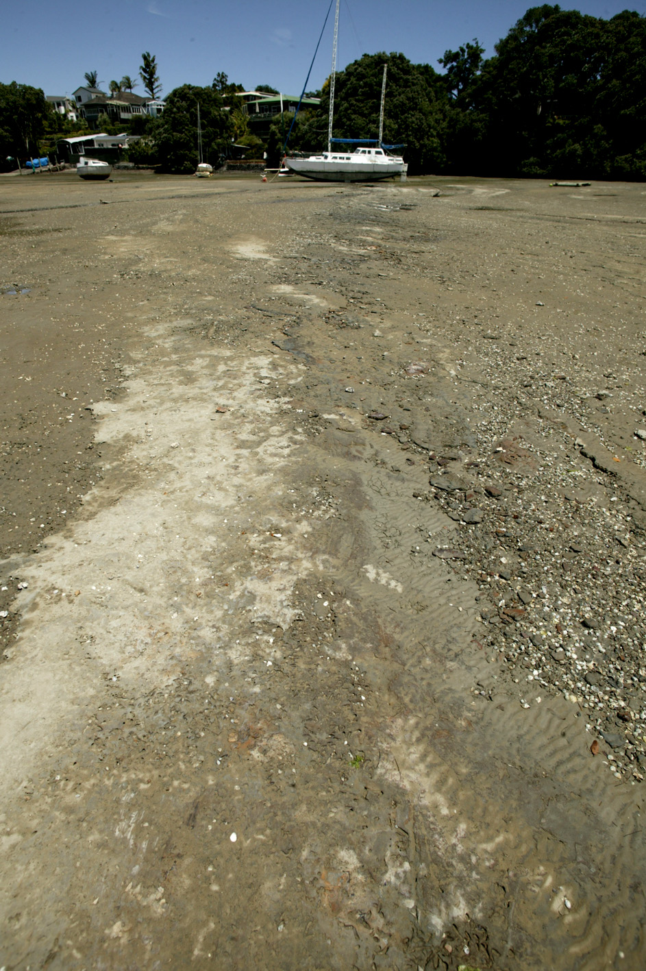

    Also had a somewhat unwelcome big Piver visitor (broken mooring chain) into the bay; a few more metres (lucky that we were having low 2.8 metre tides) and it would have skittled Frog and a number of boats, not to mention its own destruction against sea wall. Second shot shows the drag trail of the float fins on the papa rock.

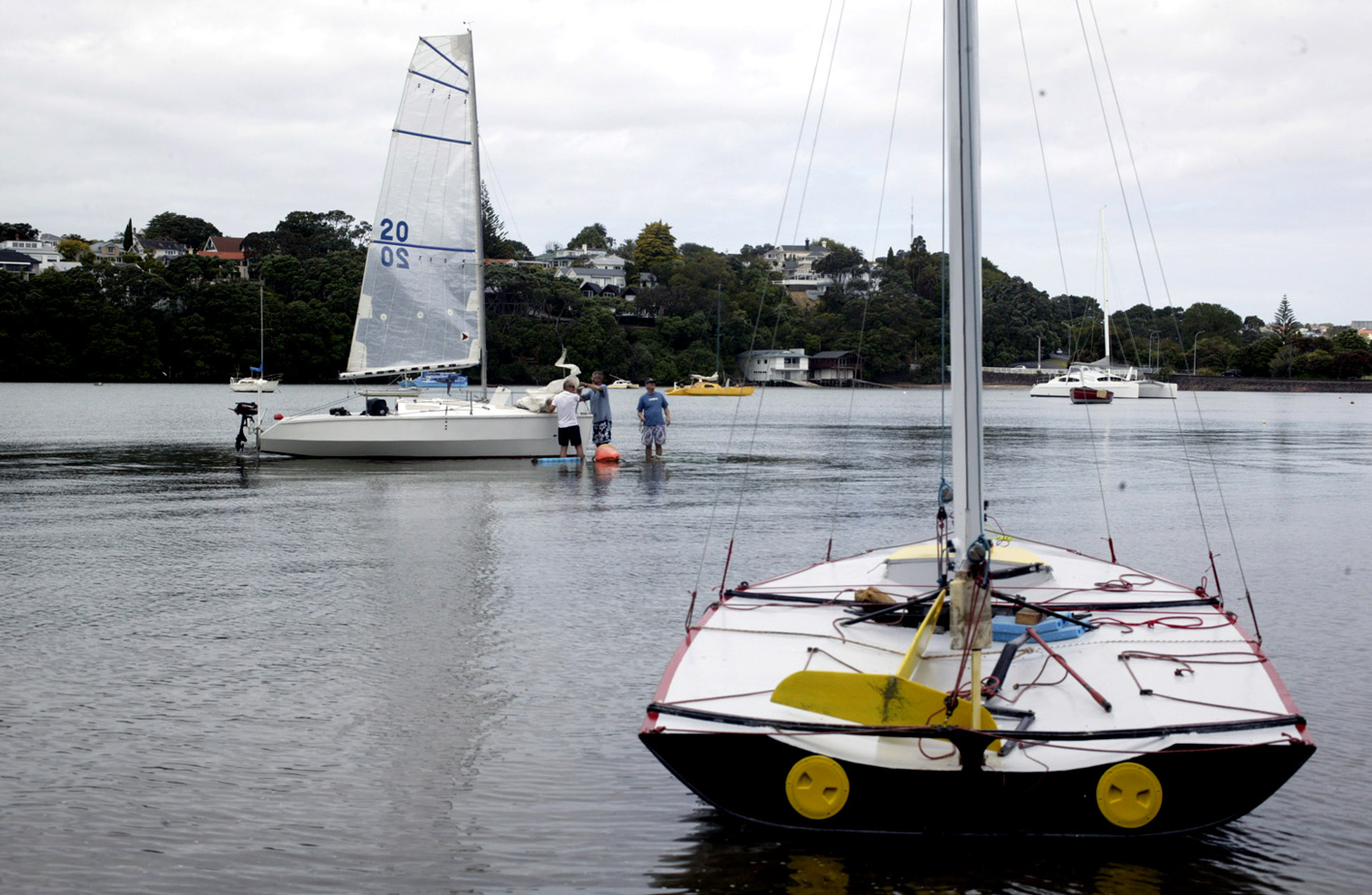

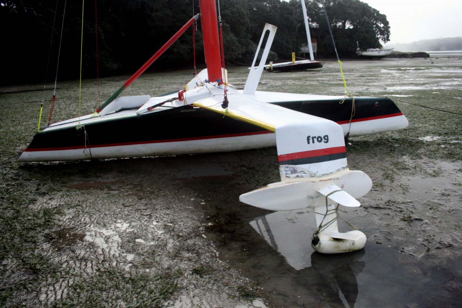

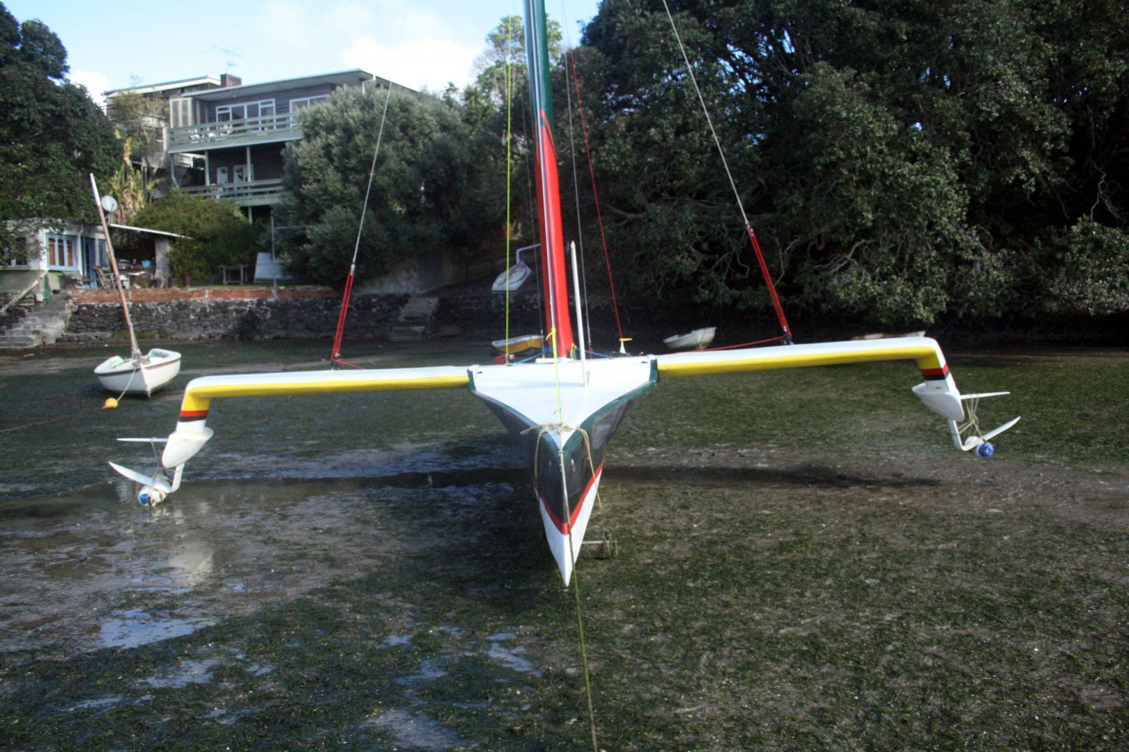

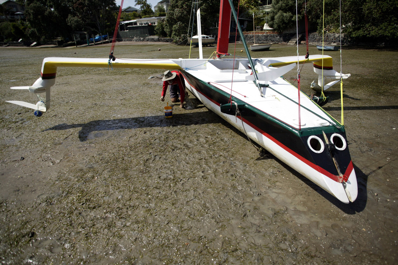

    Here's another shot of Frog. Had to extend the tiny floats; not enough buoyancy - but need to increase volume even more - will do it later. At the moment I've lashed a tubular fender each side below the low foils. Otherwise the platform nearly tips over in strong winds. The idea (how brilliant?) was that once moving the foils would create lift - doesn't work so well when stationary though.

    No and seriously I think when I get my a. into g. will build slightly larger and set lower floats - so the upper foil exits at halfway depth mark of the float. So if overpowered the foil will solidify the heeling position. That's the theory anyway.

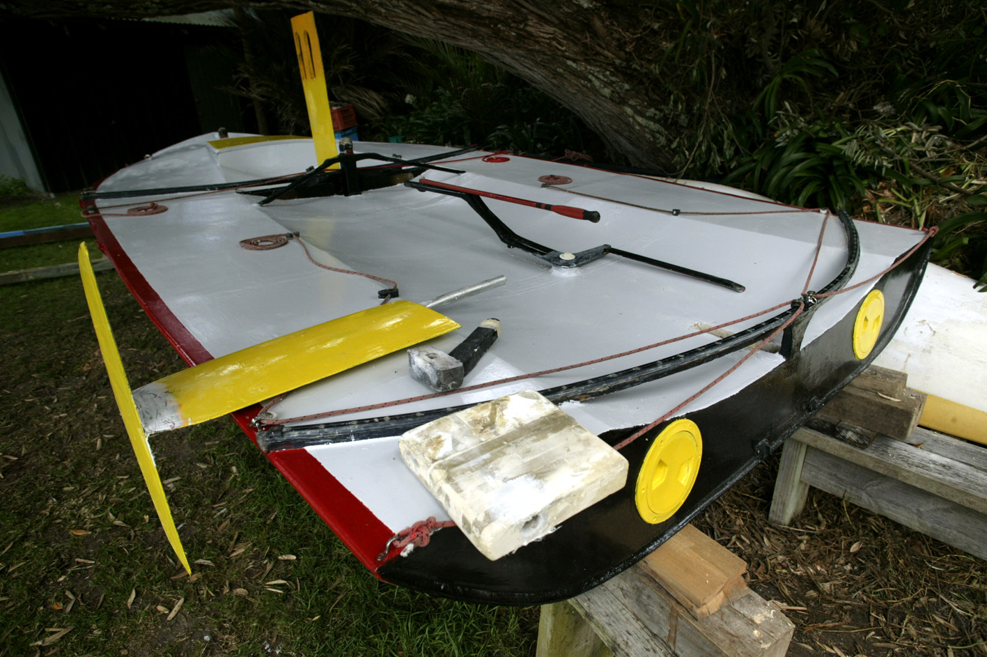

    Chopped off the old and fitted new and enlarged (relatively speaking of course) mini floats to Frog; they are set lower to WL too. Bit of paint and maybe I can bodgey up a sail (Flash Harry's old main) to fit one of the D mast tracks; will give a rough indication how the water reptile will sail. Giving thought to how the new double luff main will be designed.

    Gary, I am just curious : did you provided any mean to tune the foils AoA (e.g. rotating the whole wing beam), or are they fixed ?
    If not, I assume you aim to control pitch attitude using the rear rudder foil ?
  13. Gary Baigent
    Joined: Jul 2005
    Posts: 3,009
    Location: auckland nz
    Gary Baigent Senior Member
    I could rotate the main beam to alter foil attack angles, pack leading or trailing section of the central box. But when sailing would be fixed. But then again, you could rig a mechanism to move the beam when underway too. At the moment the lower and main foils are at 3 degrees and the uppers double that. The upper foils are meant to be the safety oh sheet fail/safe parts of the Frog. However I've found with my other foilers that once moving the main foils lock into the water. If Frog works okay I can later add more refinements to foil angle control. The rudder T is at zero AoA. But Frog is a small boat and you could shift weight forward or aft to alter that as well.
