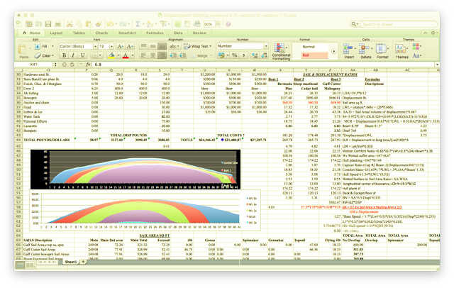

    I use a chart in a spreadsheet to smooth any high or low spots in the waterlines buttocks and diagonals Tables of Offsets. It can show any high or low spots of +- 1/16 of an inch without any problem. You can smooth out anything less than that with a batten and plane or sander on the molds before planking.

    Any tool is good if it is used correctly and you are aware of its limitations. If Excel charts work for you, great. But let me doubt that the precision of these graphics is sufficient for a correct smoothing of the shapes of a boat of more than 6 m (to give a figure). That goes totally against the precision that every loftman has always wanted to give to his lines. In the same picture you can see areas that do not seem very smooth. As I say, if they are worth it to you, there is nothing more to say.
    What a correct smoothing attempts is precisely to avoid "... a batten and plane or sander on the molds before planking" which is a much more expensive job than doing it on lines drawn on a board or with a CAD / CAM program.

    I should have written:
    in the Line Drawings of the Waterlines, Buttocks, and Diagonals for the Tables of Offsets.
    I just use the SS to make sure that I am not to far off in the Table of Offsets.
    There are some other errors in the spreadsheets, tables of offsets, and line drawings... that I haven't corrected. Maybe the yard could correct these errors and send them to my office in a Change Order to the original bid.
    Thanks for setting the record straight.
    prabs,
    Make a set of line drawings and table of offsets then do them again and again improving them a little each time.
    Doing the tables of offsets in a Spreadsheet will save you from redoing all of the inputs, like a savable scratch pad, if you are not using a CAD / CAM program.
