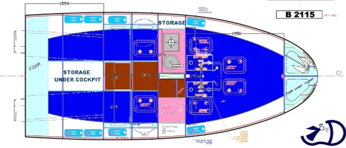

Interior of a small sailboat cabin—British-inspired, after a lifetime of both enjoying and enduring French designs that, as I see in 2026, have followed the same path since 1964.
"Scow"
C: Large Queen-sized bed; c1–c4: clothing stored behind canvas; the large bed features an area with huge cushions for lounging—half-sitting, half-reclining
B: An area offering the immense luxury of hanging clothes on hangers, with storage underneath
A: A 240 x 60 cm surface serving a triple function: it is the large chart table, the navigator's berth, and the spot where the portable stove sits. And, of course, there is no sink; naturally, Eric and Susan Hiscock had no sink inside the cabin of "Wanderer III", let alone "Wanderer II"

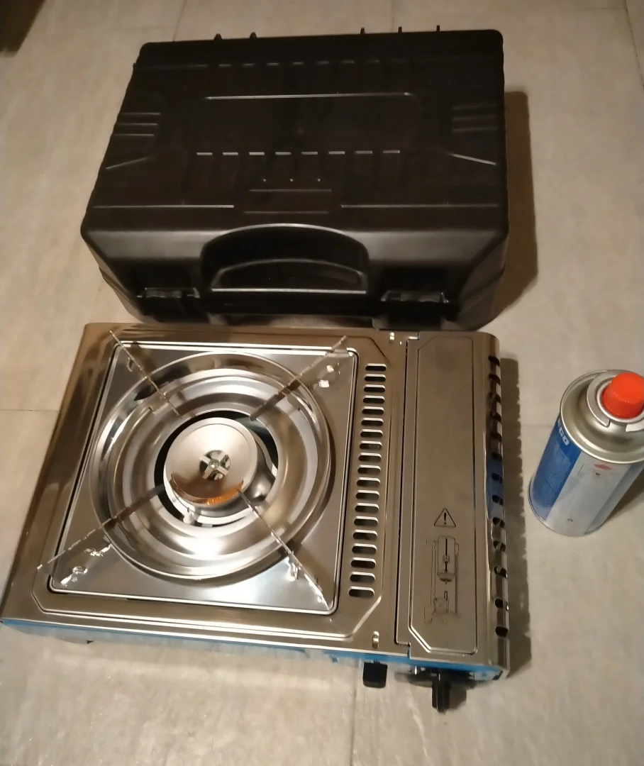

This is the portable gas stove I use on my old Mini Transat (luckily, I pay 1,400 euros a year for a berth that includes water and electricity)
I also use it at home on the terrace
I mean a real stove, not a Jetboil
I also have an alcohol stove that I don't use. I used to think that being a true adventurer meant needing an alcohol stove—haha. The alcohol flame is alluring, but impractical.
If my new Mini Transat ever becomes a reality, I’m currently considering an portable electric induction cooktop.

(typical layout)
Let’s look at the advantages of this proposed design compared to the typical layout found in small sailboats:
+ We gain a well-ventilated spot for the galley, located right next to one of the two cabin entrance hatches
+ We eliminate the inconvenience of the centerboard trunk and those typical tiny cabinets that usually obstruct easy passage—features often found where the forward berth was originally designed only for small children
+ You can enter while soaking wet, sit facing the bow, and remove your wet clothes without getting the bed wet
+ We gain a deep, protected, comfortable, and safe cockpit—a huge asset on a small sailboat
+ We gain a proper, civilized cockpit bathroom complete with a toilet and bidet
+ We get good cockpit storage space; it is essential to keep the cabin from turning into a dumping ground for gear.

What is impractical (actually insane) is carrying canisters of pressurised explosive fuel made from light gauge electroplated steel on any boat. If you must use propane or butane a regularly tested, hot dip galvanised and domed pressure vessel is a minimum requirement. However most craft stop burning when they sink. I will stick with ethanol and take a bit longer to boil the kettle.
Carlos has probably never been to a hospital burn unit. Neither have I.
There have been many accidents involving monohulls due to gas physics.
All charter boats keep their gas cylinders in an insulated compartment, which reduces the risk—but doesn't eliminate it.
