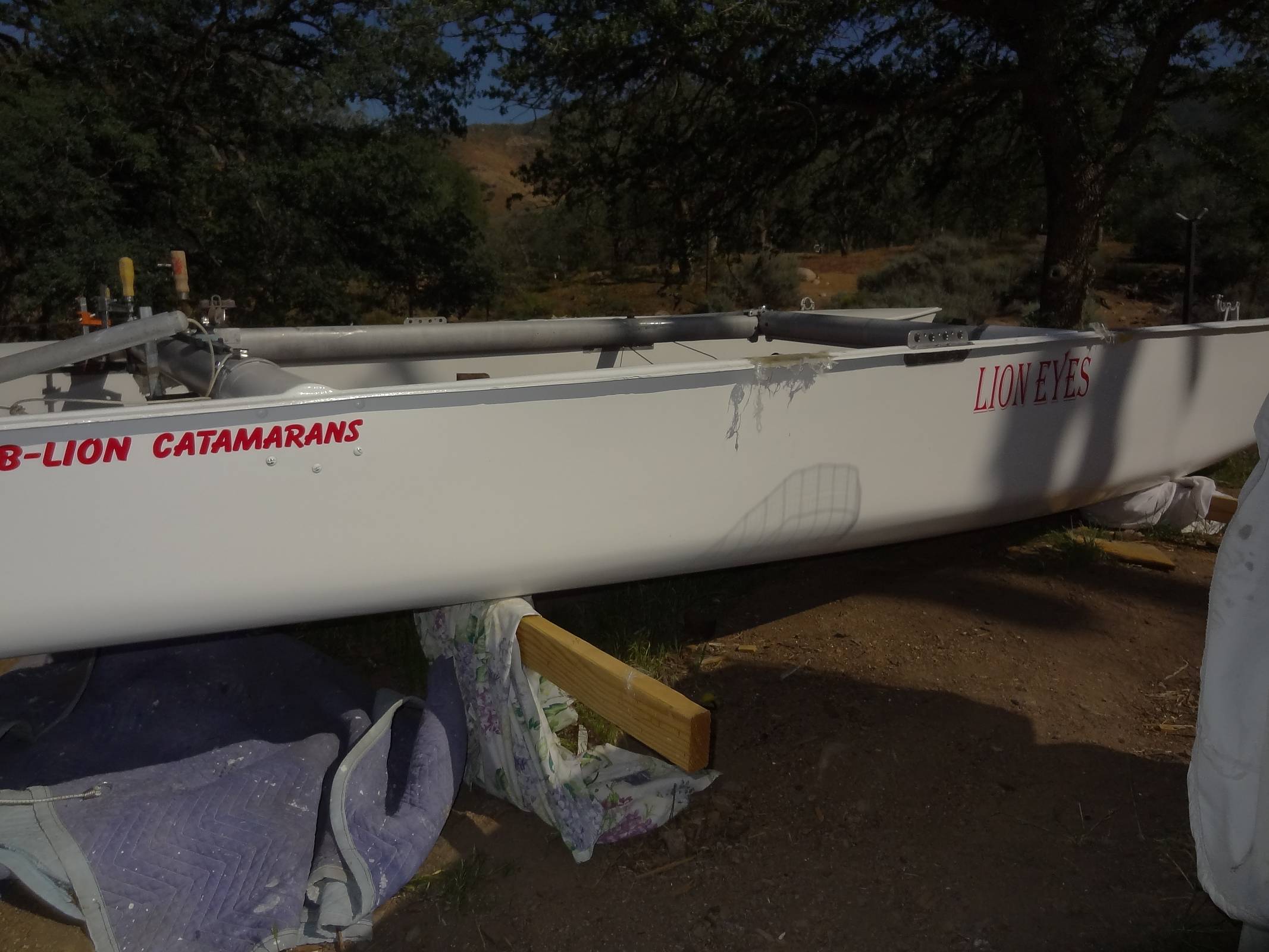

Tom: the answer to your questions are: yes I know the designer....good friend and a mentor...his name is Dave Hubbard of Stamford CT ...he and his brother were the top designer in the early 60s Jerry retired but Dave is still quite active as he designed tell wingmast on Oracle the Americas Cup cat.....COOL yes?
The boat was originally designed for home building which made it very affordable to the public...later it was built by American Fiberglass of Norwalk CT....then later by NcNair Boats of Deep River CT ....later the Tornado cat came out and that was the end of the breed....sad! Today Tornado cat would cost a sailor $25K !!! Not for the average Sailor by a long shot! Recently , I spoke to Dave Hubbard but he did not have the plans any more so I sent him a set for his records. I however, as you suggested thought it would be great if the class could be recreated and updated to be competitive as MATERIALS available have changed. So I have modified a original hull to create a advanced design based on the original concept for homebuilders. I will take a picture of it as it sits in the College Classroom where I and my class in Composite Engineering have constructed it. ALSO , I have Sail Set if you do not and if you were closer, I have a Spare Trailer for a B-Lion
Give me a call so we can talk ....Norman
