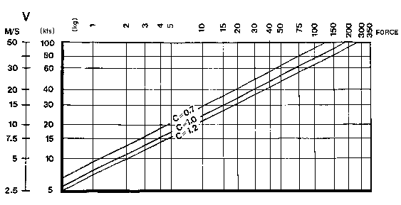

    now we're all good friends again, tell me this, i can't relate this picture to ricks explanation.
    i can't reconcile this chart with the newtons calculated per m2 @ 5ms.
    the chart was Kg force 1 m flat square sail perpendicular to the wind

  14. Guest625101138
    Guest625101138 Previous Member
    Mal
    The graph gives force various values of Cd for downwind condition at various windspeed. It provides values of Cd for the second equation I provided:
    Drag Force = 0.5 x rho x V^2 x Cd x Area (In line with the apparent wind)
    For example at 15m/s and C = 1, the force is 15kgf. Using the equation:
    Force = .5 x 1.2 x 225 x 1 = 135N = 13.8kgf
    A little different. Air density is a function of temperature so within the accuracy of the chart without temperature being specified.

  15. MikeJohns
    Joined: Aug 2004
    Posts: 3,192
    Likes: 210, Points: 63, Legacy Rep: 2054
    MikeJohns Senior Member
    All the SI formula for wind-force will give N/m^2
    When you see kg shown as a force it just shows that someone used a mass conversion table forgetting that lb-force actually converts to Newtons NOT to kilograms.
    This confusion of units is a problem. Otherwise well founded material from institutes like Westlawn and Dave Gerr unfortunately perpetuate this because they don't understand the SI system. As soon as you are given kg as a force you must convert it to Newtons for it to be of any use. So it’s a confusing and backwards effort to talk of kg for force .
