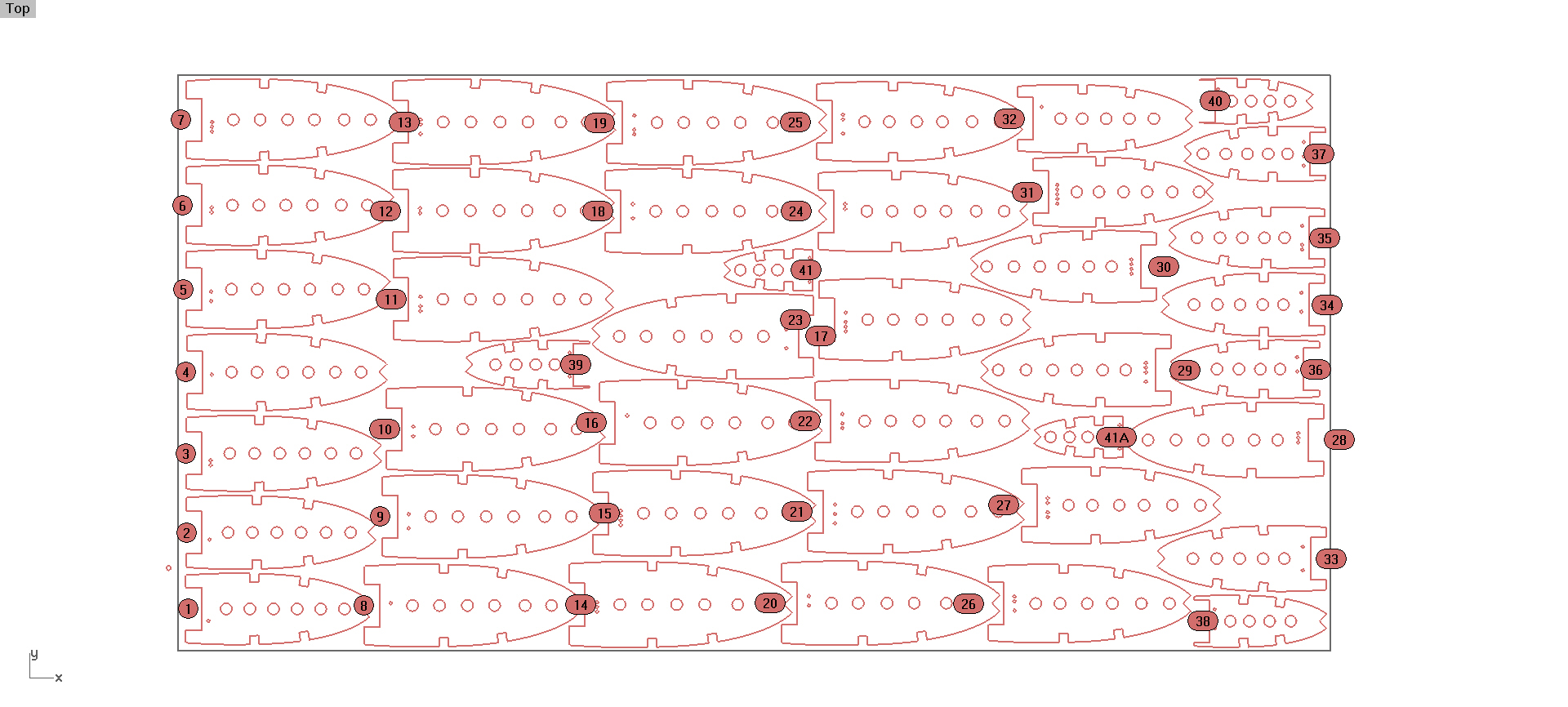

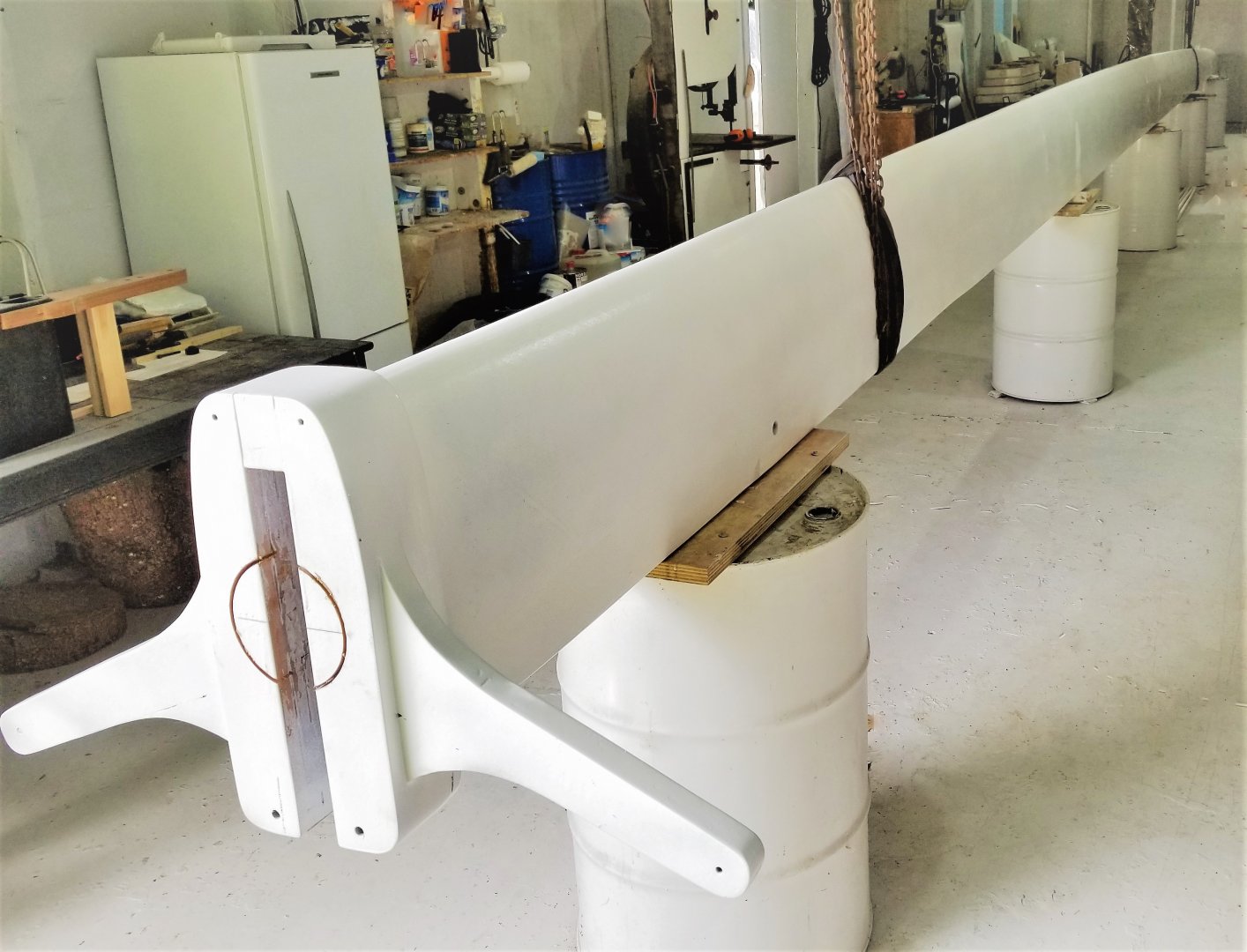

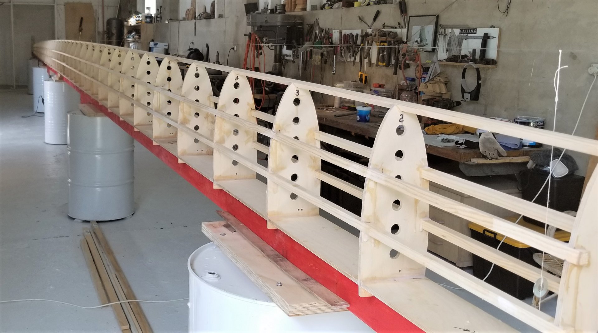

  10. MichaelRoberts
    Joined: Sep 2015
    Posts: 82
    Likes: 26, Points: 8, Legacy Rep: 16
    MichaelRoberts Archimedes
    Maybe this will help/inspire
    About six layers of uni and bi-ax carbon on 1.5 mm aircraft ply bent over ribs and stringers
    The mast is slightly fatter in the middle then tapers to the top
    All ribs generated by Rhino and CNC cut - they fit on one sheet of ply
    Many years of engineering went into this 20 metre rotating wing
    Many thanks to people on this forum plus A J Marchaj and Frank Bethwaite
