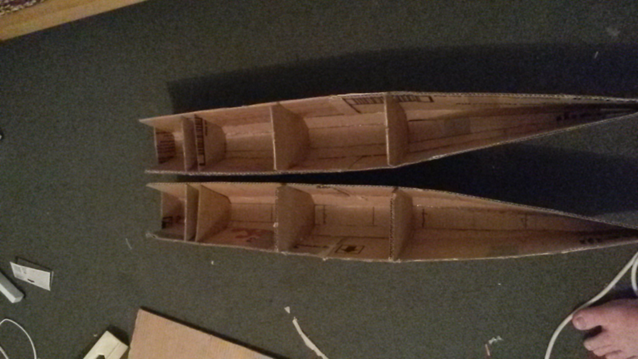

    Second build of model
    Ok heres the start of the second attempt after my sister threw my first attempt out after I left the model there when I was house sitting. After seeing that I had Posted Iso..... model and commented on it on my FB page she felt I didnt need it any more.
    Anyway just started it 2 days ago so a bit to go. I am building it to Leons specks regarding lwl and bulkhead sizes. I am yet to decided if I am going to do bridge deck at 700 or 800 above water line. The rear two bulkheads are not attached yet and I havent added the other bulkheads yet. The rear double bulkhead will take the stern beam that will be glued and bolted between these two bulkheads to provide extra stength and stiffness. They will be spaced the width of the rear beam and themselves made into a female mold to receive the bulkhead.
    This is just the start so that you can see I serious about the build. Looking at Iso.... model Im thinking that 30 to 35 ft may ve fine. I have grabbed many build ideas from many other designs whos build videos and blogs I have fastidiously watched and taken detailed notes and plans from. My wife reckons I should open a library with the amount of note books I have filled with design ideas. But now I am slowly implementing what I feel suits my buid the best and seeing if it works. Its a 1:10 model I am going to bog up and paint so my wife can see what the finished thing will look like.
    Now thats said on the many many blogs and build videos Ive seen of boats made with ply, from 6mm to 10mm hull sheets one thing seems constant to me. That is that for every 1000mm there will be a bulkhead. And in a few some builders have added a couple more. O this includes full and partial bulkheads. Now while I know this adds weight and in some cases a few builders have gone over the top adding say 3extra bulkheads shouldnt be an issue if Ive worked it out right or am I completely wrong? Also this is in boats outa ply not glass planked or balsa.
    Heres the start any input is good in put at this stage

    Model looks good. The wobbly bits will come out when the deck goes on.
    What is the waterline beam and draft of the hulls (ie, no keels)?
    Single chine, flat bottom is easier, roomier and has more payload. Looks ordinary while it is being built, but once launched, only you will know.
    Bulkhead spacing depends on location, ply thickness/stiffness, panel height, furniture, compound curvature and number and thickness of stringers. Some ply boats have 3m between bulkheads, others half a metre.
    Not sure if you are going to build it like the model with fillets to join the panels, but if you are, think long and hard about the order of set up. At worst, you have 2 x 4 x 35' = 280' of filleting and taping, on your knees, working backwards, just for the chines.
    If you use stringers, it's easier, but they need planing, then a fastening every 150mm or so. Half of them can be clamped, but that still leaves 280 screws or boat nails (aka rot starters).

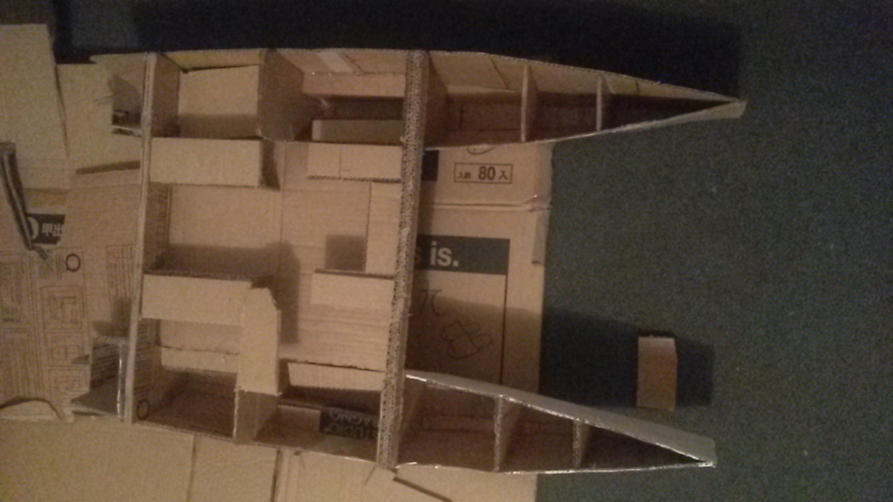

    Decided on a few things input needed
    ok so kick up rudder on transom, is this so hard I thought easier then through hull Im avoiding as much through hull as possable. No daggerboard internally a kickup board on outside of hull between bridge deck with snap pin if hits anything. Flat bottom with small keels for handling but still run up on beach. This gives me an extra 200mm at the floor as well as no need for bilge.
    Still at this stage using ply but after long discussions with many here and a shout out to Rob Denney or his help behind the scene that may or may not change. But Rob has given me the confidence to build a mast carbon glass should be cool.
    Heres a Pic of the internal layout B$ I to cabin top on model. The starboard hull got a little wet so is wonky but Ill fix that before I finish it. Starboard will be owners cab with floor and step to bed with cockpit seat offset for extra space. the port will be just double bed port seat closer to hull center. Port birth just a bit of baord sitting so not cut to size yet. the forward compartments in either hull, Port will be a birth starboard dunny and shower, I am not having lockers forward of the mast beam that area will be a deck with lockers on it at hull top just under beam. Havent worked out windless yet will do so soon. With there will of course be a fore beam. But thats where its at.
    As for saloon u can see where kitchen goes and approx orientation of the area still playing with it.:)
    By the way I havent added the half Bulkheads to the model as yet my bad>>>

    What is the engine place i suspect under these two rear seats?
    I can add more pictures.
