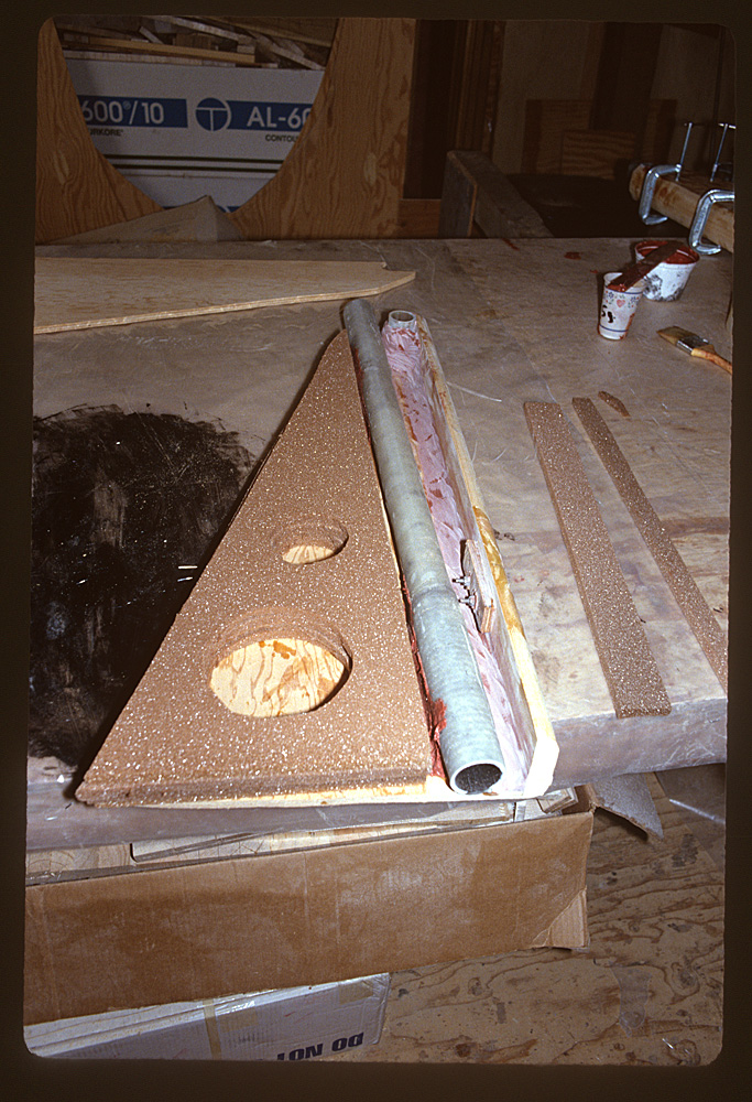

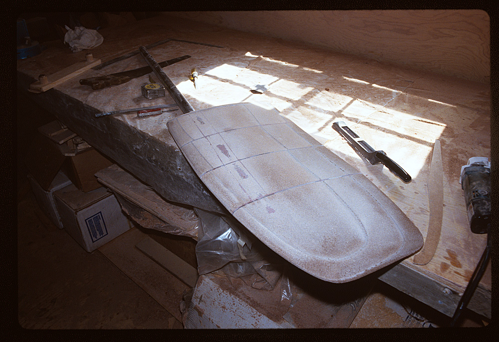

    A pic inside the cassette and the short rudder pre-glass. The blade was only about 3" short but the shaft inside the blade must have been close to 5" short of design. I can say it held up very well when the barge company that smashed the cat dragged it on the rudders, bending the shafts (where they exit at the bottom of the cassette) and breaking some of the glass. They held up very well despite the short shaft length within the blade. And the glass sleeve inside the cassette was embedded with glass fiber enhanced bog after this pic was taken.
