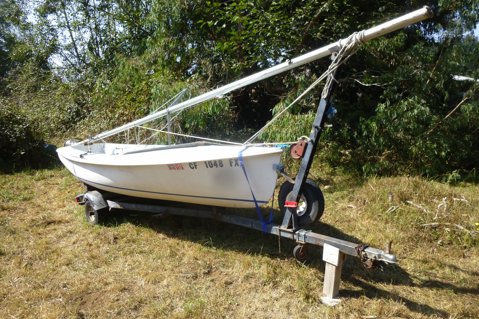

    Hello,
    I have appreciated this forum, especially the thread involving 5monkeys and canracer's repairs of this boat. I am now taking on my own repair of hull #553 which I recently took home.
    It seems to be in decent shape. I have removed the forward bulkhead. The tabbing of fiberglass tape had 'unglued' from the hull.
    I've included a few pictures from underneath. The foam is dry, the thin plywood on the underside of the floor is strong and dry,and the 'fin' of thin plywood going from centerboard trunk forward is a bit damp, but seems stable and strong still.
    The existing compression post seemed inadequate, as it was just a 1*4 piece of plywood screwed into one side of the 'fin' below and butted against the underside of the mast step.
    My current plan is to rebuild a stronger compression post, and I also want to add the secondary bulkheads mentioned on the C-15 tuning guide, which will be located under the chainplates.
    I will add more pictures, and I am hoping for some encouragement and advice along the way!

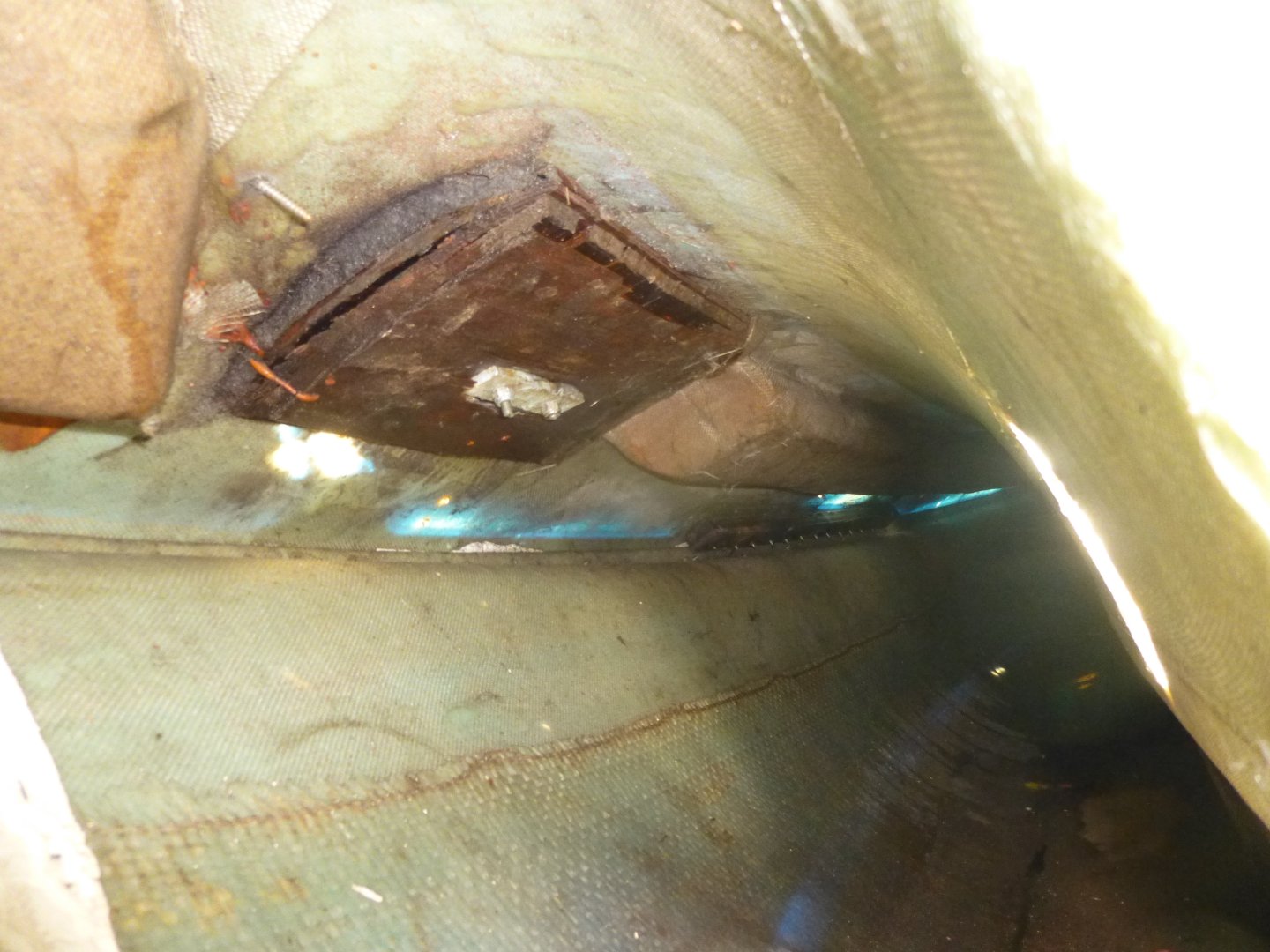

    Speaking of Chainplates, the wood backing plate is dry but I can break off small pieces from the edge, as though it is very old. I imagine it is still strong enough to keep the small metal backing plate from pulling through the fiberglass, as it is still able to distribute force just fine. I will add the picture as soon as it gets approved to my gallery.
    One more concern: the stiffening material which is built onto the inside bottom of the hull seems waterlogged. What is this material? Will it still provide stiffening if it is intact but waterlogged? If not, can it be replaced, or can I add stringers to the hull to make up for the soaked foam?
    Thank you in advance for any information or advice! I am still referring to the aforementioned thread, and exploring the dark insides of the boat.
    I removed one of the foam blocks today, and could remove the other. Is it okay to cut them in half to manage them better, will that make a difference? I believe I will be able to get inside the foredeck to affect some of these repairs.
    and here is the chainplate backing plate I mentioned. The wood is cohesive but aged, and I imagine it is plenty strong to distribute the forces onto the fiberglass on a wide area. P1040991.JPG

    Any waterlogged wood is useless.
    The stuff under the mast support and running forward on the keel line is plywood.
    You should replace it.
    Chain plates are fairly important, if the edges of the backing plate are crumbling, the whole thing is damaged and needs to be replaced. Seriously. The backing plates you show are really not good enough to spread the shroud load, that is why the secondary bulkheads are recommended and standard in the later boats.
    Cutting the loose foam in half won't matter a bit - it serves no purpose but to keep the boat afloat if it is completely swamped. Actually mine had additional foam inserted in the sides, under the seating deck. I have no idea if it was a good idea or just excessive caution, but the foam under the floor is not very much.
    Good luck.

    The deck & frames below look shot. You're probably going to have to:
    1. Cut the deck off.
    2. Measure new deck plate & framing wood.
    3. Remove old decking & framing.
    4. Replace with fresh material & bond with West 404 or equivalent structural filler. I recommend a layer or two of fiberglass around the wood and a very nice bead of West 404 around all structural connections to deck, hull and mated parts. If you do a good job and keep the boat drained and covered after use it will minimize saturation and the new parts will last for many years.
    5. Re-install the deck plate (requires splicing the fiberglass joints with several layers of glass).
    These are just high level steps. The devil is always in the details. West has a lot of great resources on their web site including the one below.
    https://www.westsystem.com/wp-content/uploads/Fiberglass-Manual-2015.pdf
    May the force be with you.

    That is really hardcore. To make a good joint where you cut thru the sides of the hull, you need cloth on the inside and outside.
    You can't reach the inside for at least 1/2 of the length of the boat. And including the transom.
    Take a look at the pictures in the other C15 threads.
    This is a small boat, you are not getting inside like a 25'er.

    Those are good pictures. The backing plate for the side stay looks old but as long as it's dry and solid, it could be plenty strong. I see a crack in the forward end but I'm not convinced that this could lead to a failure. What's the condition of the block? Does it have dry rot? Get a closer look and poke at it with a screw driver. If it's soft or soggy then you can replace it easily enough.
    The main problem with your boat is the compression post for the mast. That hull should have never left the factory. Now's the chance to build it right.
