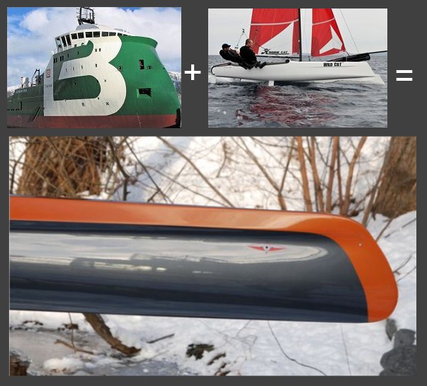

    I too am quite interested in the design and am wondering if it can be tweaked to be more swept back maybe at a 30 or even 60 degree kick back. I'm going to design a variation for a stand up paddleboard and go collect wave data in various conditions. Certainly they can plow through waves closing out and I'm wondering how sleekness would affect the cutting value and how much the top tongue chops in and at what level.

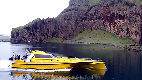

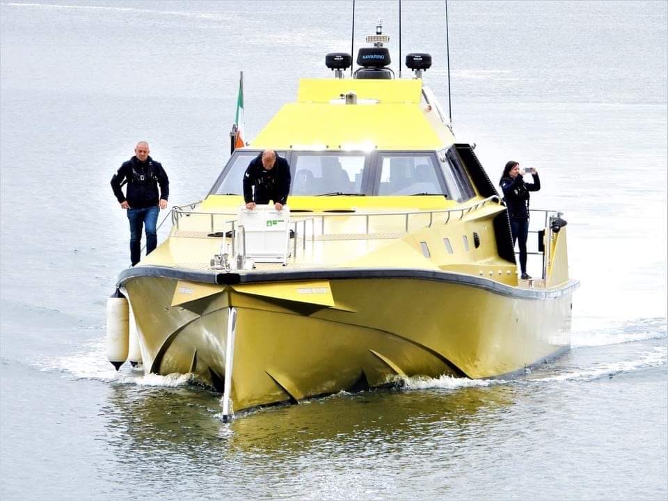

  6. John Rivers
    Joined: Oct 2022
    Posts: 93
    Likes: 5, Points: 8
    Location: Maryland
    John Rivers Junior Member

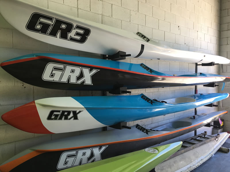

    Here are the style hulls I'm looking at that are half reversed, I guess,, spear bow,, with a wave ribbon.
  7. John Rivers
    Joined: Oct 2022
    Posts: 93
    Likes: 5, Points: 8
    Location: Maryland
    Magnus de Brito
    Notice the wave catch ribbon.
  8. jehardiman
    Joined: Aug 2004
    Posts: 3,990
    Likes: 1,341, Points: 113, Legacy Rep: 2040
    jehardiman Senior Member

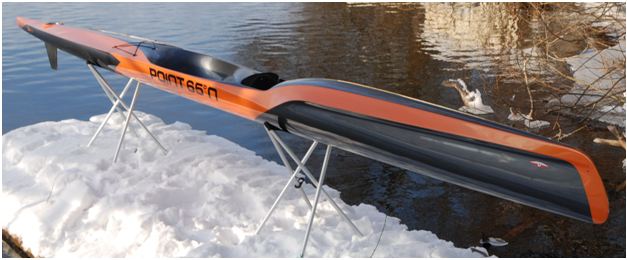

    <shrug> Those are different bows for different reasons. BTW, have you ever heard the word "baidarka"?

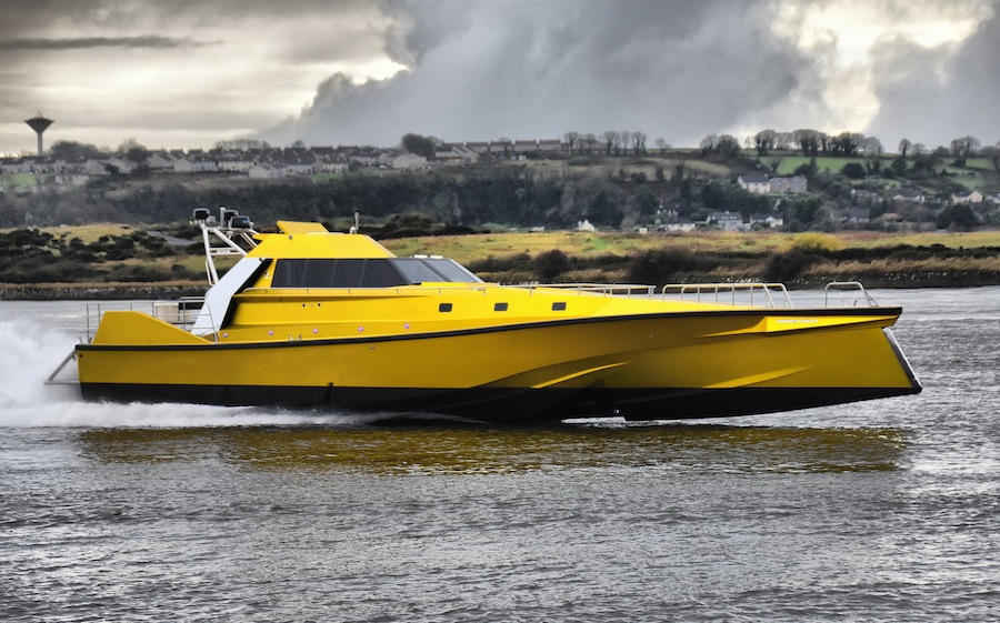

    My concept is similar to thunder child 2. Having a normal hull as a "chine"? Of the reverse bow, Preventing pitchpoling and building stepping ribbons or chines?. Technically this is an x bow. It seems if you are going to go reverse bow, you need to add about 10% to the length because it will dig. Main reason is greenwater ratio and people generally do not like getting wet or it creates function concerns. The average consumer also doesn't want a 20' kayak or and cannot transport them easily.

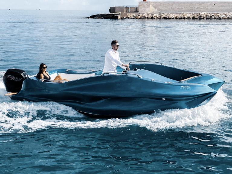

    This 3d printed hull is something of an x bow on the side that dampens wake and waves hitting the side of the boat.
