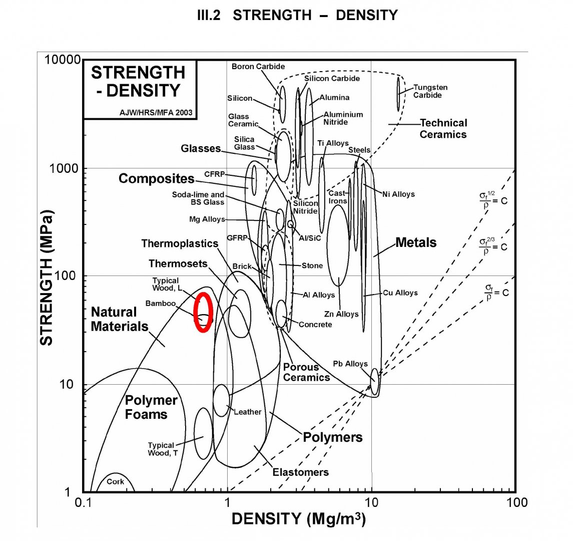

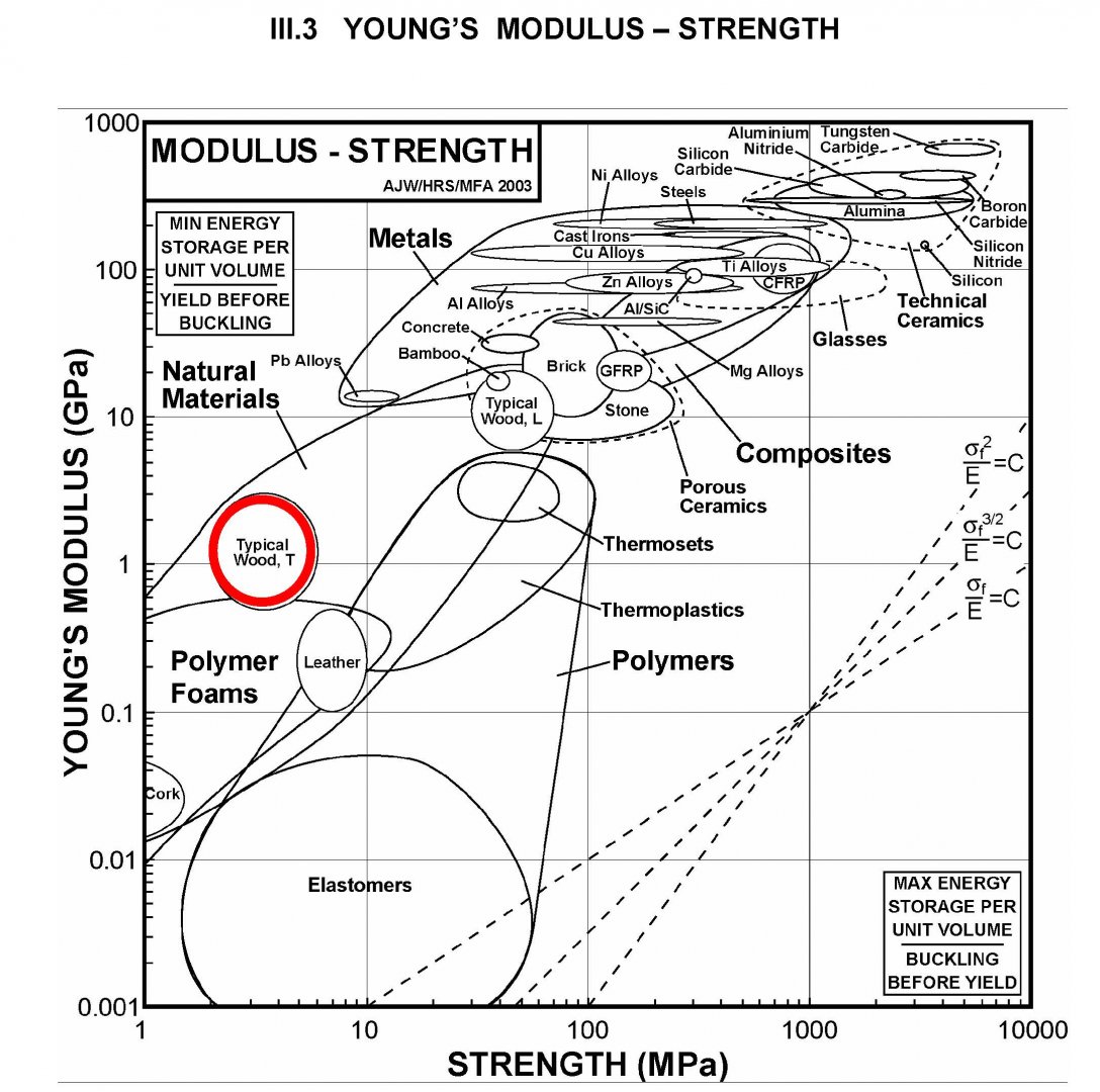

    I have now received my MT...i read the article differently. The author is mixing up values and I suspect as he has an agenda, a motive for doing so.
    He says "....the weight of shell plating per unit area is the density times the thickness, and the strength is yield strength times thickness squared. This favours materials of low density: a figure of merit is the square root of yield strength divided by density, with the highest figure indicating the "best" material....."
    A load that is applied to a panel/beam can easily be calculated as the stress = My/I or = M/z. Where z = modulus. The modulus of a panel of plating is simply bt2/6.
    So he is mixing this up by rearranging so that M, the bending moment = s.Z proptnl to s.t^2. (hmm..bummer, i thought this new website format would allow me to use Word and its symbols and cut n paste..but not..same as old one....crap!)
    So the bending moment is proportional to the yield strength x thickness squared. If the M remains the same, either the yield strength of the material or its thickness will influence how much M it can carry. It says nothing about the allowable deflection, and says even less about favouring a material of low density!
    Looking at proper charts of materials and placed in their correct order of properties, for minimum weight that gives a strength limited type of design parameter wood is very low down:
    And then looking at the amount of stored energy in a material, again wood low down:
    I’m not knocking wood (excuse the pun) at all…every material has its pros and cons and every design must be evaluated on its merits and SOR. Thus, no one material is better than any other, it is what’s best for THAT design.

  8. Ad Hoc
    Joined: Oct 2008
    Posts: 6,910
    Likes: 855, Points: 113, Legacy Rep: 2488
    Location: Japan
    Ad Hoc Naval Architect
    Which it is not, or shouldn't be for low modulus materials.....see one of my previous posts on the checks required.
    Structural design cannot be dumbed down into a one liner.
