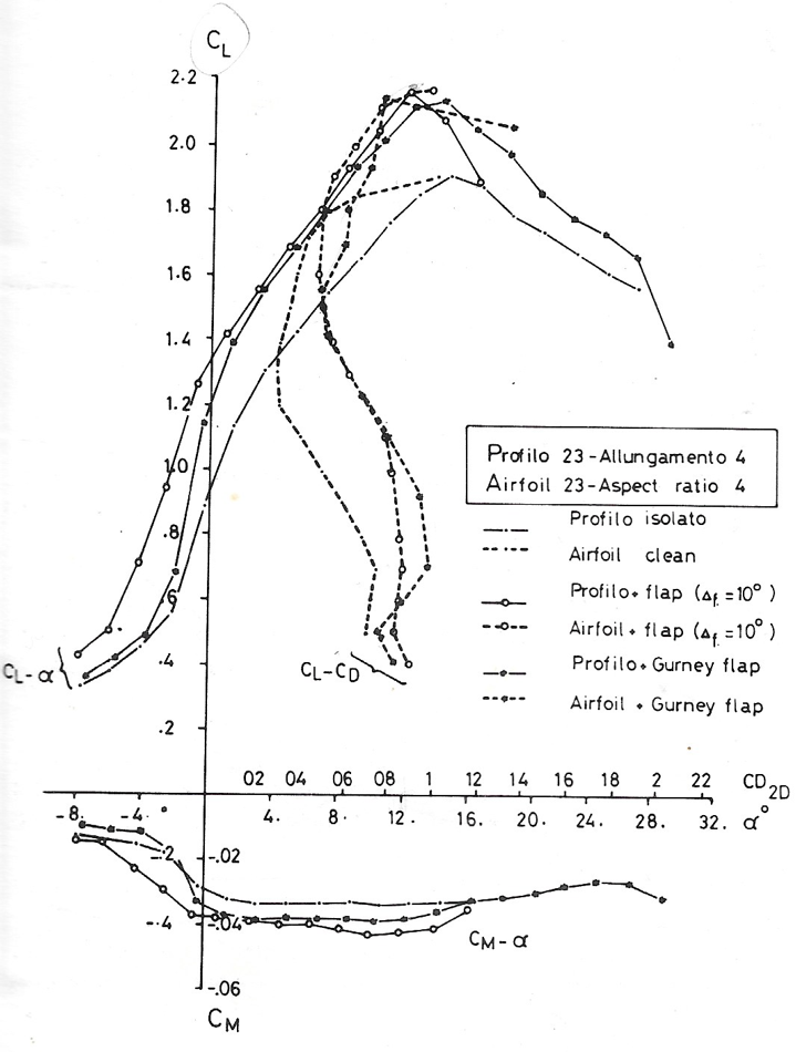

    In supplement, I've made, using the same tool of mine, a comparison of a rectangular wing sail and an elliptical wing sail, both of the same span and same area. The induce drag and the surface repartition in height are thus the only parameters that differs from the two configurations. I let you draw your own conclusions by yourself, but to me, one thing is clear :
    Due to the highest surface area on the top of the rectangular wing, its performance are not so far from an elliptical wing. If both are orientable, the maximum gain obtained by the elliptical configuration is about 5%, compared with the rectangular configuration. Not so important... Nevertheless, it is possible that this gain may become greater if configurations with higher aspect-ratios are studied. I will do this exercice in the next post.
    Looking forward hearing from you, I give you down-below the bulk results, in graphical form and attached csv.
    Cheers,
    PS : the legend of the latest graphic has wrong names. _wing12 is to be read _rectangular and _wing25 is to be read _elliptical.
