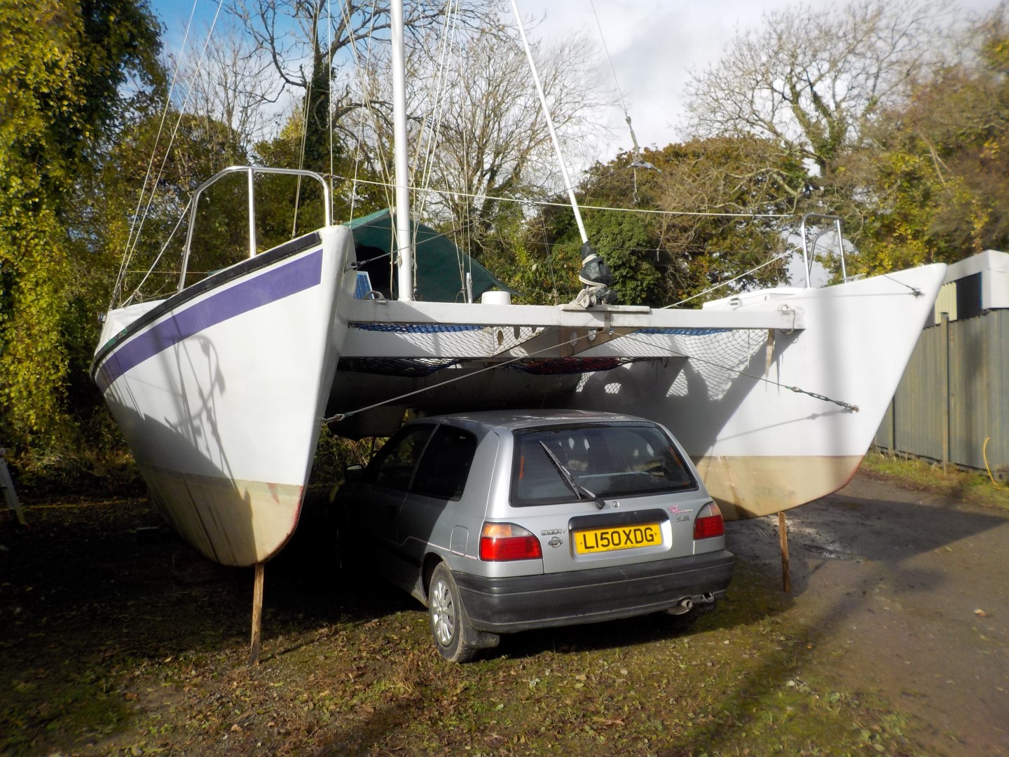

  7. Richard Woods
    Joined: Jun 2006
    Posts: 2,210
    Likes: 176, Points: 63, Legacy Rep: 1244
    Richard Woods Woods Designs
    It probably isn't a good idea to use pressure treated plywood and epoxy as it is likely that the epoxy will not bond properly. And there seems little point to it as coating with epoxy (2-3 coats) will be more watertight and also stiffen the plywood
    You would probably have to make your own grp flat panels, although there are companies that do it. My Windsong had solid glass hulls and ply decks. My Gypsy had foam sandwich hulls and ply decks. The foam hull is better and, taking the project as a whole, not much more expensive than solid glass
    Most people with a Windsong would use a high thrust outboard, 8-9.9hp. I only had a old 2 st 9.9 Evinrude on mine, however it only did 5mpg at 5 knots. A new 9.9 should do twice that.
    You may be overworrying about the durability of plywood. I think I posted these before, but here are photos I took in November of two plywood Windsongs. Both are over 30 years old. The grey one was built on a real budget, only WBP plywood, not 1088. It has crossed the Atlantic twice.

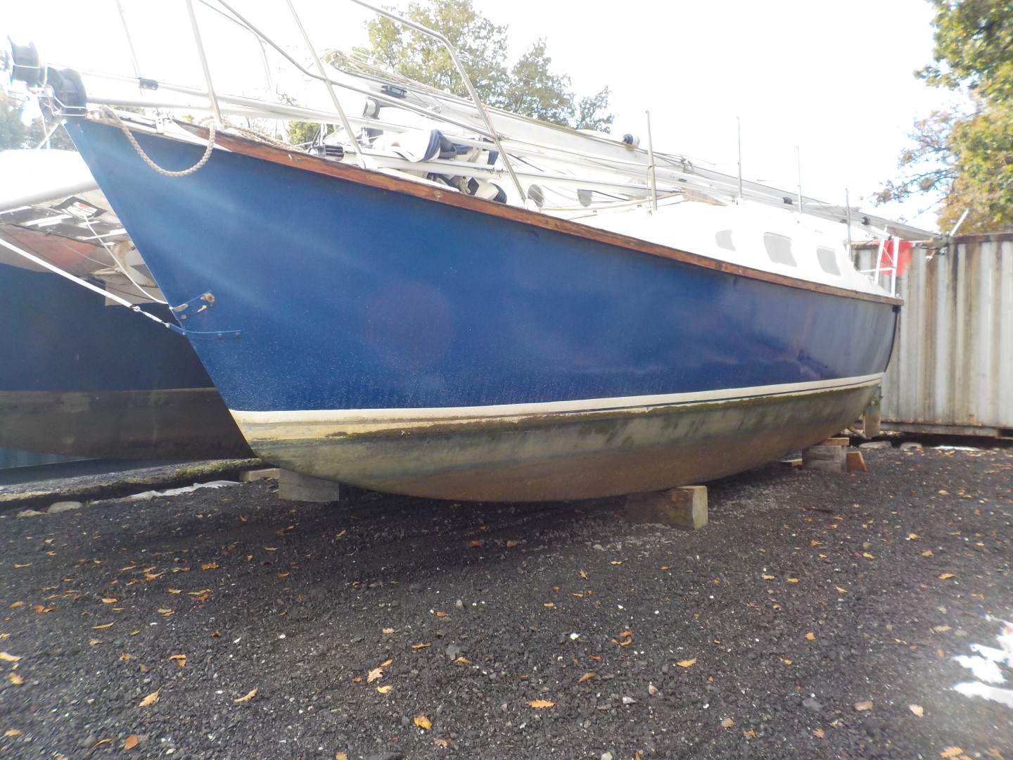

  15. valery gaulin
    Joined: Jan 2017
    Posts: 228
    Likes: 22, Points: 18, Legacy Rep: 7
    Location: Montréal
    valery gaulin Senior Member
    I already have a sailboat a 1973 Grampian 26 that i just renovated.
    My catamaran project is my next project so i am not in a hurry. I can enjoy sailing right now while I dream of my catamaran.
    The Catamaran you are showing look nice but is a little big for me trying to stay between 30-33 foot lenght with 16-17 foot beam.
    Talking at resale value, the one you are showing me is 107 000$, it seams that it barely pay for the material of the buitl!!! I am sure to build a catamran like this it is prbably around 200 000$ just in material!!!
    I still did not get a chance to finish pricing Windsong but a short answer is that it look very similar in pricing to Pahi 31 maybe just a little bit more but not much. Probably % difference in displacement is the % difference in cost!!! I
