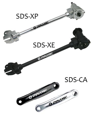

  4. philSweet
    Joined: May 2008
    Posts: 2,414
    philSweet Senior Member
    There have been several, though they tend to be pricey. The way to do this is not with conventional deraileur systems, but with sealed hub gears and crank gears connected by shafting. Or connected by a fixed chain if you prefer. Electric bikes are leading the way here. But most boaters aren't going to pay more for their bike than for their boat.
    http://ecruiserbikes.com/our-bikes/shaft-drive/
    http://glendalecycles.com/bike-technology/chainless-shaft-drive-bicycles/
    http://www.alexmeade.com/photos/styled-7/index.html(check out the tube coupler system)
    http://www.treehugger.com/bikes/chainless-shaft-drive-bicycle-transmissions-by-sussex.html
    no grease
    http://www.gatescarbondrive.com/
    http://www.bikewagon.com/fallbrook-...2SCSWofp9IixdhQInaf45RIwkZJn0M7BUQaAlqS8P8HAQ
