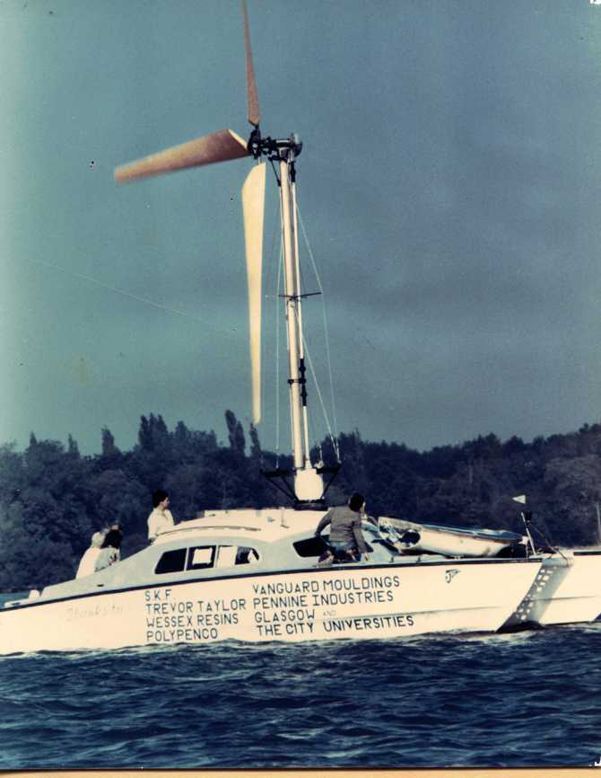

    Sure was, and by an irish boat a century earlier, although it is not known how well, or if, it went directly into the wind. Bates' boat was my inspiration to put a 9.4m/32' dia 3 bladed windmill on my 9m/30' Iroquois cat 30 years ago.
    Designed turbine rpm was 180 in 20 knots of breeze, when it should have done 13 knots directly into the wind. We were never brave enough to go more than 110 rpm, at which it managed 6 knots directly into 20 knots of breeze, which was way faster than the boats vmg under sail.
    It was no slouch reaching and running, either. In theory, with the water prop disengaged, it would have "sailed" (autogyro'ed) as well or better than it did under it's sail rig, but the fear of the forces overcoming the controls meant we never tried it.
    Interestingly, an autogyro rig was tried on a Redwing (od hull, any rig) in the 20's by the very clever and adventurous Lord Brabazon. It was apparently pretty quick, but at one stage they lost control and it hit some moored boats, and was banned. The blades (painted canvas over steel shafts) from this boat were in a house in Cowes when i was building mine.

    There you have it. Wind turbine powered boats sail directly to windward.
