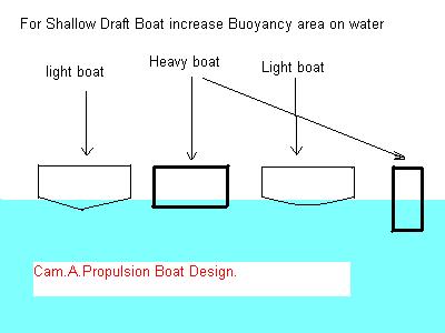

    There are a few more sentences that could be refined. The main objective should be to rework the paragraph that you misunderstood when you used the "what floats your boat" lesson to support your claim that a v bottom can have a shallower draft than a flat bottom based on the theory presented there. (assuming other factors equal)

    You are assuming that I said that a v bottom can have a SHALLOWER draft.
    A flat bottom boat does not mean that it is shallow draft as the solid block
    in Figure 1 shows. (not assuming other factors equal.
    If the solid cube of wood in Figure 1 were stretched out into a plank that was eight feet long, nine inches wide and 2 inches high,it would have the same weight and volume as the cube,but it would float nicely right at the surface of the water. This is because the plank would have six square feet of area for the water pressure to push against instead of only one square foot the block has.
    Notice that the plank and the block have flat surfaces.
    To decrease the draft of a boat increase the area that the water has to press against.

    Some of us here are naval architects, or perhaps engineers of other persuasions. cmckesson is a step beyond that, he teaches naval architecture.
    A V bottom cannot have a draft shallower nor as shallow as a flat bottom (constant mass and max beam).
    And if you convert it to a V bottom, with the same mass, its draft will be even greater.
    And when you convert flat to V (same mass), you increase the surface area, but you also angle that area away from horizontal. The total buoyancy force pushing straight up doesn't increase.
