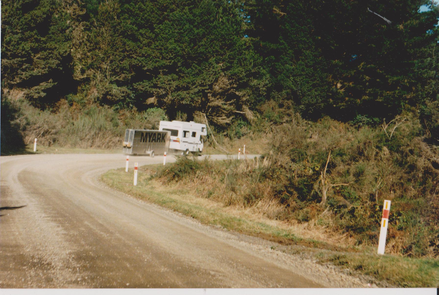

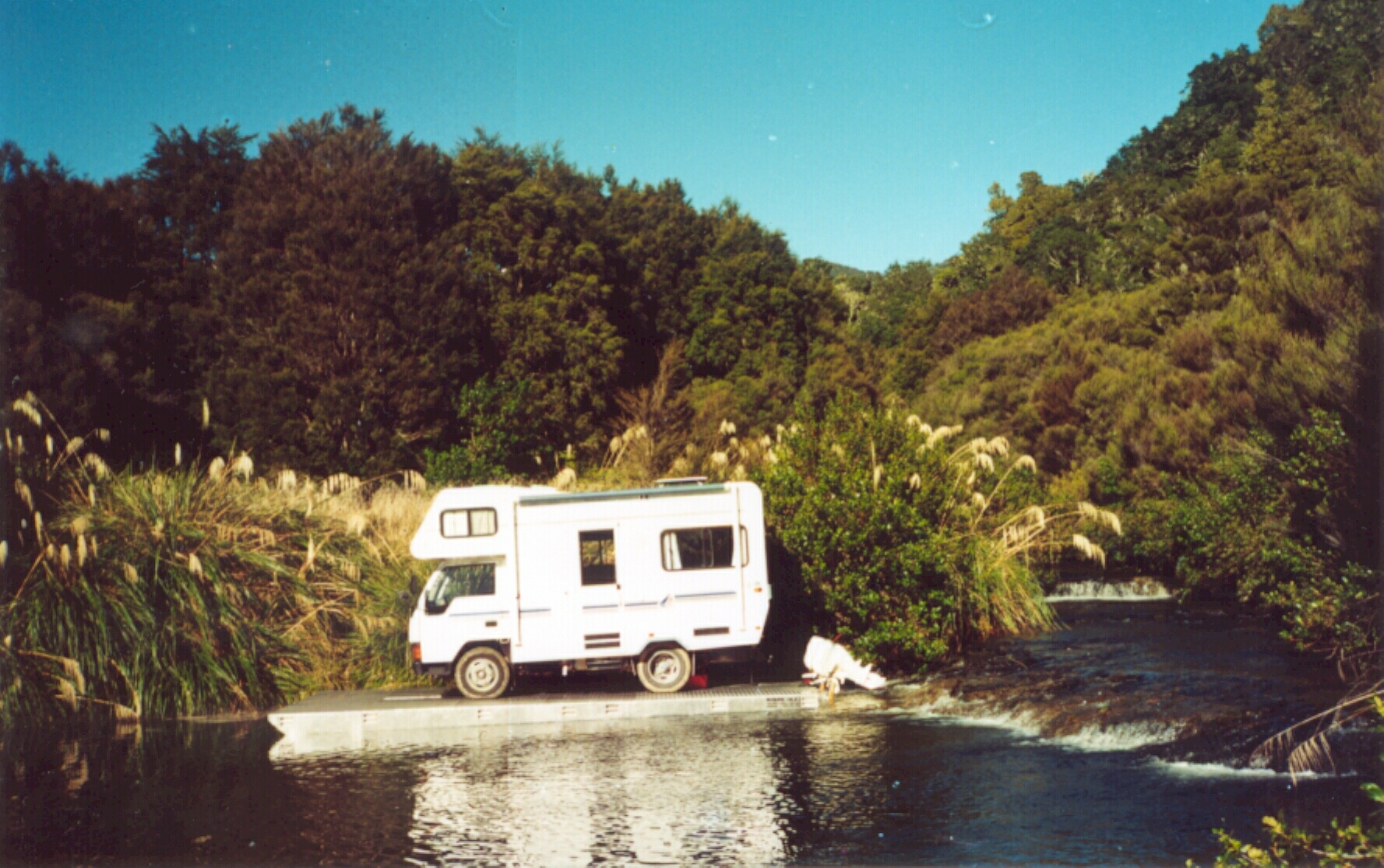

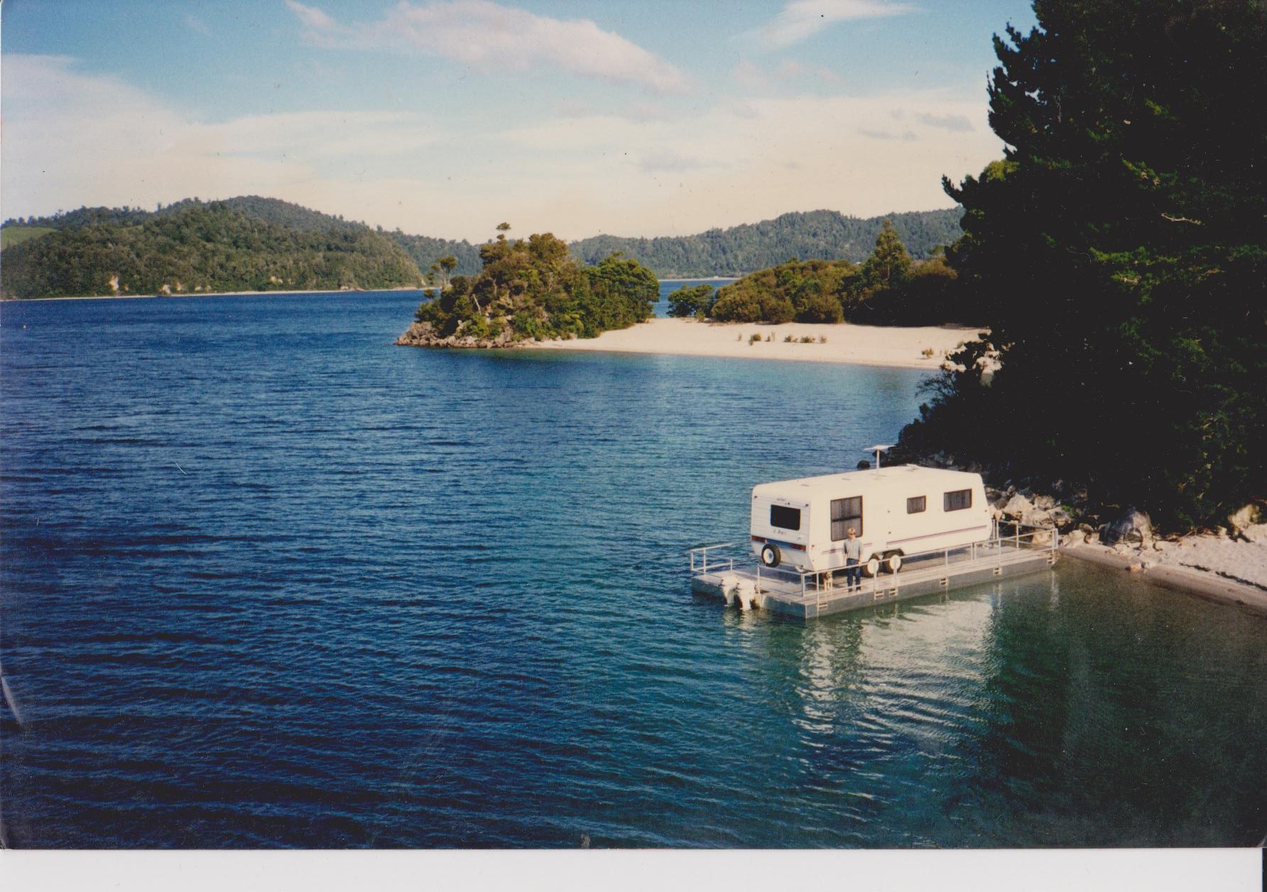

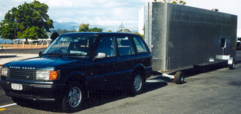

  6. myark
    Joined: Oct 2012
    Posts: 690
    Location: Thailand
    myark Senior Member
    One of my designs may be suited for this customer but not exactly as the customer wants, how ever if he knows more it gives more choice of options he can choose or combine.
    The smaller Myark folding trailer barges that are 2.4 X wide when unfolded in pontoon shape, when structures are folded its 1. wide X .900 high X 4.800 long and weighs 350kg including the built in trailer system.
    It has a simple tent structure stored in hulls with other camping accessories, also you can drive a smaller camper van on top.
    It does 20 knots with a 15hp out board when van or car is driven off, say on a remote island, lake or river edge, the tent structure not only fits on the pontoon, but tent also can be assembled on land when not on pontoon.
    It opens and shuts like a garage door and the wheels automatically rise out of the water when unfolded.
    The tandem suspension and wheels can be removed and placed in each corner to act as torsions bumper bars.
    To keep the weight down in trailer mode the torsions suspension are made from aluminium casings and titanium torsion bar, arm, axles, hubs and stubs with the bearings made from 440c stainless that have a hardness of 60 HRC.
    The bearings have a grease system that keeps the water out and are far superior than bearing buddies.
    I understand the customer does not want the wheels to touch the water which there are ways, but if the water has no affect on parts then that is not an issue.
    The pontoon tows opened or shut meaning when not used as a boat it can be used as a 2.4 X 4.8 tandem trailer.
    If limited room in garage, say a one car park only garage space, the pontoon then can be unfolding, then the car can drive on top allowing the car and the pontoon to store in a one car space parking area.
    This also allows room to work under the car if need change oil of fix exhaust etc.
    The cost of this type of product would be about $10.000 including out board motor and self trailering system when in mass production.
    This can suit hire out company that can store in minimum space, when transporting they can place two more Myark folding trailer barges on top so they can tow three pontoons at a time to make transporting to remote paradises financially viable..
    Another market could be when future floods caused by global warming or the certain sea rise in the near future.
    The sizes go smaller or very large, also Myark folding trailer barges they can be launched and retrieved in any remote area that has no public boat ramps like most boats need.
    This may not suit your customer because the idea may be to advanced for his thinking but it does no harm to suggest for some one who is researching ideas.
