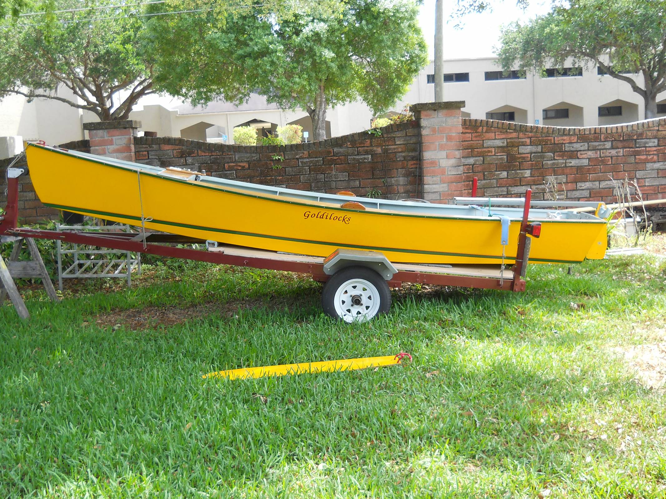

    messabout Senior Member
    Tom; what the customer wants is not what he needs if it is to satisfy the requirements that he has set forth.
    Minimum draft: No dead rise! It will be flat bottomed whether his perception of correctness is correct or not. It is not
    Easy to load and unload from the trailer: The boat will be as light in weight as is reasonable. It will have a flat bottom. Flattiess are distinctly easier to load and unload, that sort of boat will sit lower on the trailer than a vee bottomed boat, thus it is nearer the water when loading or unloading.
    Trailer; A flat piece of ply or other material is fine. The boat will live there nicely. The trailer can be used for utility purposes with its flat deck. The trailer will not need chocks or bunks to hold a vee bottom in its place, so there is no obstructions when the trailer is used for utility purposes. My trailer has that exact layout. The flat deck of the trailer has carpet across its top surface. That makes the boat easy to slide on and off the trailer.
    Here is a crude picture of my 16 foot flattie on just such a trailer. The trailer does not even have a winch. It does not need one. The boat unloads, as you say, with a gentle push off the back of the trailer. Loading/unloading without getting the axle and bearings wet is possible on some ramps but not all of them. Depends on the angle of the ramp. I do not see routine bearing maintenance as a serious liability, so I do not hesitate to let them get wet. Actually they do not endure much if any damage because the bearing seals do what they are intended to do.
    The boat in the picture, with me, the tiny motor, and all the contents weighs 325 pounds all up. It goes well with a little 2.3 HP Mercury outboard. (I think it is probably a re-branded Tohatsu) It can and does, plane with that wee little motor. Twelve MPH when the motor is revved up. If the boat had a vee bottom it would not do that. At idle throttle settings the boat moves at about 4 MPH.
