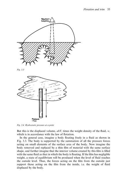

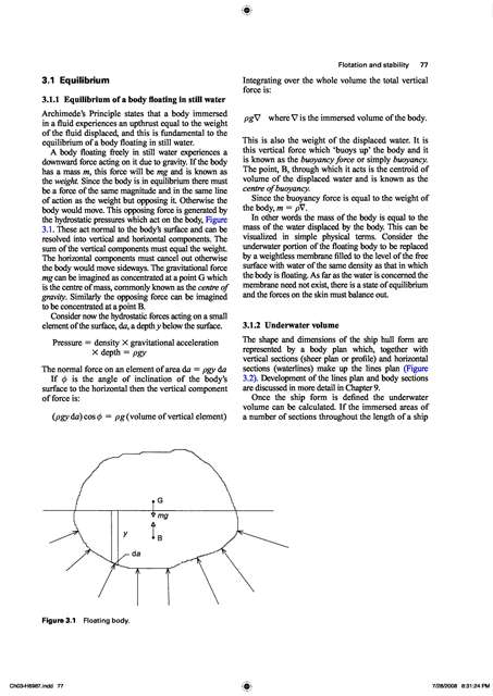

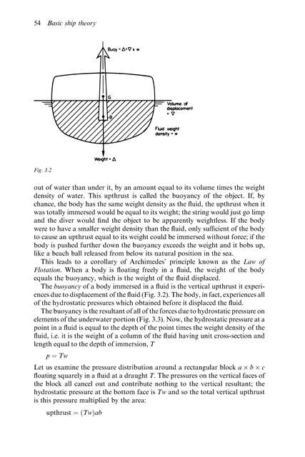

    To save you those millions...here is an excerpt from basic ship theory on this very subject. Now you can lift the vail of ignorance....for free :)
    Basic Ship Theory VOLUME1_Page_1.jpg Basic Ship Theory VOLUME1_Page_2.jpg Basic Ship Theory VOLUME1_Page_3.jpg Basic Ship Theory VOLUME1_Page_4.jpg
    Not happy with those, try this one too:

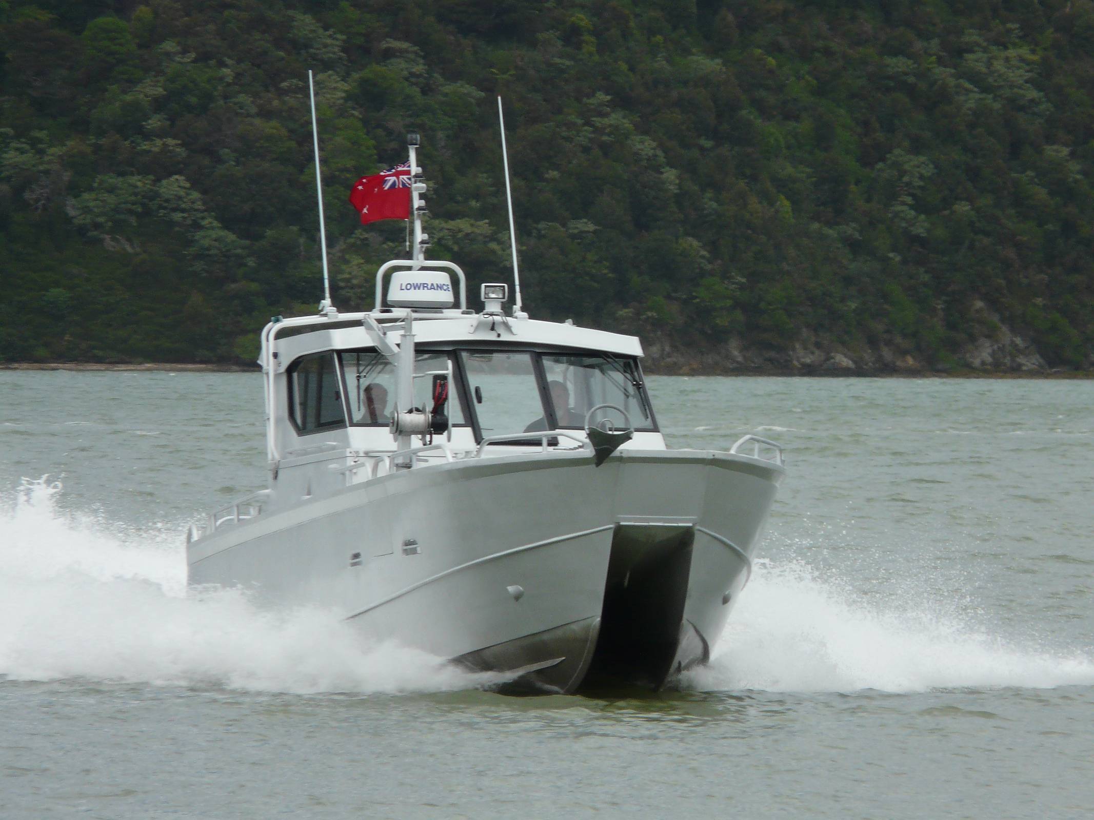

    But look at the plane angle, that would not be shallow draft but is a lot bigger than our customer needs.
