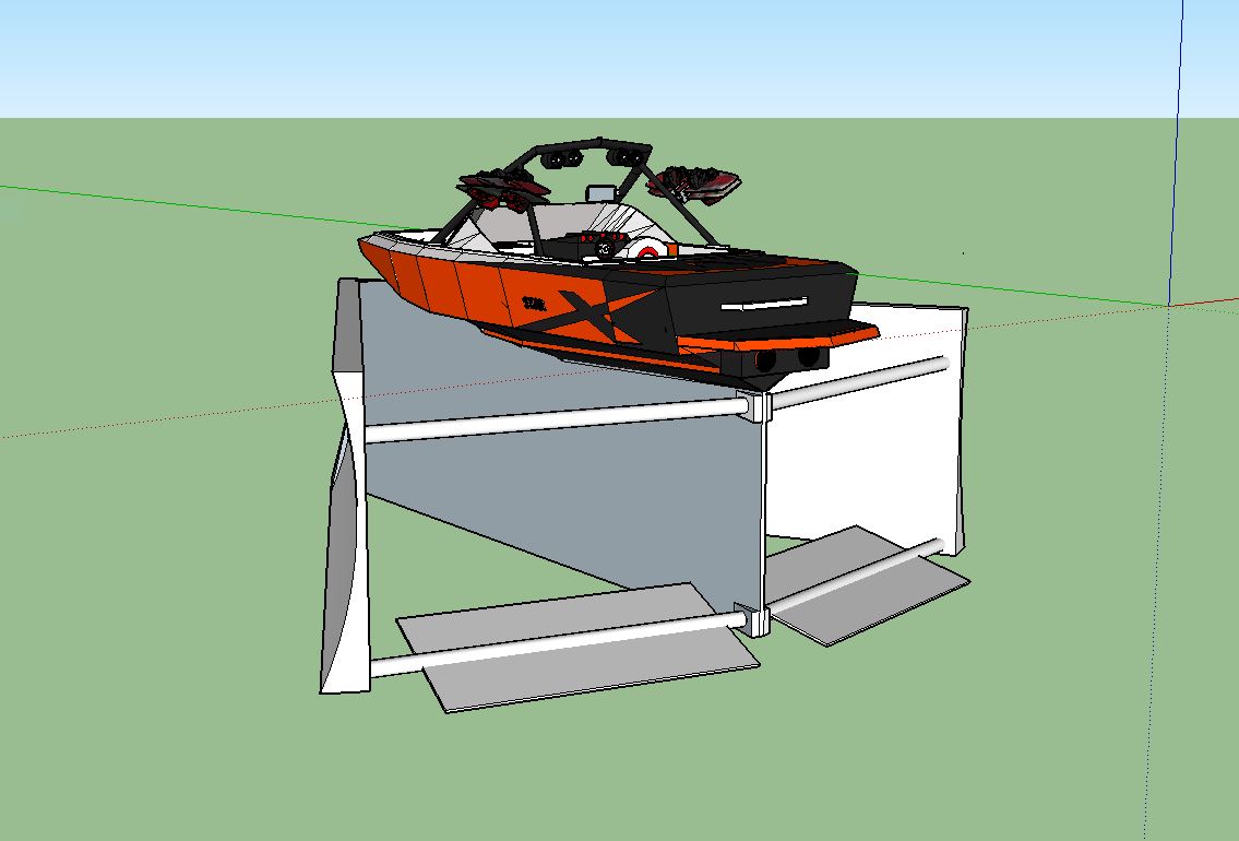

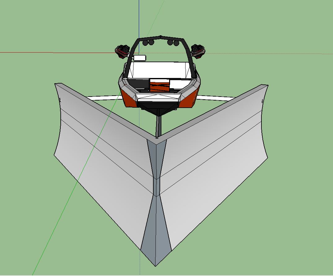

    Here is a quick drawing I made on sketchup. Keep in mind the foils are not optimized in any way, it is for visual reference only. If a powerboat could generate enough power, I envision 4 components and the supports. The middle spline and to sides could fold in half horizontally to make them easy to transport. The forth piece, not pictured here, would be a mould of the underside of the boat which the three other pieces would attach to. All made out of carbon fiber. They would be assembled then attached to the underside of the boat via tie down points.
    Now I know there are a lot of logistical problems here, it's just a starting point. I plan on making a 1:10 scale of a similar design to attach to an RC boat. I plan on using balsa wood and Apoxie Sculpt to make it. Hopefully it will generate a 4" - 7" breaking wave, if I can find a friendly shoreline. I might just make an artificial rock reef if not.
    Any wagers?

    The snow-plough arrangement makes the waves ? You will need considerably more forward speed than your desired wave speed, looking at that.

  9. daiquiri
    Joined: May 2004
    Posts: 5,371
    Likes: 258, Points: 93, Legacy Rep: 3380
    rwar,
    the problem with your solution, and with other similar solutions which use symmetrical hulls, is that you obtain a symmetrical wave train. But only one half of the generated waves will reach the shore and be used. So you have wasted 50% of the wave energy right at the start. That's costly, inefficient and the unused waves on the opposite side of the vessel can create troubles on the other shore (if there is one), or to other vessels or swimmers around.
    IMO, you should explore the possibility to use a catamaran boat with hulls arranged in a so-called Weinblum configuration, which is visible here: http://www.cyberiad.net/wakeweinblum.htm
    The picture shows the effect of this configuration, which creates an augmented wave-train on one side of the boat, and almost zero waves on the opposite side. This allows you to use the available power in a more focused and efficient way.
    While it is true that such neat wave distribution is attainable only for slender hulls, I am pretty sure that other hull types can be arranged in such way to exploit, at least partially, the said effect. The closer you get to the Weinblum wave distribution, the better for your purpose. It will require a good deal of engineering and a lots of testing, of course.
    By the way, the calculations of the wake field visible in that picture in the Cyberiad site were done by a member of this forum, Leo Lazauskas (http://www.boatdesign.net/forums/profile/leo-lazauskas.html), who can certainly tell you more about the feasibility of this idea.
    I agree with those who say that you need a heavy displacement boat for the generation of waves of desired height. A water-ballast system might be a good idea if there is a need to create waves of varying height. Filling and emptying the ballast tanks would allow you to vary the displacement of the boat, and to generate wave trains of different height for a given speed.
    Cheers
